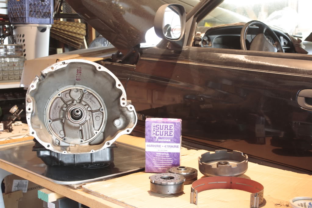

Originally Posted by ekaplan
Thanks I'll definitely look into all this. The only issue I have, which prob isn't an issue, is the quick shift into overdrive. Seems like its too soon but I was hoping it was the 35" tires throwing it off. Read you should have 4.56 or somethin like that with those tires. I have the stock 4.10 since its offroad sport.
The Sonnax Sure Cure Kit, governor, and pressure sensor will resolve any shift issues. (purple box)
