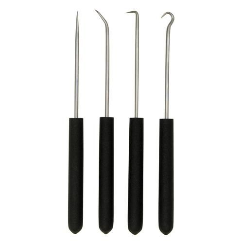

I agree with this. Biggest factor is your head/eye angle on the rotor tip to the mark. This reminds me of an important tool.
Booger pickers?
scribes?
