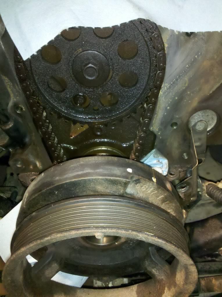

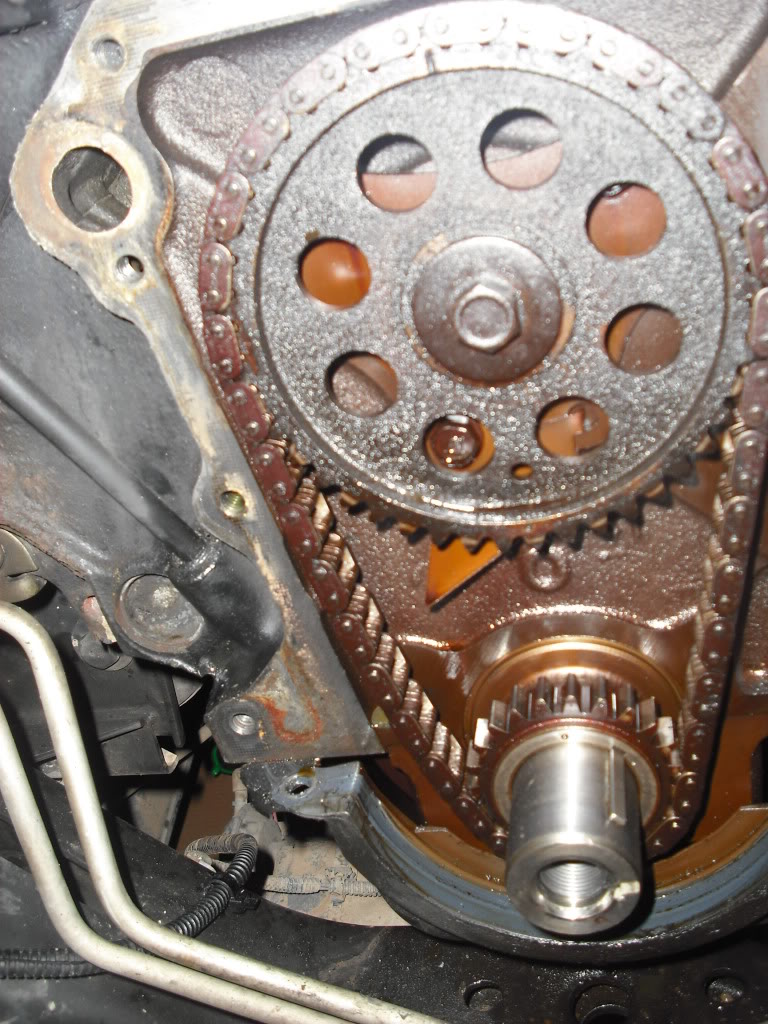

Originally Posted by Wh1t3NuKle
Here are some pictures. In addition, on the cap #1 is marked.
Yellow box denotes the TDC 1 mark.
Timing Cover -- Use the h/b cut mark to point. You'll see graduation marks.
Adding to the above pictures for completeness so you can see what the infamous "dots" of timing hell look like.
Notice the marks on the H/B. The cut line is timing mark. The 2nd dot to the left, ignore that.
