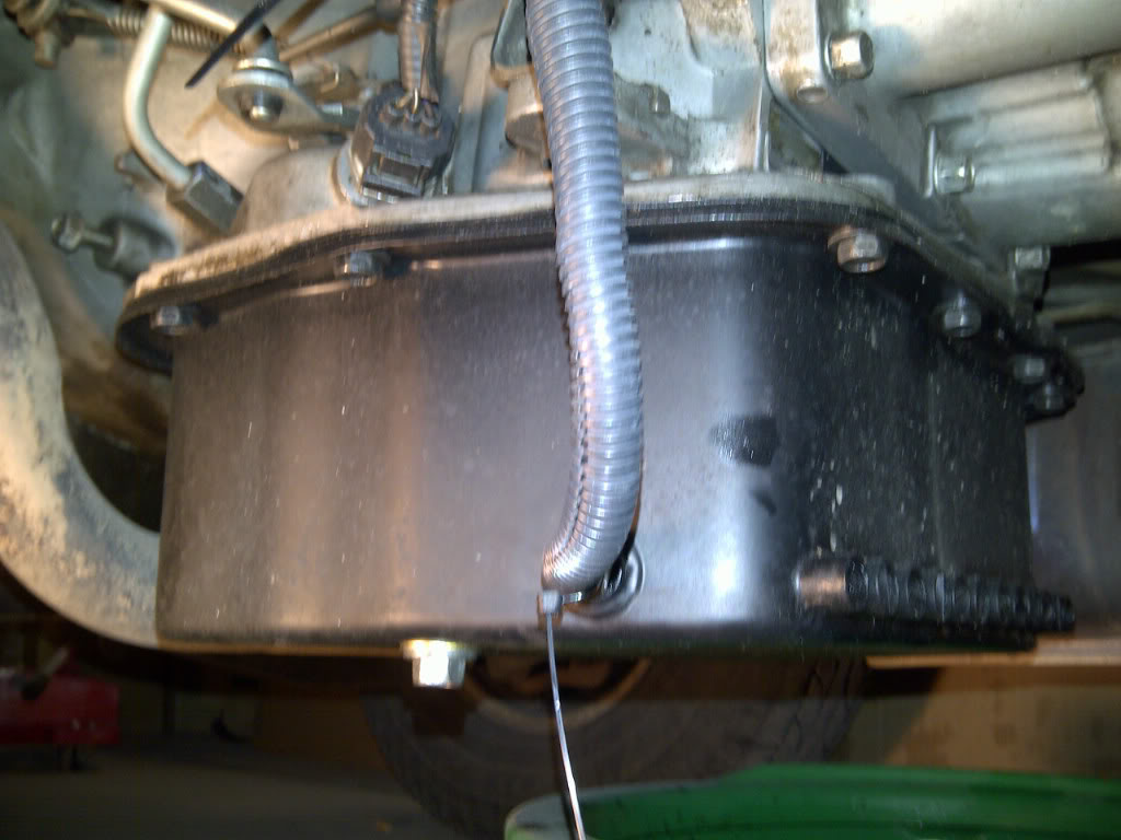

That should work also. Used to do that on equipment we were field testing (cranes and such). Usually used JB weld.
Or you could do what I did ...... thread one into a Derale tranny pan
