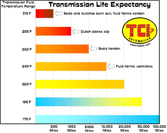

I've seen that chart before but it doesn't mention under 175*. I know the Earl's cooler in my car has some sort of thermostat that bypasses fluid when it's below 180*.
