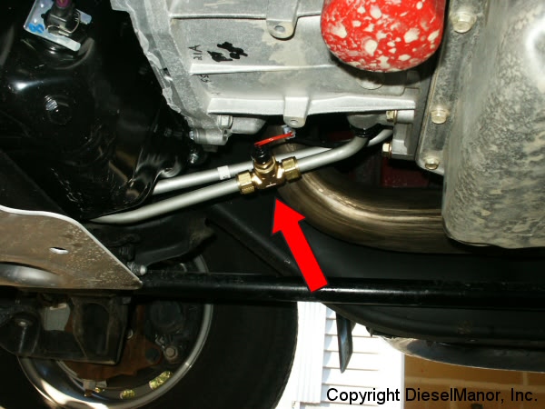

Also gotta remember that the fluid in the pan gets there AFTER running thru the various trans coolers.
Old Jan 21, 2012 | 10:39 AM
zman17's Avatar
zman17
Retired Moderator - RIP
Posts: 18,729
Likes: 17
From: NH
+1, the pan is not the ideal spot for the sending unit. The best place is in the line coming out of the tranny.

thanks for the input! ill put my sender in the line and put the drain plug back in the pan.
