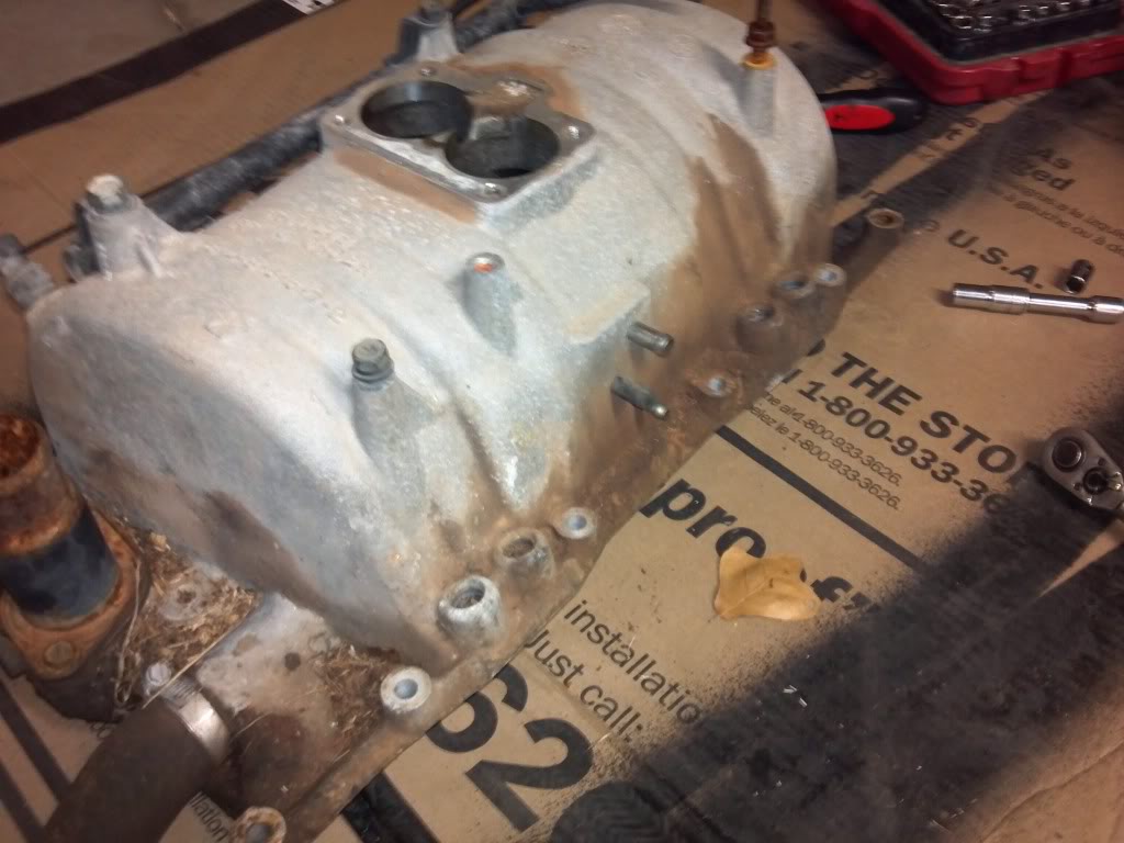

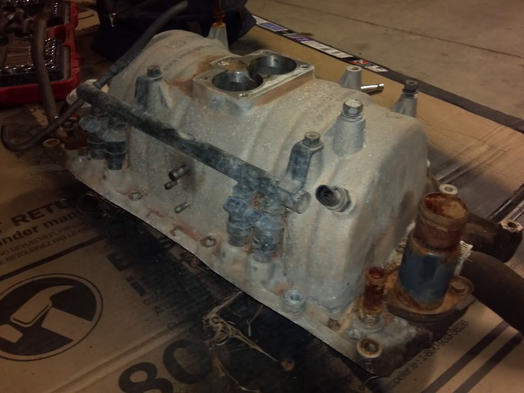

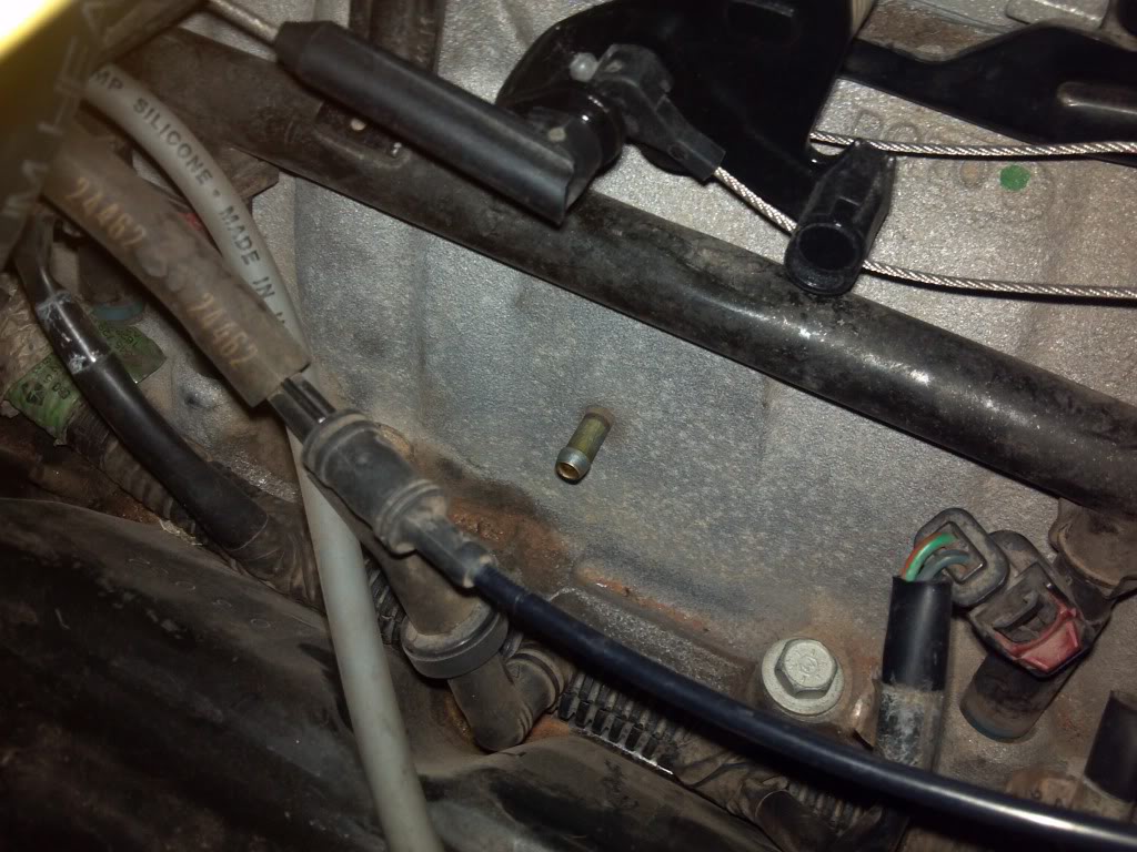

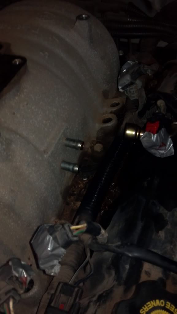

Few questions about it... I have an extra intake laying around and want to cut the runners and use it. Thing is I have an 01 but the intake is off a 95. I know I have to cut the plate in the middle and plug the egr valve. How do I plug the egr valve? Also there are some extra ports on the 95 intake. Refer to the pics below. There are three ports on each side on the 95 intake which Im guessing are for vacuum, and only 2 on the drivers side and 1 on the passenger side on the 01 intake. What do I need to do about those?
Thanks in advance
Heres the pics
95 intake
Drivers side

Passenger side
01 intake
Drivers side
Passenger side

Just put an EGR block off plate where the EGR valve would mount, and that will take care of that.
As for the ports, just put caps on the ones you don't need to use. Parts store will have 'em. Also, you will have an extra hole for temp sensor. Plug that too. (pipe plug. get one at the hardware store.)
