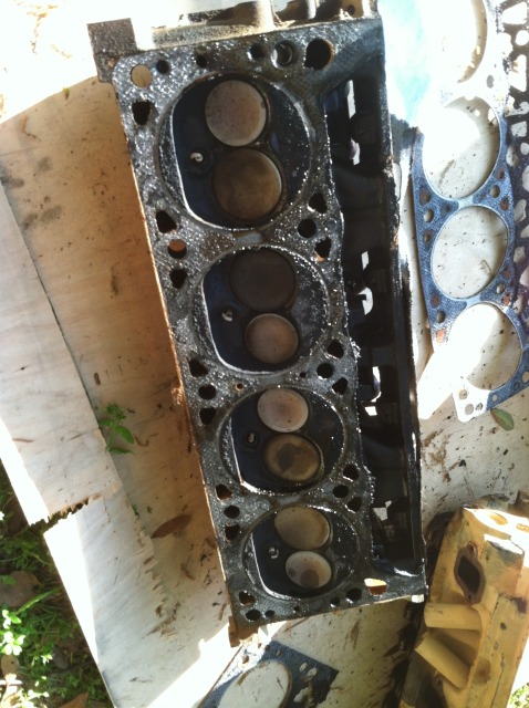

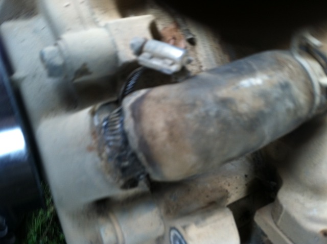

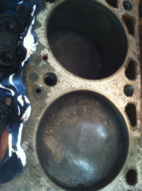

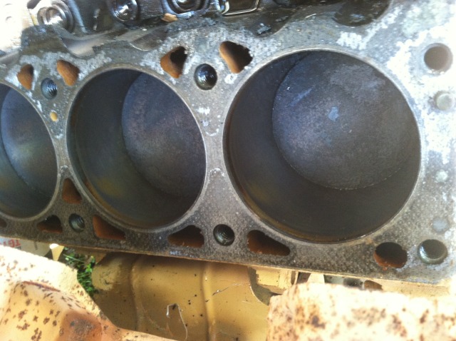

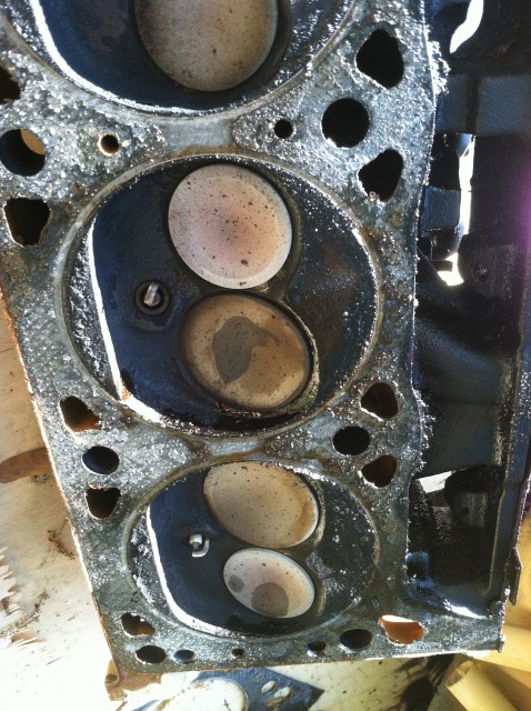

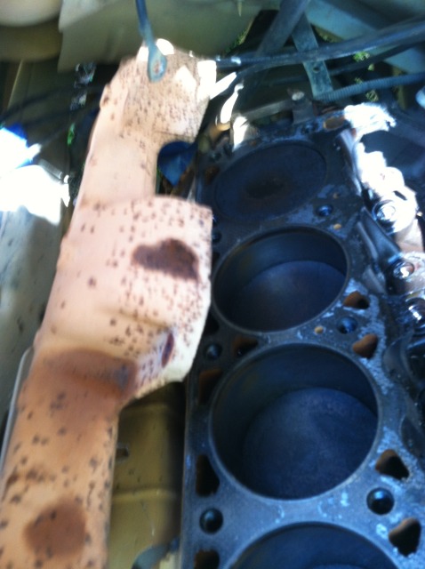

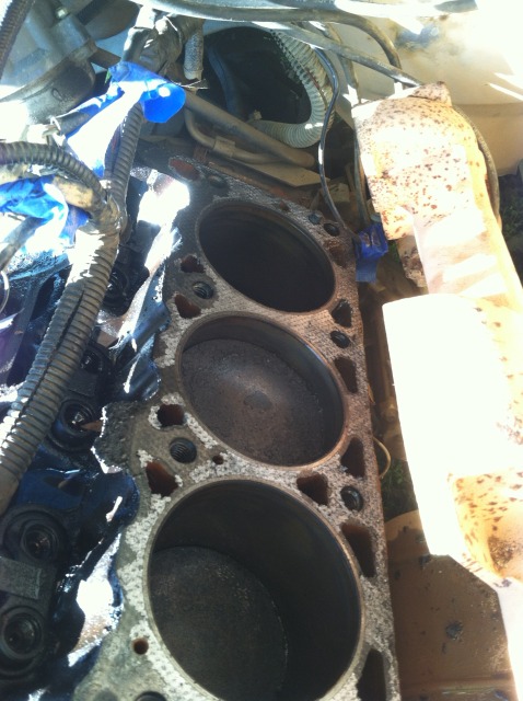

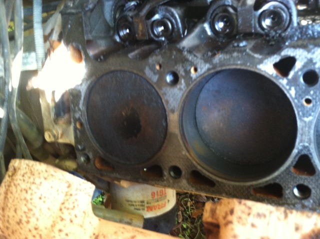

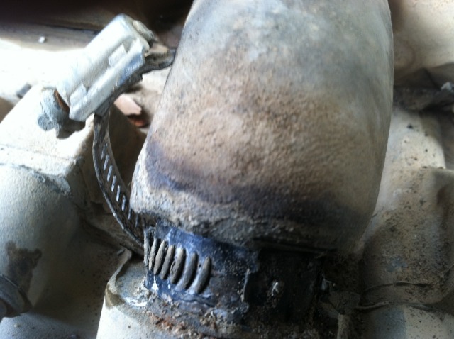

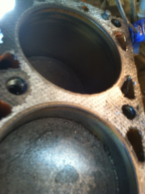

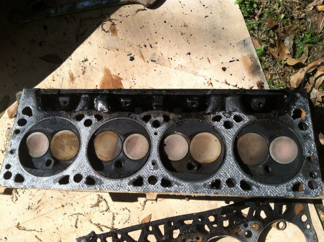

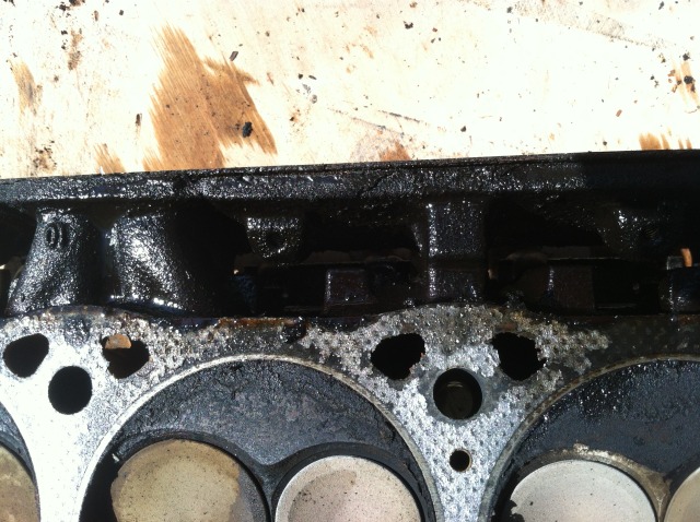

Well I have the heads off. I couldn't tell if the head gaskets were bad or leaked but a friend of mine who does works on cars did have a look at the motor before I got the heads off and say he thinks it will be the gaskets from what he looked at as well the oil. I found a place here that will check them for $25.00 and $50 for checking everything. He said they ok, he will re work them for a total of $200 bucks. thats with everything from the checking to re work. He said as I told him about the heads in Alabama that he can do it for the same price and I would know all that be put into it. So if this works out for me and I dont need them. let me know if you do and I will pass forward his name and number to contact him. crossing fingers. I have some pictures. beware, they look nasty.lol.
I found Im sure is one of the leaks too.

The head with the piece of blue tape the driver side which had same compression all the way across. the other head is my passenger side that had the #8 cylinder that was only 50 and the rest was 120. I hope these pictures help out you guys. As you can see the number #8 had a tiny bit of build up and was a little blacker but it was very thin and cleaned right up. I'm thinking that was from it not firing correctly. all my plugs were like normal except that one but it was obvious it wasn't firing correctly. My friend I told you about rebuilds his own motors and machines so he got to look at it.
I spoke with the guy and he said he bought the heads and replaced the one piston ( used) that had the low compression and ran it down the road and did a compression check and it was still low. he thought maybe the wall was scored so he just put another motor in it.
From what it reads. yes for both. he had them a couple times on Craigslist with no bites and he hates that he loosing money but he doesn't need them anymore. Thats what I was told GDStock.
