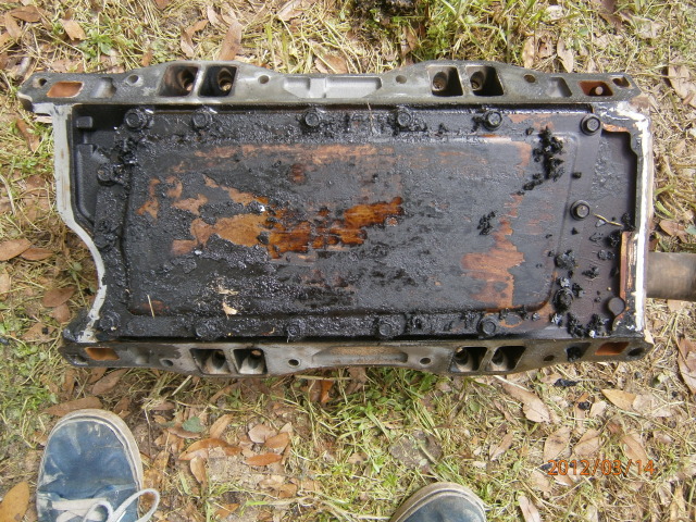

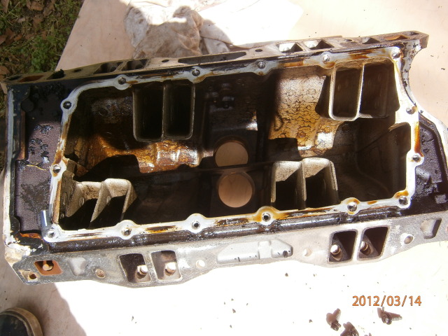

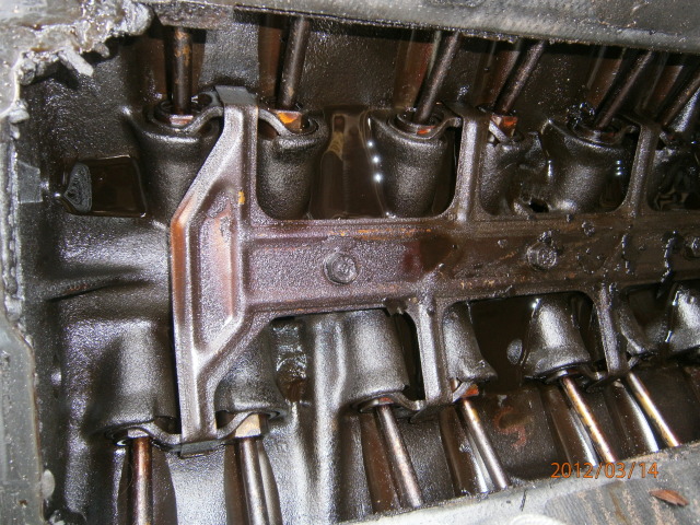

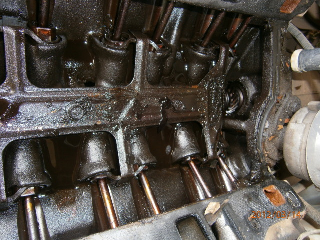

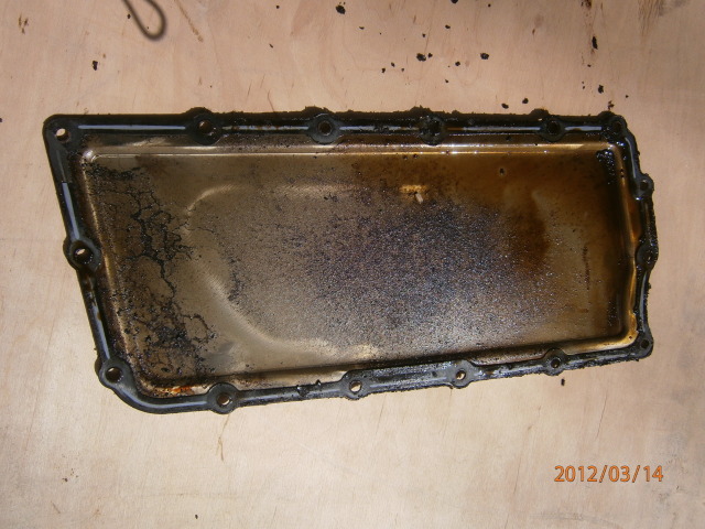

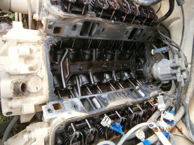

I am posting pictures in hope you guys may have some input. I haven't found any water in the system so far but I did notice the hose off the water pump to the intake looked real bad. replacing with new one. I broke one vacuum line that I will need to find where and fix that. I know I am going to spell this wrong but I think you will know what I mean. inside of intake was pretty clean and plune looked good. Going to pressure was intake clean. here some more pictures. What you guys think? Other a little cruddy. not as bad I as expected.

Old Mar 14, 2012 | 04:48 PM
  #43
Posts: 87,549
Likes: 4,230
Yeah, yours was blown, but, not real bad. (plenum) Can see some oil pooling in there.
Motor really doesn't look that bad considering the mileage.
Old Mar 14, 2012 | 06:54 PM
  #44
snookhooked's Avatar
snookhooked
Joined: Dec 2011
Posts: 110
From: Pensacola Fl
Thanks Hey You. Being this is my first time. It helps showing pictures of what I am looking at rather than me trying to explain. The pooling of oil isnt good then. Wasn't for sure but I was shocked that both the valves and in take was clear of water. The throttle body was a little nasty but I am going to clean everything up as good as I can. not in any rush here. I know this may be a crazy question but should I remove the rocker arms and tear down the head completely for the change or just remove the heads themselves and clean them up real good for the gasket change? I mean once I get the head off and see what the gasket looks like so that maybe it will tell me why the low compression in only the one cylinder. I didn't run the truck very long or even very much when the problem started. I am trying to keep the cost as down as possible but if I have to, I will replace the heads at this point. I thought having you see what I see may help you determine from what most likely needs to be looked into.
Thanks for all the help.......
Old Mar 14, 2012 | 07:16 PM
  #45
Posts: 87,549
Likes: 4,230
You can just break the rockers loose enough so that you can pull the pushrods. Make REAL sure you keep track of what order they go in, it's important.. if you actually remove the rockers, order is important there as well. Gotta keep all those wear parts matched together.
I think matt nailed it back in post number four though... burnt valve. Could also be cracked heads..... rarely have I seen a gasket failure on one of these engines...... might just as well prepare yourself to purchase a new set of heads...... I wouldn't bother spending any money on the stockers. They have such a lousy reputation, it just ain't worth it.
