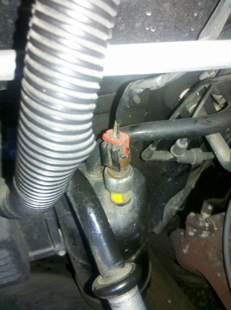

So this one right?The parts store wanted to know if it was the oval or circle one.From what I could see it looked round...so that's what I orderd.Will have today.

&how the hell does that thing come out just unscrew or ac quick disconnect

I think it unscrews, but I am not sure. The ones I have changed did, but I have not changed on on these. Looking at the new one shoulld reveal the secret!

That's the feller, and yep, he just unscrews.

tiok itAnybody else have any ideas...it wasn't the switch&took it to.my dads&he hooked his gauges up again&its full

Check and see if you are getting voltage on the brown wire after the low pressure switch.
