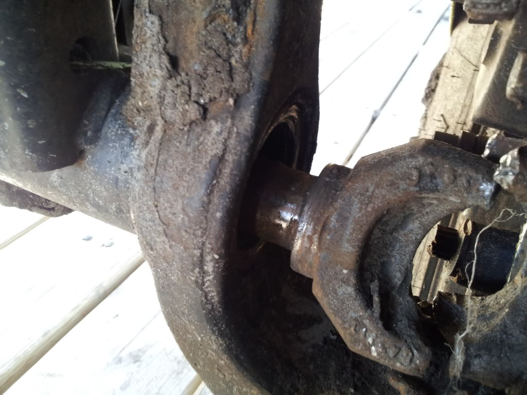

I am trying to figure out why my driver side axel keeps snapping...and it seems there should be some sort of a spacer/seal that goes behind it and the axel tube. cause when i install it there is some space behing it and it keeps pulling itself into the tube breaking the u joint hoops.

There is a dust seal/cover that goes in the tube. I have seen front diffs both with and without it. But it will not cause you to snap an axle like that. My front diff does not have the covers. Most likely the cause is a bad or weak u-joint or large tires.

yeah i have 37's but it snaps within 5 minutes of me going in 4wd and hitting soft mud... i would like to at least get a weekend out of it

+1, That is just a dust seal. As far as I know, the axle should not go in or out if the hub bearing is torqued correctly.

The large tires and your 408 are what's causing them to snap

the 408 is not in yet lol....its still sitting in the garage waiting on me to get this all set up correctly....or just buy a set of 1 tons or rockwells whichever i can find first

thats what i thought but everytime it breaks it breaks the back side of the hoop and is not like the snap occured on forward mometum...it just seems odd. I could possibly have bent my whole axel houseing when i did all the damage the first time
At least D60 time.

Once installed, there shouldn't be ANY lateral play in the axle. The outer stub should hold everything in place. If there is movement there, something is definitely wrong. If the u-joint pivot point, and the balljoint pivot point, are not DIRECTLY in line, yeah, things are gonna bust.
Something else to check...... is make sure the passenger side inner axle isn't seized up in the tube...... if that were the case, as soon as you put it in 4wd, it would be trying to spin the drivers side twice as fast...... and that will also bust stuff up right quick.

u know i didnt think about the inner passenger axel...but i do have a little bit of a hard time getting it to lock the front end i have removed the vacumme acctuated cad... and installed the cable acctuated one but it has never seemed to work right. i will look into that tonight thanks heyyou
