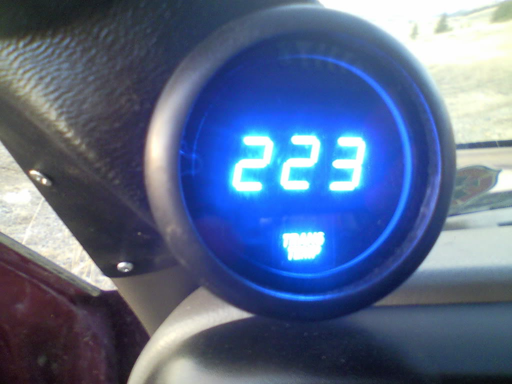

Yup here she is ! Drove around all day and avg was around 140-160 city/hwy. I decided to also do a test and hook my 4500lb boat up and back up my 1/2mile long STEEP driveway. Was fairly muddy and was slipping in 4wd(even with the spool lol).. stopped at 223*F and let it idle in N so i didnt burn it up. WAY glad i got the gauge... Hit 170 a few times idling around parking lots and stuff as well(empty).

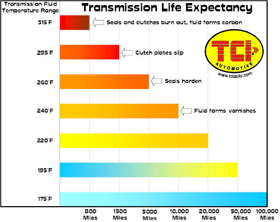

That's why a temp gauge is so important. You stopped at let it cool, as I do when plowing. Without it, the tranny is getting badly abused if it's allowed to be at high temps for long periods of time. I'm putting a B&M cooler on it sometime this summer before plow season. Maybe sooner, as I have to tow a Bobcat around a few times this summer. That's if I can ever get the rusted in solid hitch out that's in it now.
