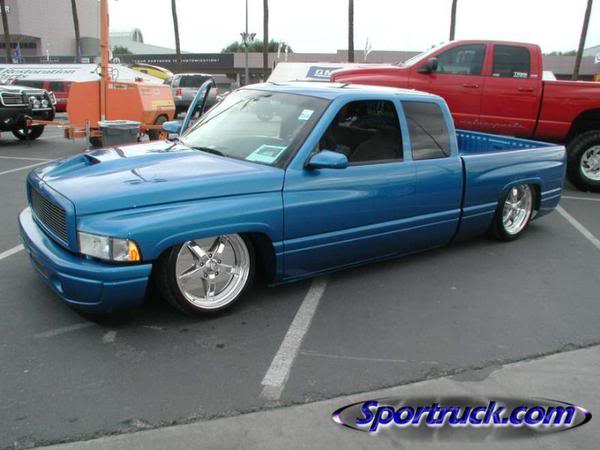

That's SHARP. What color is that?

Blue

Thats factory Intense blue just re-sprayed with some tender loving care. Its going to be 3 1/2 inches lower. Its in the process right now.
Wow, intense is correct. Looks REALLY sharp. I like it.
Can you GET 3 1/2 inches lower without dragging the frame on the ground???

Frames already there, currently taking 4 inches out of the top side of the frame snd going to gusset and box it in, cut out and raise the trans tunnel and lower the body over the frame so when the suspension is aired out the rockers are on the ground.
