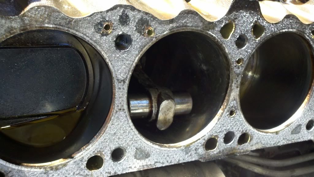

Here's what's left of a 5.9 after boost and an SCT toon (dyno tooned, not even the hokey email toons). It had about 1000 miles on the toon.
The choice is up to you, but I would get as far away from the stock computer as I can with boost.

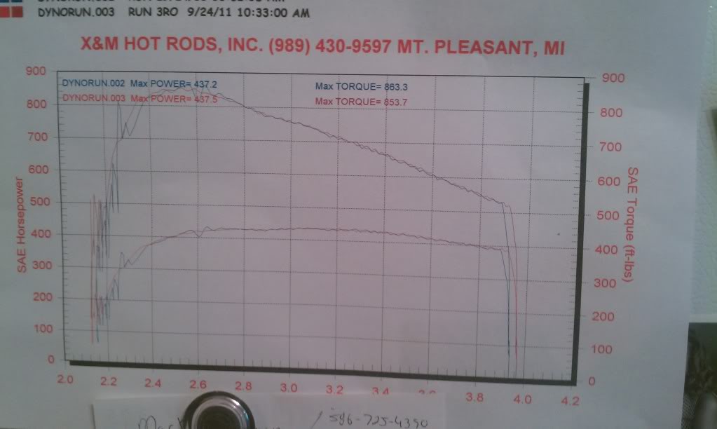

863 ft lbs of torque. what is the tranny made of!!
BTW, what is the most HP/Torque that you can get on a diesel (say a CTD from a 2004 Dodge Ram) with a bullydog tune and Propane injection?

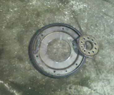

Stock trans, its my 6.0 f350...stock expect a hot burned fuel injector control module, sct tune, head studs oh and a new flexplate... Name:  imagejpeg_2_8-1-1.jpg
A 24 valve common rail motors are stout motors. My buddy had one in his OBS ford that runs HARD!
