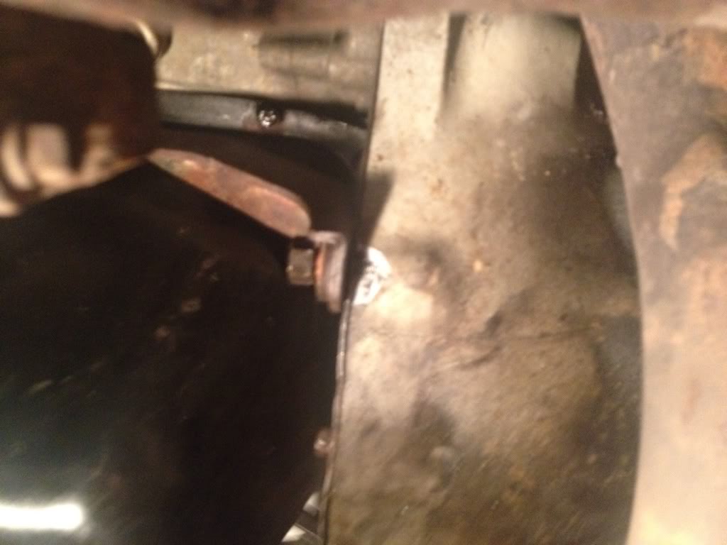

Inspection plate was the noise, fixed it.
Also I found this, how long till it goes?
Old Apr 14, 2012 | 10:03 PM
  #50
Posts: 87,479
Is that one of the braces that runs from the engine mount, to the bell housing? There aren't really any side loads on that, so, it will prolly last just about forever. Don't torque it incredibly tight though.
