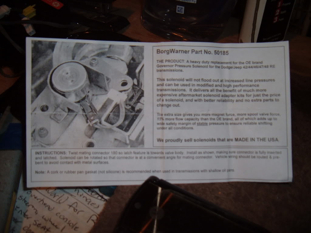

Do you happen to know the part numbers for the Borg Warner Pressure Sender and Solenoid?
I'm fairly confident since the only gear missing is 1st. Starts in 2nd but still shifts up and the OD works as well as reverse.

I don't think it's the problem, but you never know. Here's what you want for the Gov solenoid.
If you don't mind me asking, what are your thoughts on why the pressure sender and solenoid wouldn't be the issue. I'll know more when I perform the test.
By the way, where is the pressure sender located? I assume the governor is accessed by removing the pan...is that where the sender is as well?
