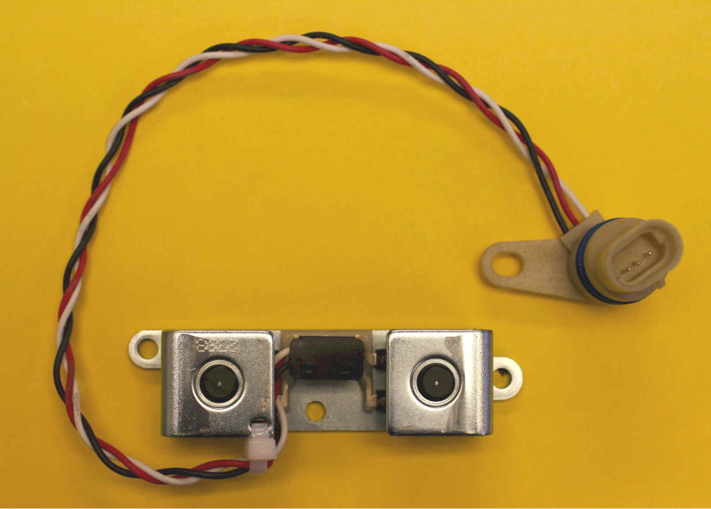

Old Apr 26, 2012 | 05:28 PM
  #58
zman17's Avatar
zman17
Retired Moderator - RIP
Posts: 18,729
Likes: 17
From: NH
If it looks like this , it's the same.

Old May 3, 2012 | 09:47 PM
  #59
awd1990tsi's Avatar
awd1990tsi
Joined: Apr 2012
Posts: 89
From: Toledo, Ohio
Well just got the solenoid replaced, and still seems to be no change at all. At first the o/d off button didn't turn off and on, but after shutting it off and going to drive it again after a nice relaxing cruise on the bike the o/d off switch is now working again but still no overdrive.
Any thoughts? The tranny shop said there weren't really any shaving in the pan. I do appear to have a fluid leak from around what I believe is where the overdrive unit bolts onto the back of the transmission. I'm not 100% that its where its coming from but its gotta be somewhere in that area since it now has a new pan gasket and still has a leak and only the back of the pan and everything behind it are wet.
