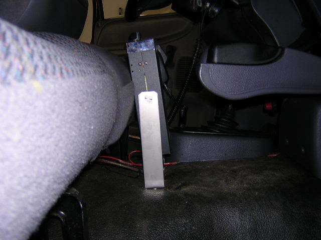

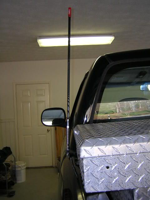

this is mine. antenna is a 2 foot firestick with a 3 inch spring. its mounted on a plate to clear the toolbox and to allow the toolbox to go in/out w/o disturbing the cb. with this antenna and mount i can drive in/out of the garage and not hit anything. reception is ok. a longer antenna or better position would work better, but all things considered this setup works best for me. i seldom need to talk to anyone farther away than line of sight.

I like how that looks but that looks longer than 2 feet to me haha. If that's a 2 foot one, i might just get a 4 foot firestik II because i don't wanna hit alot of stuff. But where did you get the mount to be able to mount it in the spot you did?

2 feet. plus a 3 inch spring a a 1 inch mount.
i got it somewhere on the internet where ever it was cheapest, maybe here.
http://www.ebay.com/itm/Firestik-II-...item2a0fe48019
i made a cardboard template, then cut it out of a piece of flat steel about 1/8 inch thick. i used a bandsaw, but a jigsaw would have worked too.
