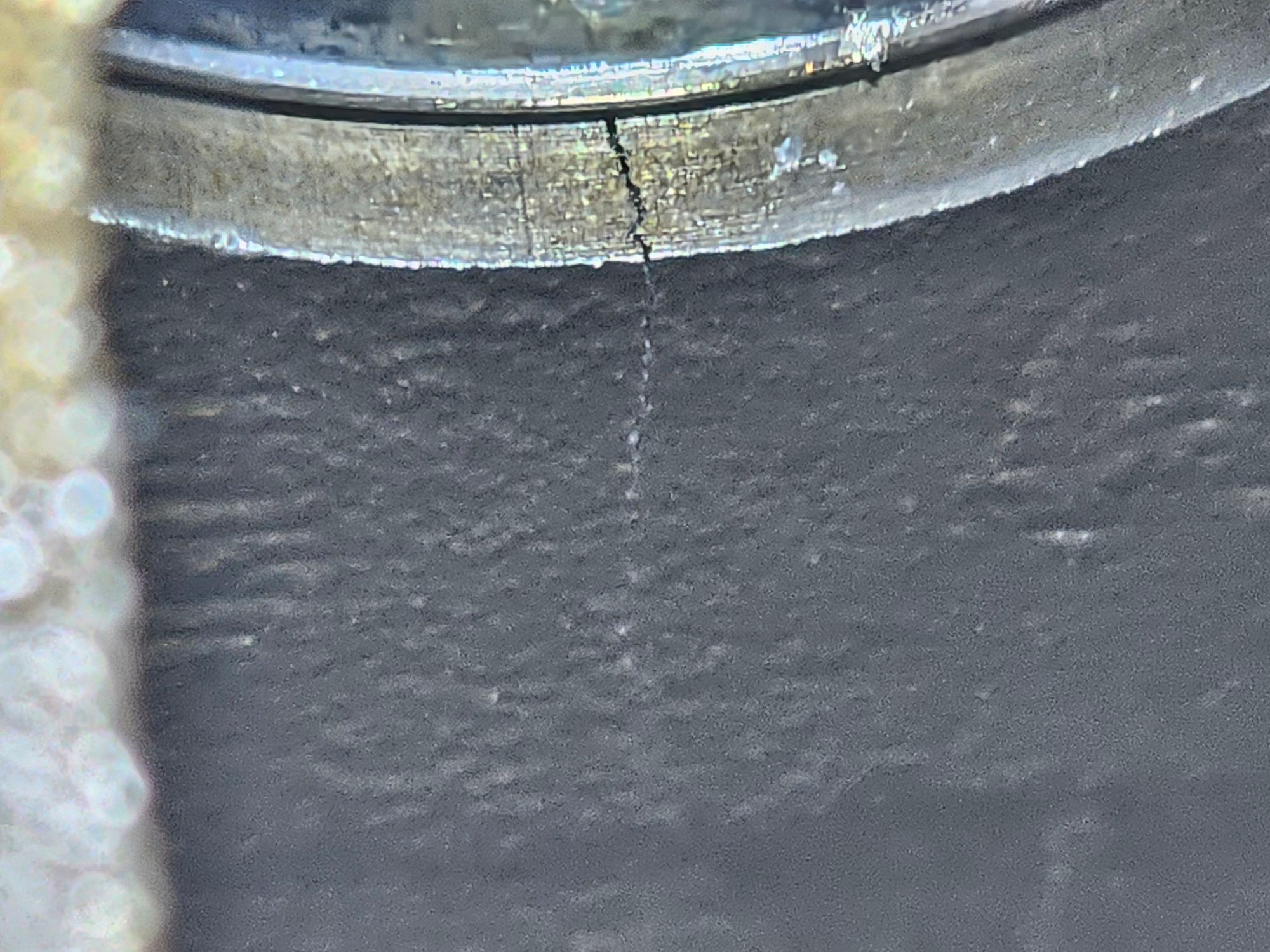

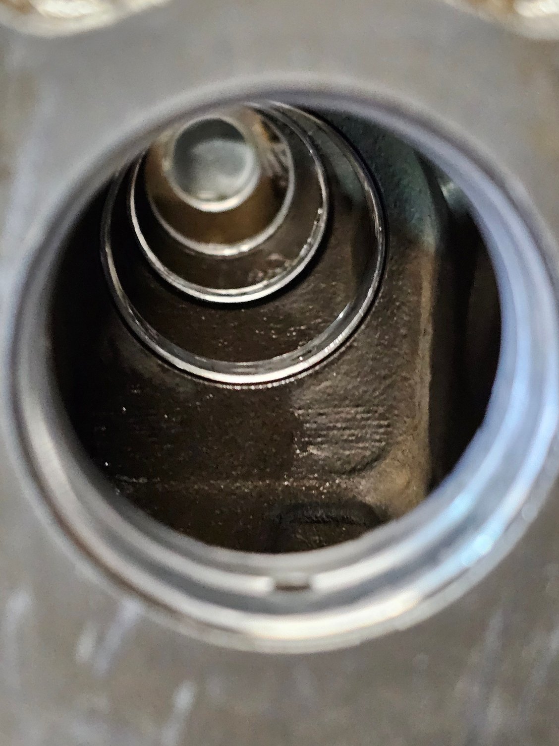

I went out to the garage for a cigar and decided to yank the cam out while I was out there. Things ARE NOT GOOD... But we now know what the problem is and why I have low oil pressure. Now since I've had all these issues with the valve springs not being correct and the valves binding I might be doing a little SWAG here but since it was the #5 intake valve that kept breaking and it's the #3 & #4 cam bearing that are bad & have spun I'm going to guess it's related. And with the shape of the bearings I'm going to guess that this is where the metal came from.
#3 cam bearing, it's spun & the metal is smashed and looks terrible.
#4 cam bearing, spun also and looks terrible but not as bad as #3.
Cam bearing #2
Cam bearing #5
Cam bearing #1
Looking down the bore.
OK I've never changed cam bearings so is this something I leave for the machine shop or can I do this myself? And do I need special tools to do it with if I attempt to do it myself?

You can change cam bearings yourself. You will need a cam bearing installation/removal tool. Lisle Tool and others make them. You 'might' be able to rent the tool at a retail auto parts store. You will also need to replace the cam plug at the rear of the engine when replacing cam bearings. If you're going to have a machine shop thoroughly clean the block, I'd let them install the cam bearings after the block is cleaned and check that the cam slides in and out properly, along with ensuring that the cam bearing oil holes are correctly lined up
Looks like it isn't going to matter... I had my positions wrong on the bearings. Bearing #2 & #3 are the ones that are spun. Bearing #4 the block is cracked... I'm going to guess this means the block is FUBAR? So this puts me in a bad position. I'll have to source another block and then have all the machine work done. So I highly doubt I'll be going to Moab in June like I'd planned.

Likes: 578
That sucks, The crack allowed the cam to spin because the bore is now larger. I doubt anything can be done with it. Even if they weld the cracks the bore is larger. I'm wondering what caused it to crack there. I think it's time to find another block.
