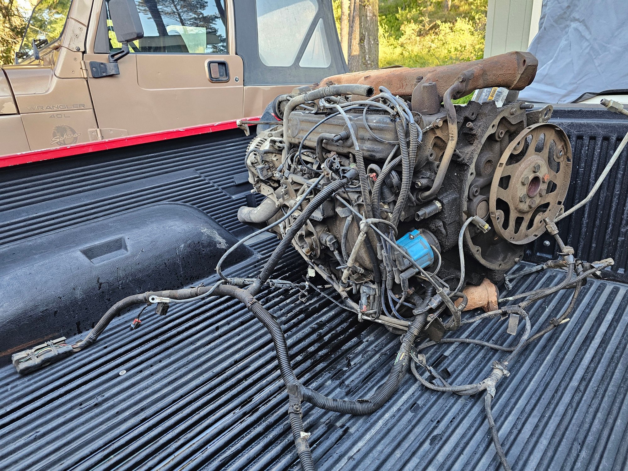

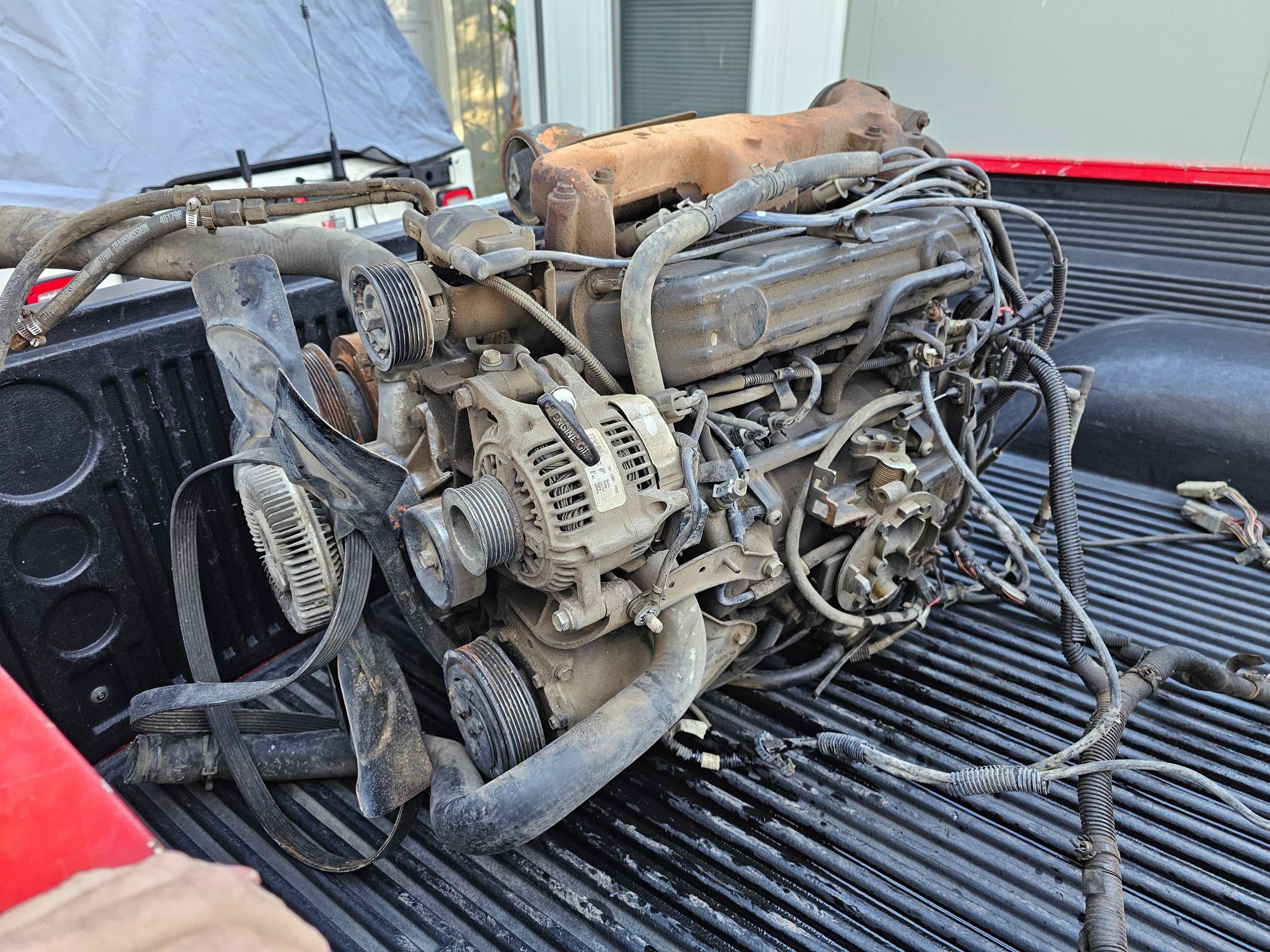

Picked up a new block today. Will start getting it tore apart tomorrow. Will have some spare parts once it's tore apart. Could use them on my truck or if someone needs something let me know.
It's pretty complete.

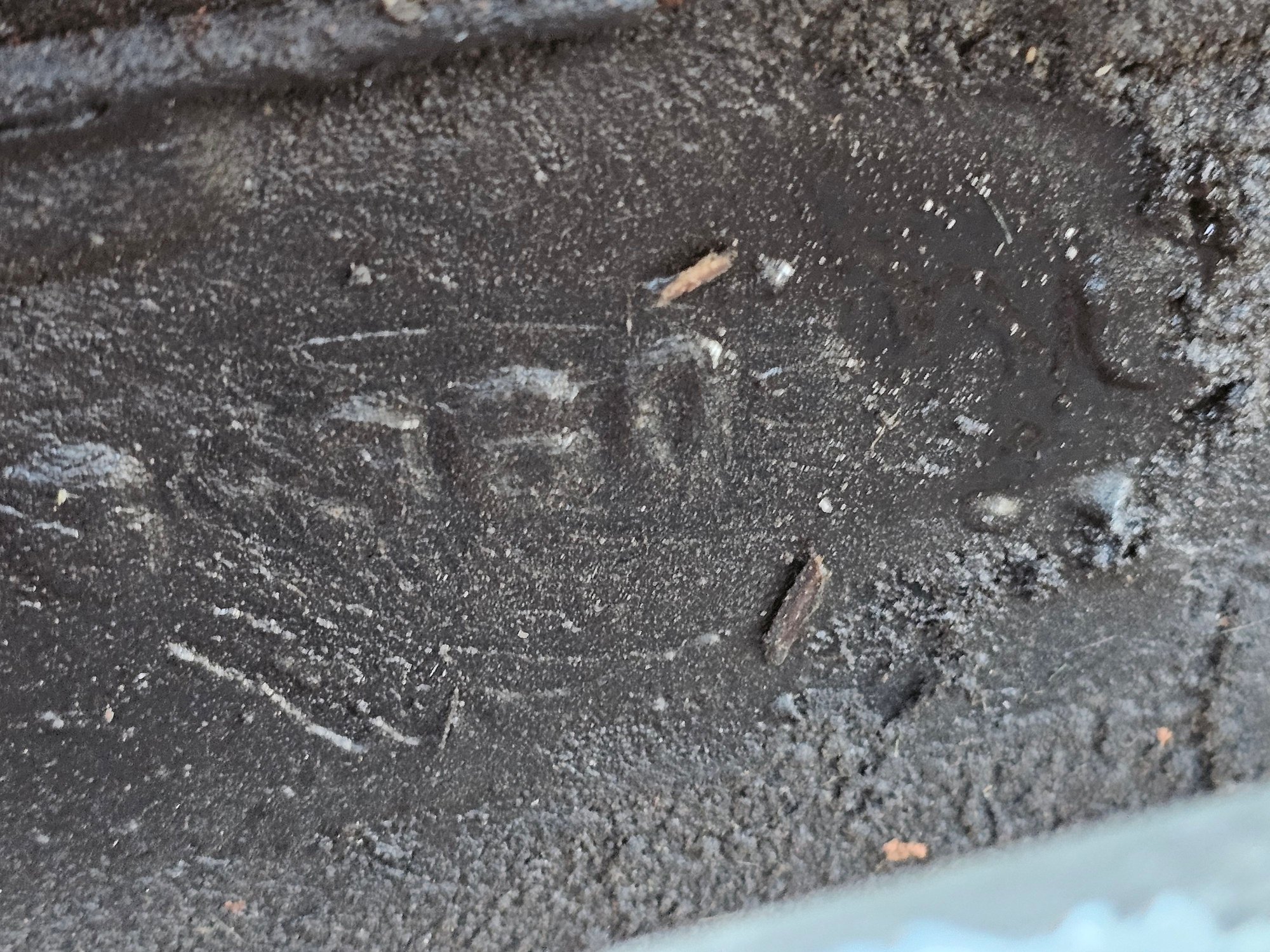

And while hard to see here's that "360" stamping.
Once I get the grease off it help me remember if I can tell the casting date by the other stampings that are on the block?
Old Apr 30, 2024 | 09:08 AM
  #1229
Posts: 87,480
Casting date should be on there somewhere, buried under all the grease and dirt.
Hey, I didn't come with the serpentine belt..... that should knock a few bucks off the price.
