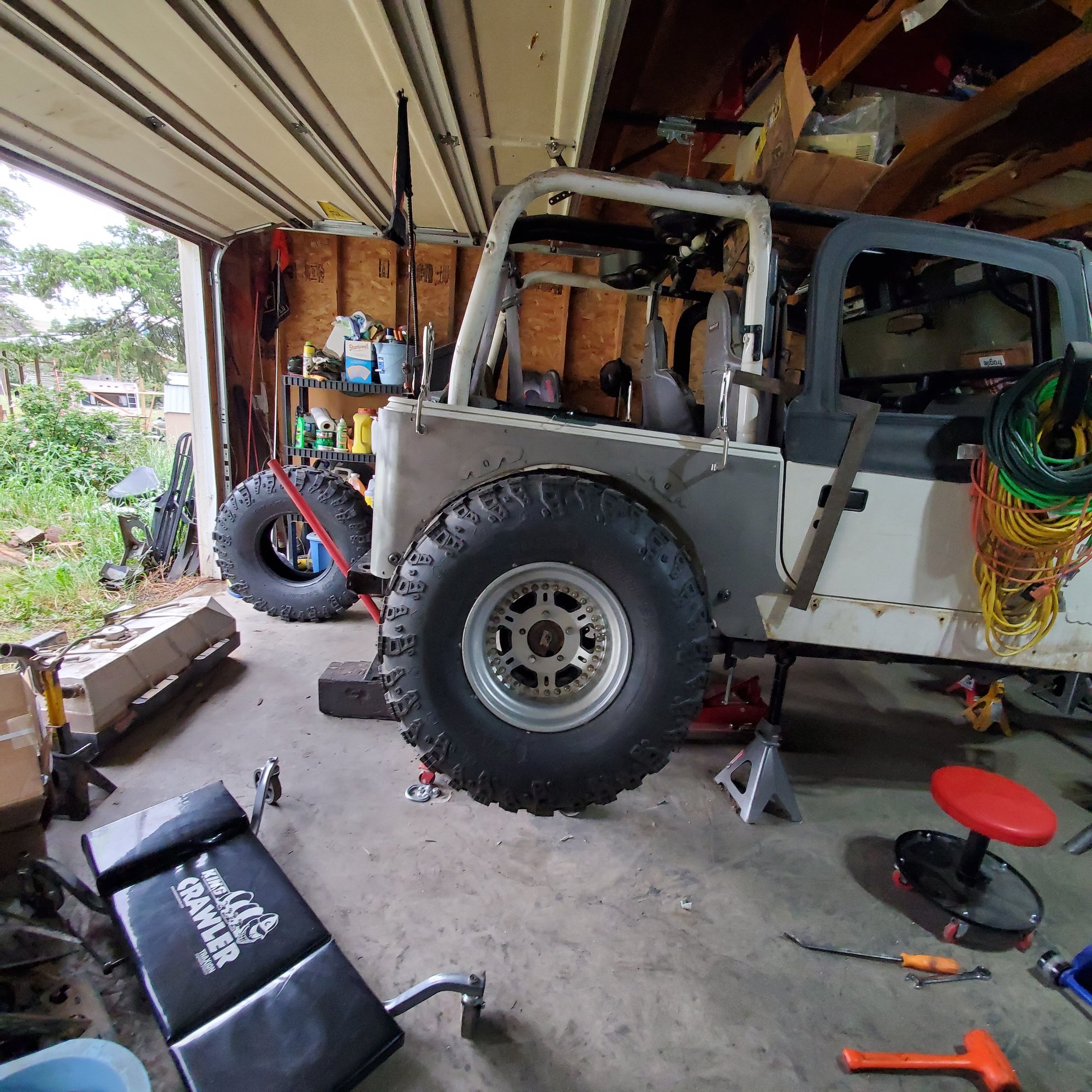

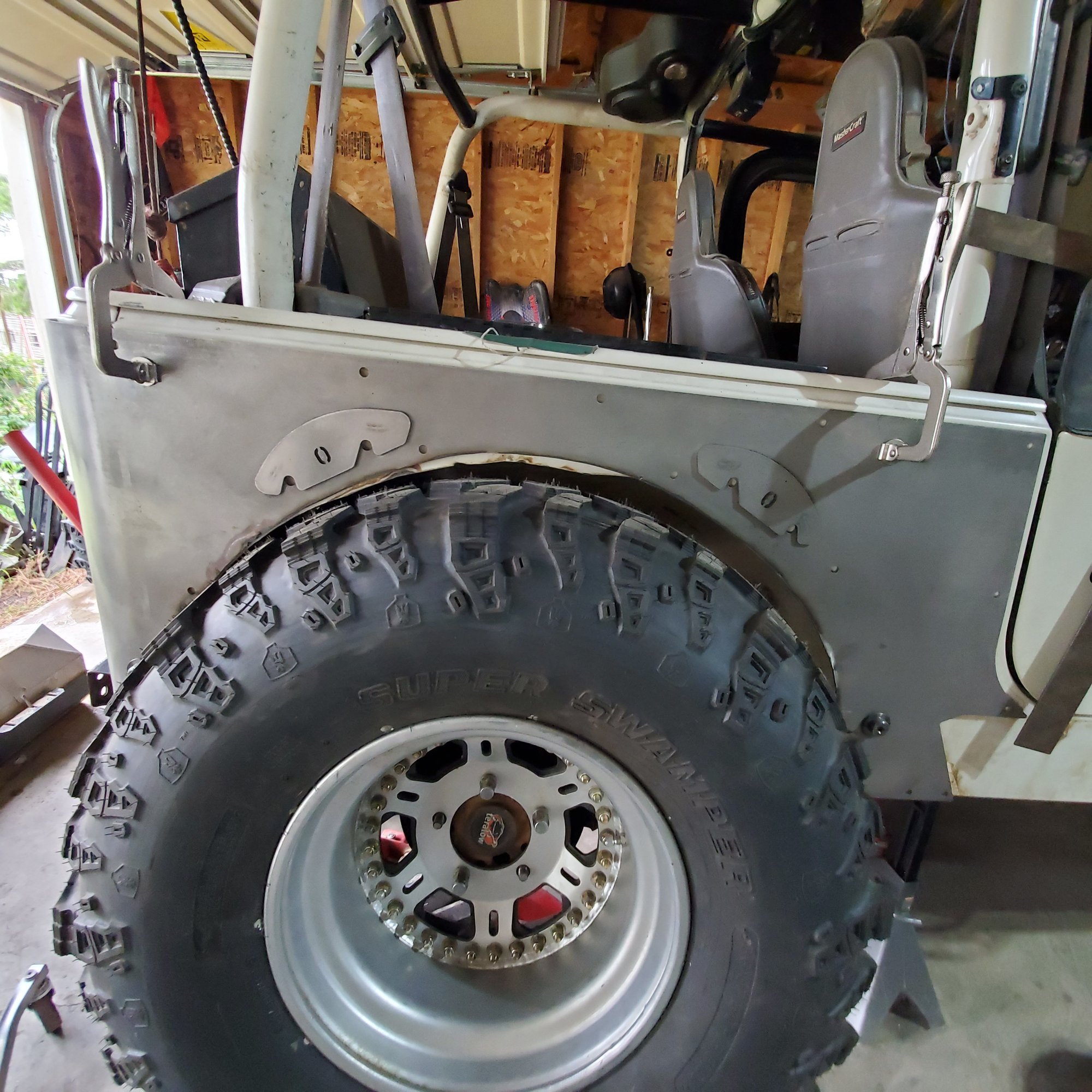

These are 36x13.5x16.5 Interco IROCK's on Stazworks dual beadlock wheels.
It JUST fit with now much room to spare.
The StazWorks wheels are some pretty KEWL rims. He makes them in about any size you want from 15" up to 22" or even larger for 2 1/2 axles or Brush Fire rigs. I learned about StazWorks when I was in Iraq. One of the gun truck had them on it and they hit an IED one day. Other than scratching the paint on the rims they help up really good.

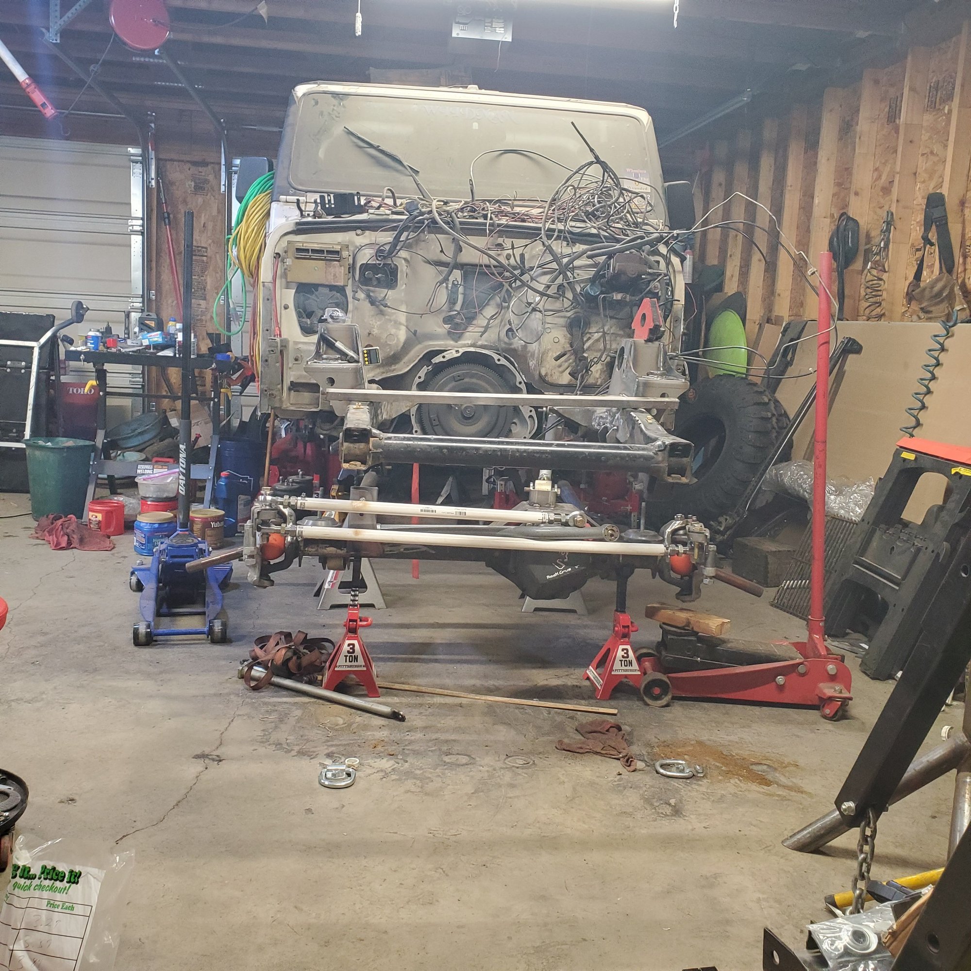

JEEP TJ STEERING BOX ROTATION KIT: Jeep TJ Steering Box Rotation Kit 97-06 Wrangler TJ/LJ TNT Customs | Jeep Aftermarket Parts | TNT Customs

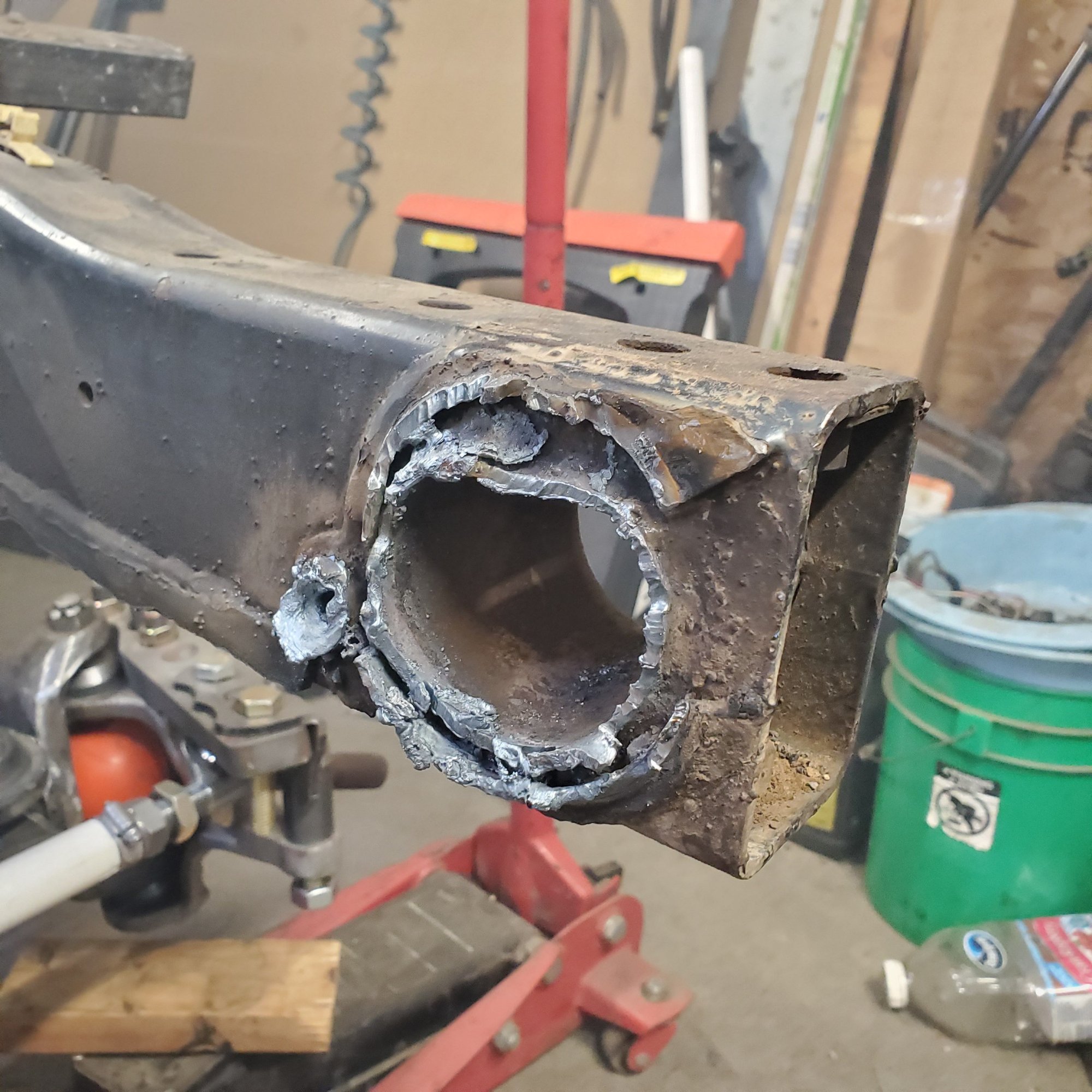

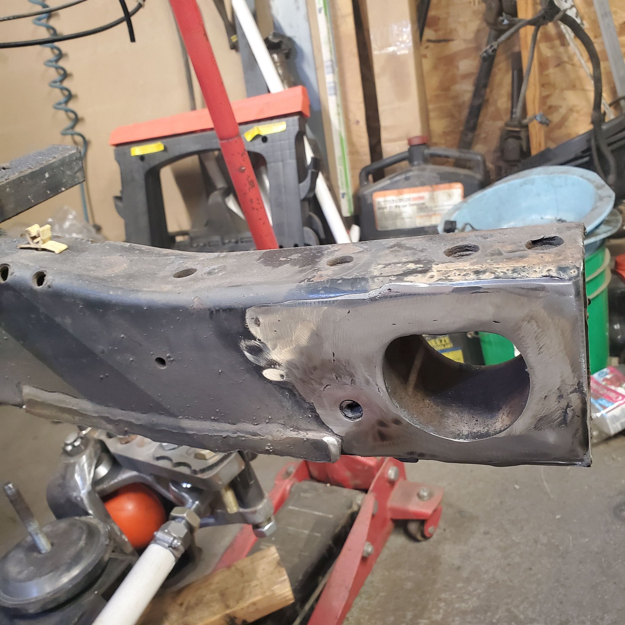

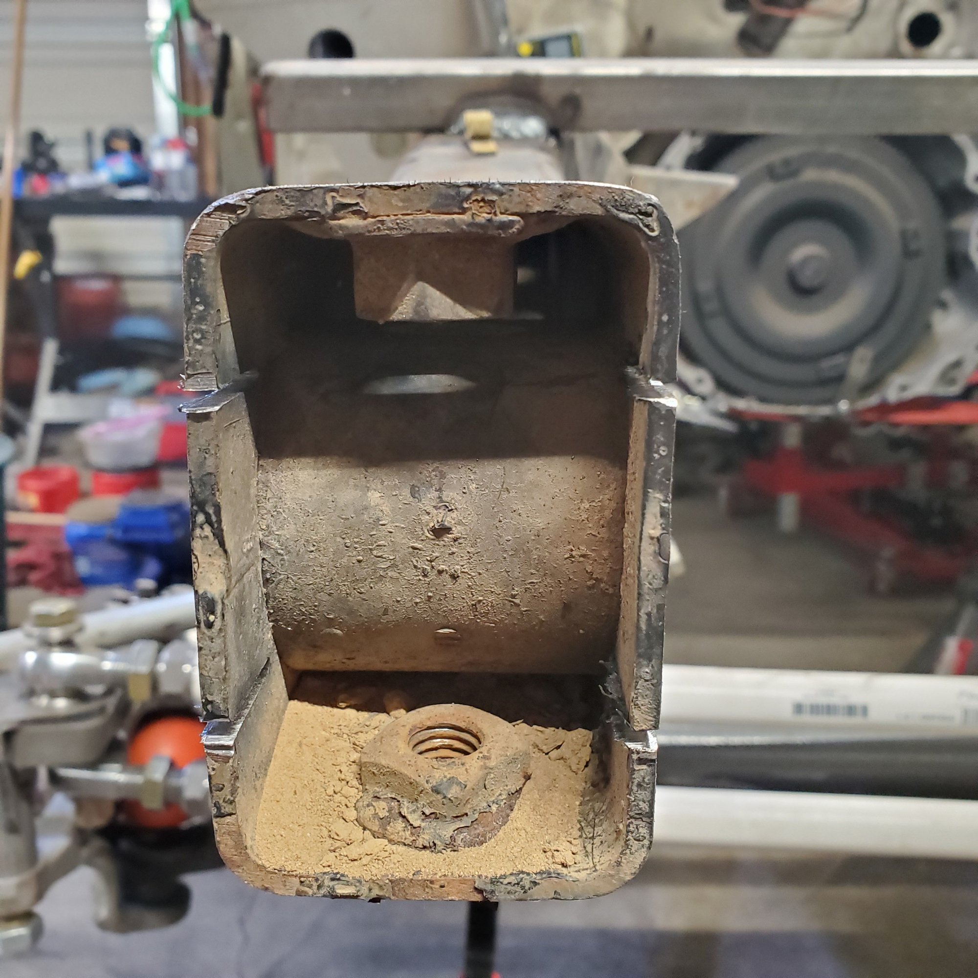

Yesterday I started working on this kit. You have to remove the front crossmember to install it. Not really that hard with a hot butter knife (plasma cutter) So here it is WITH the crossmember.

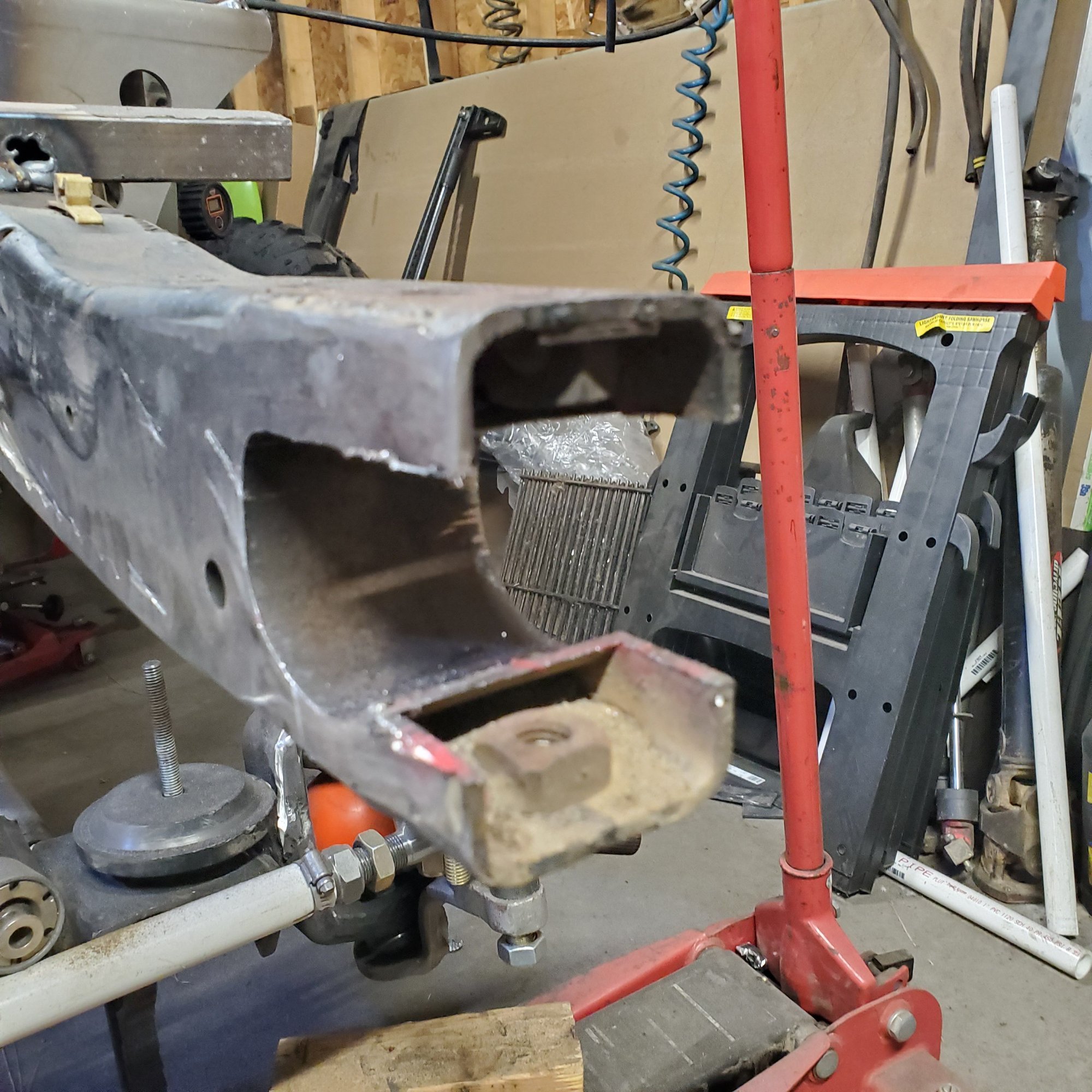

And then with it gone.

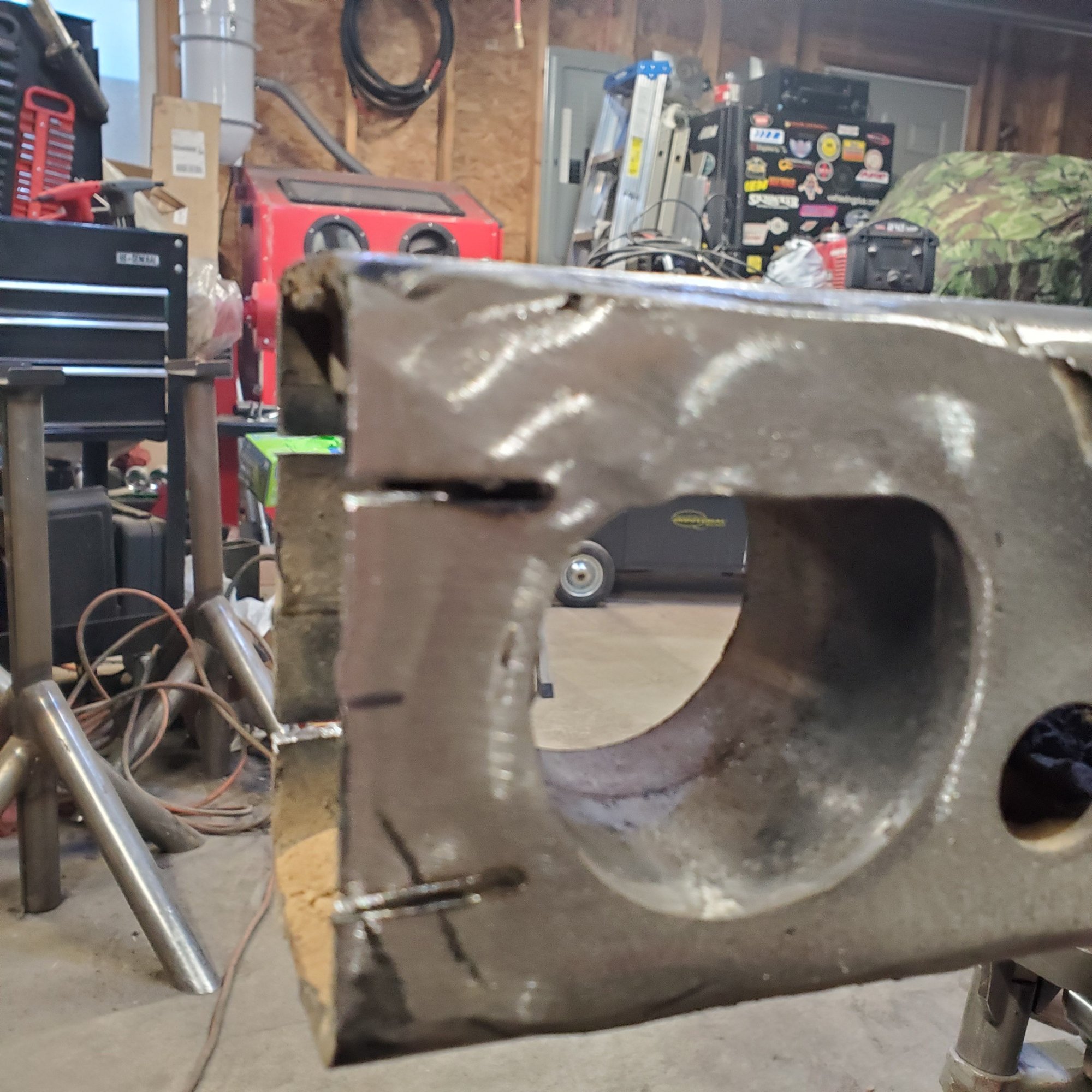

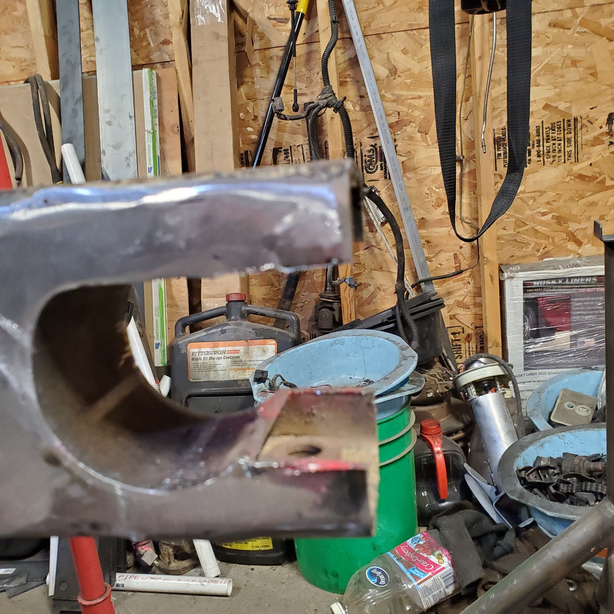

Then it was time for a lot lot lot of grinding.

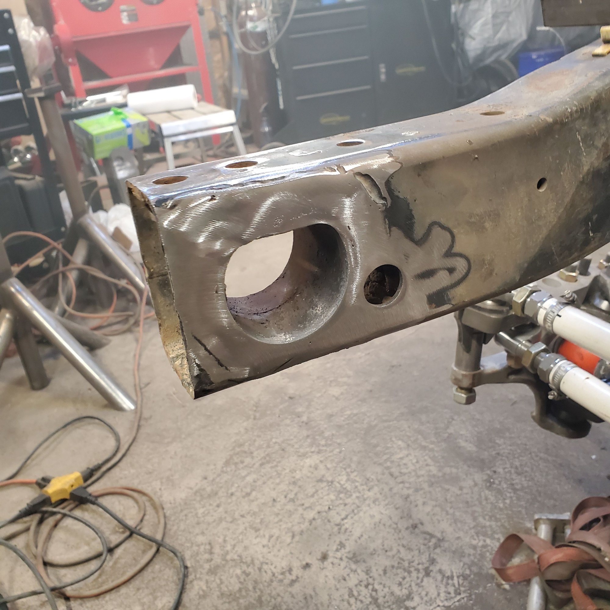

And more and mote grinding.
Cleans up fairly well.
Both frame rails done.

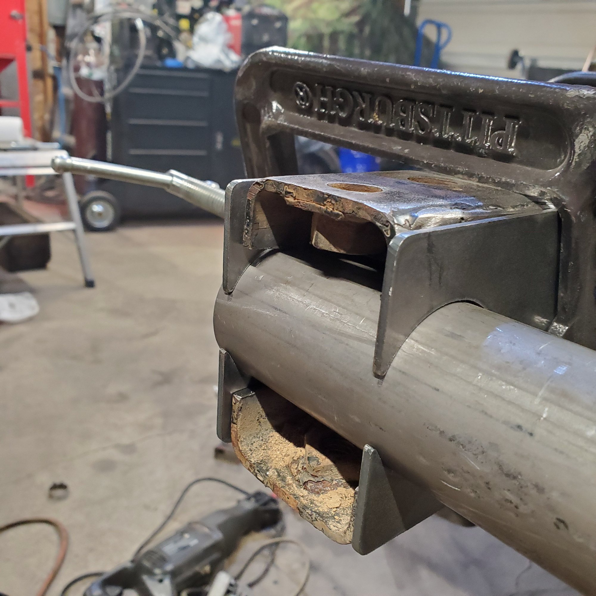

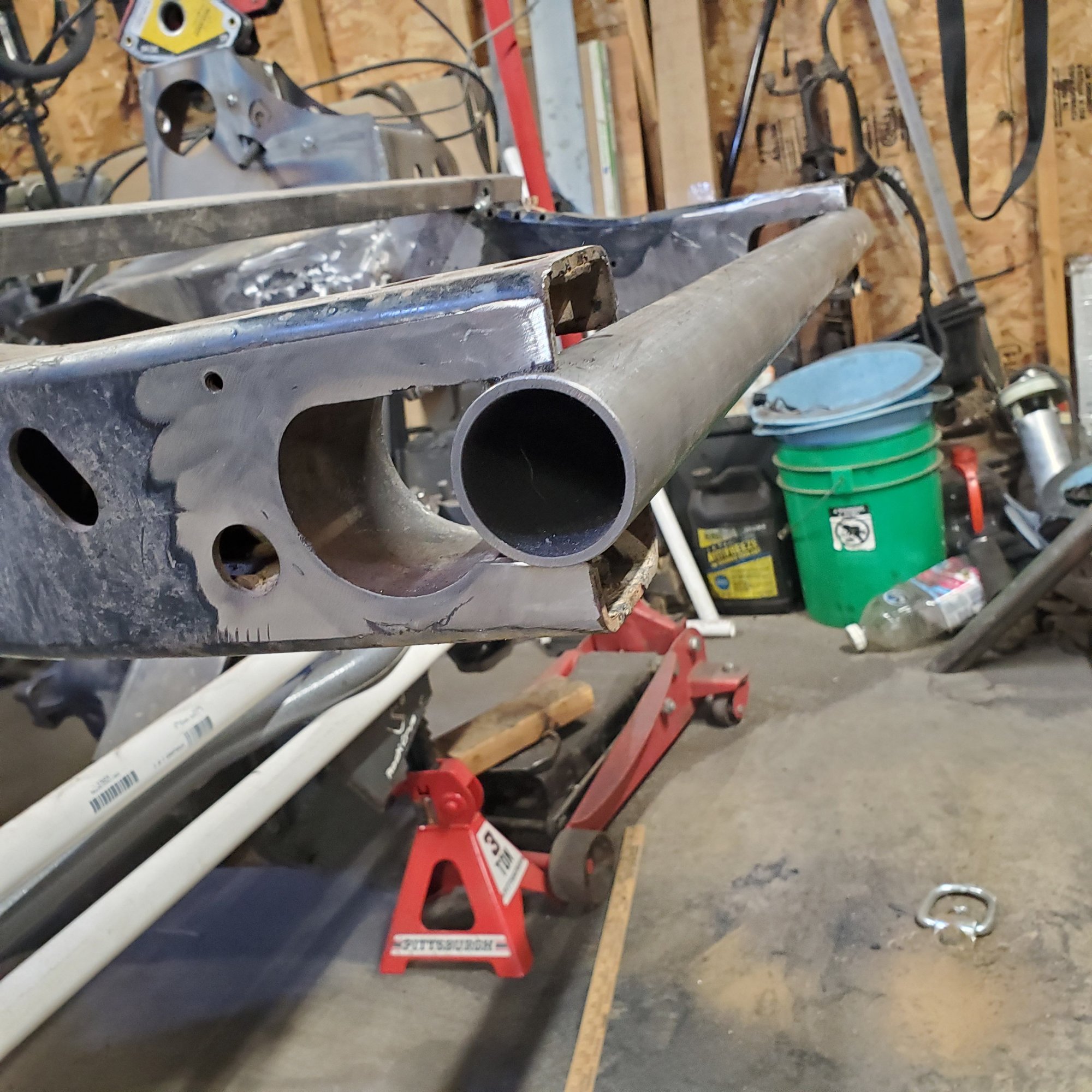

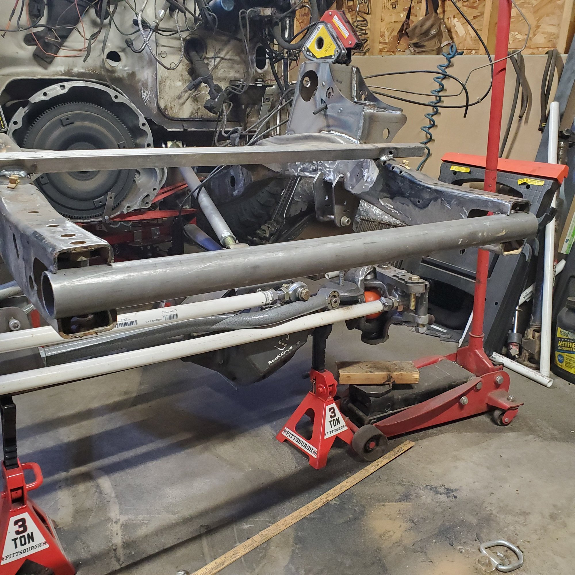

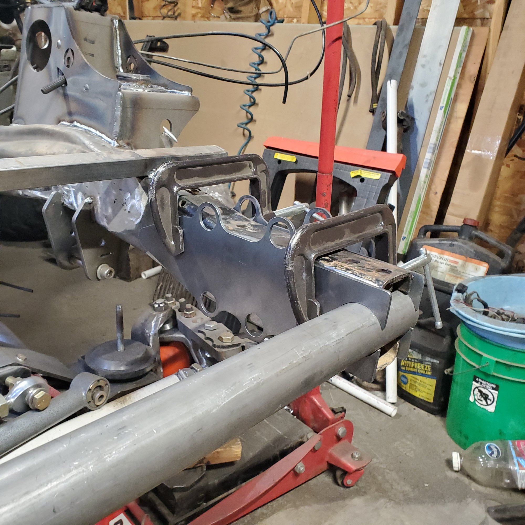

What this kit does is it replaces the crossmember which allows you to rotate the steering box and this allows you to push the axle forward 1-3". To do this you have to cut out a 2" section on the front of frame.
The new crossmember is a 2" piece of tubing.
Both frame rails were notched.

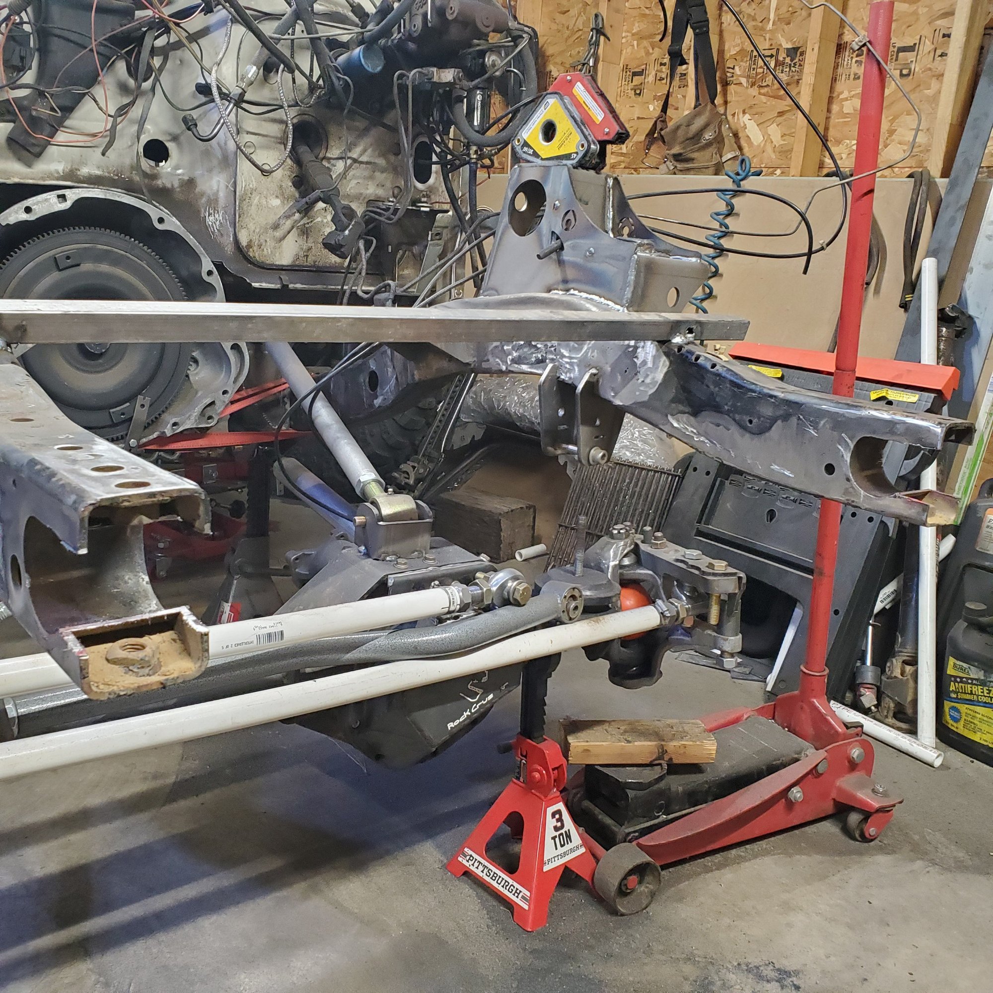

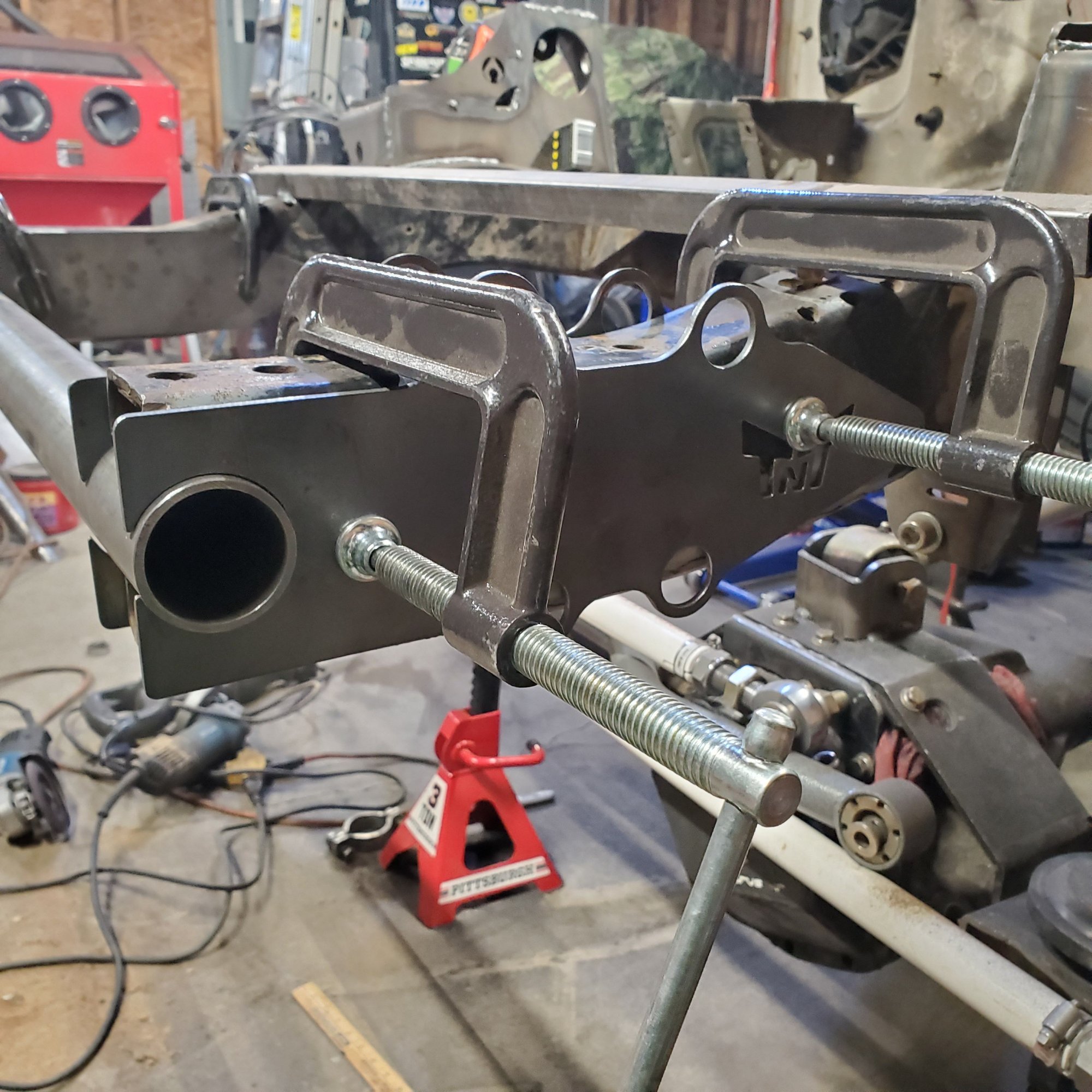

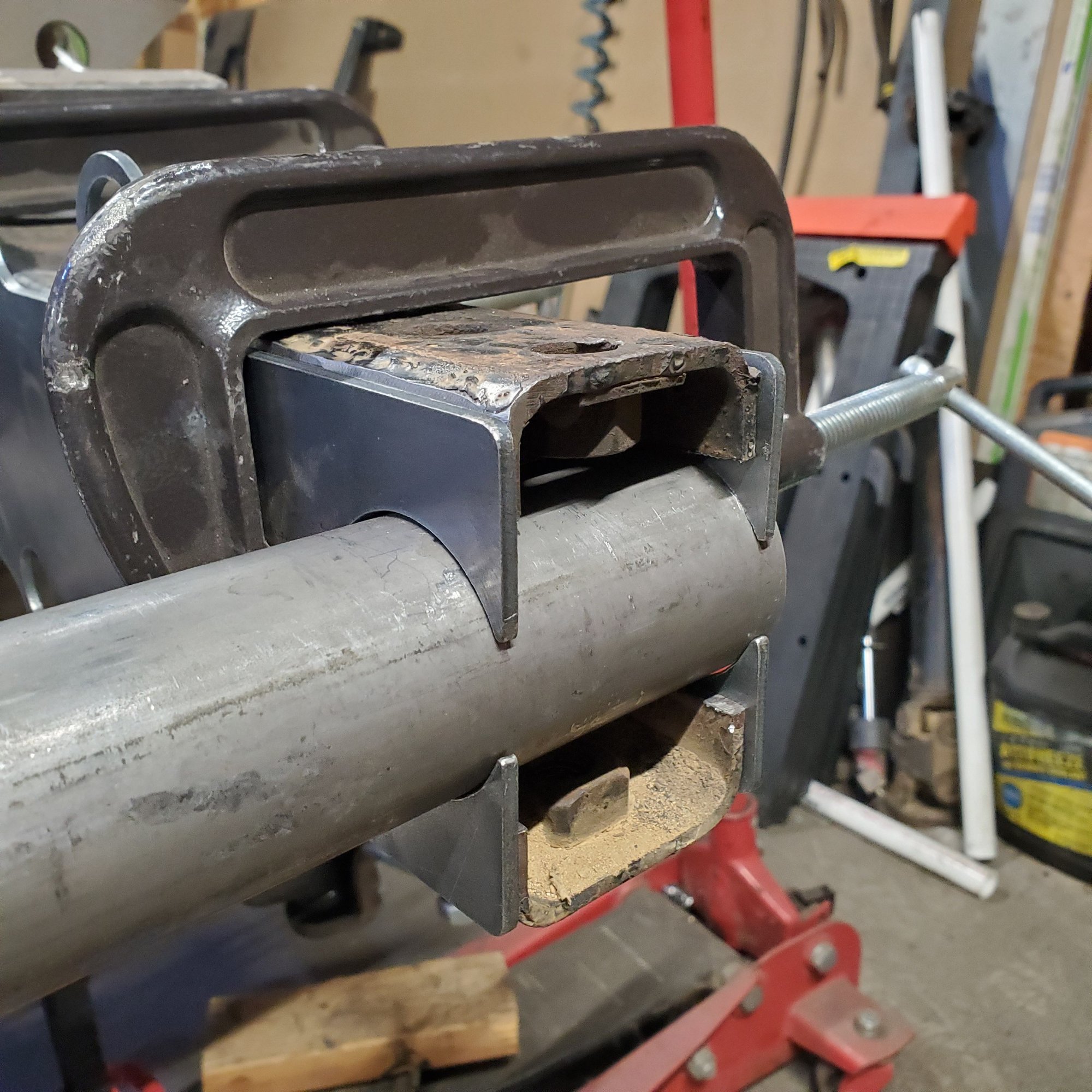

Test fitting the crossmember
Then slapped the new end plates on for a test fit. I needed to push it in a little more.
This is where it need to sit so I pulled back apart so I could paint the insides of the plates and the frame with weld thru primer.
Had to take my dog to the vet today so this was as far as I got.. Tomorrow I'll get all the welding done.
