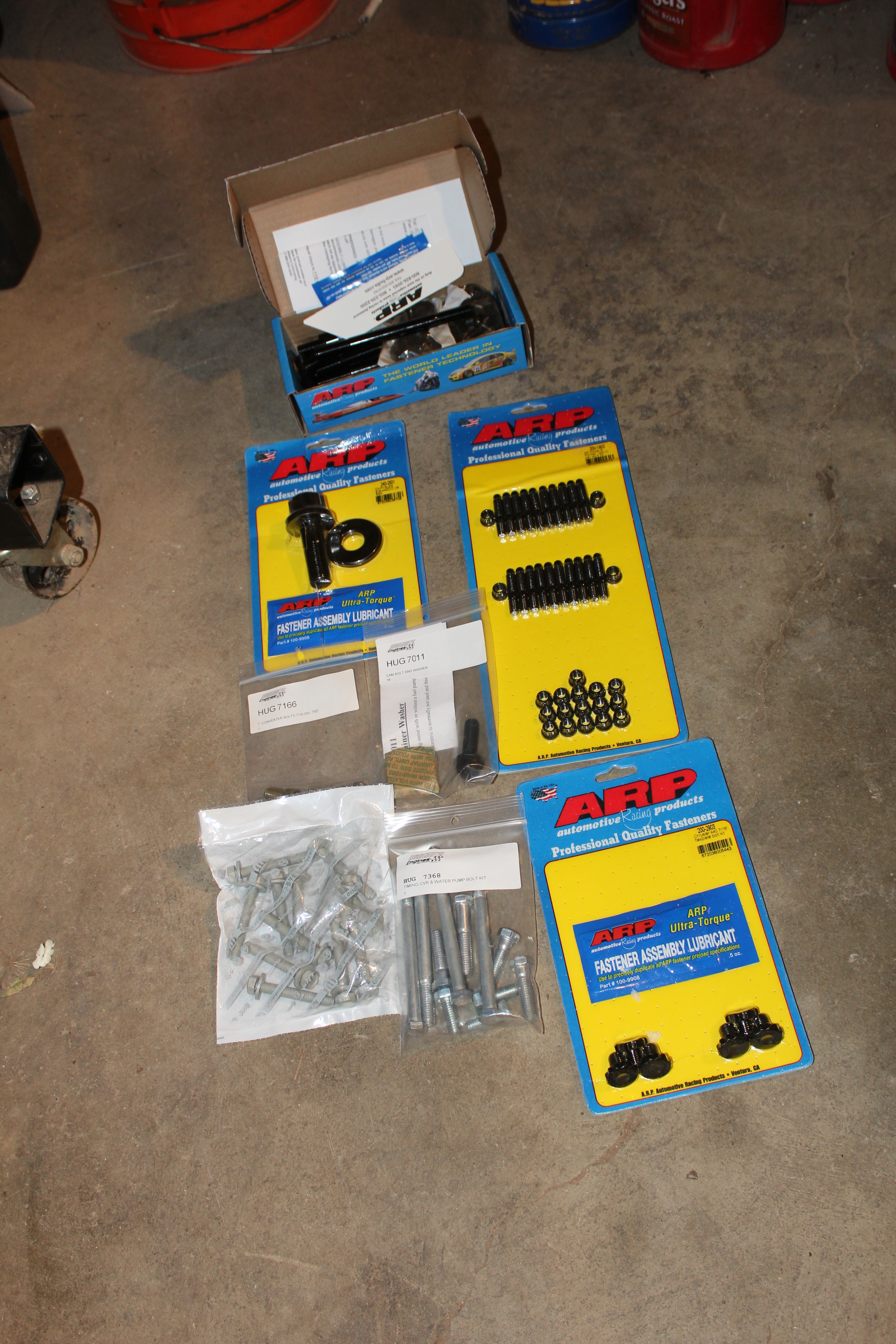

Howdy guys,
Well I thought I was going to be able to buy stuff for my Jeep Friday but the ex made sure that I won't get to this month.
Here is some stuff I have been gathering for the past 2-3 months.
ARP Head Studs
ARP Oil Pan studs
ARP Balancer bolt
ARB Flex Plate bolts
ARB Torque Converter
Hughes Engine Intake manifold bolts
Hughes Engine Water pump & Timing Cover bolts
Hughes Engine Cam bolt & washer
So I have a good collection going so far. Since I am going to send my engine into the machine shop I think I might get main cap studs while I am at it.

Originally Posted by snowboundrmk
What stall converter are you running in that new trans? Don't want you to make the same mistake as me haha!
It is the torque converter that came with the tranny. Martin Saine built the tranny and included the converter with it.
Originally Posted by midnight_f150
Could you post the part # for those ARP Oil Pan studs please?
http://arp-bolts.com/kits/ARPkit-det...p?RecordID=750
