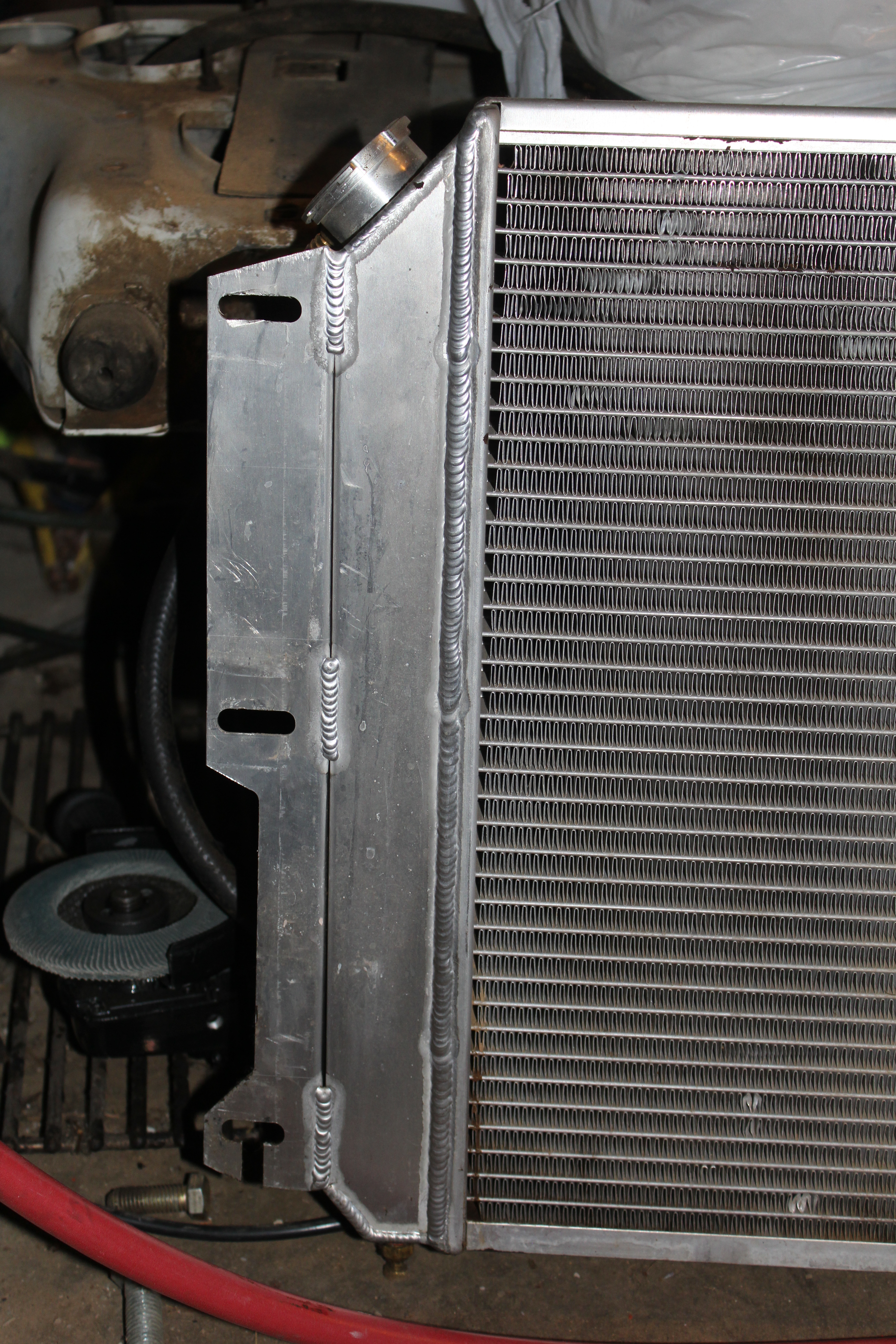

Could you just drive the front right onto a ramp (or jack the front right) making the filler the high point of the system.
Yep I could do that or just tilt the Jeep with my air bags.
Originally Posted by Spillage
Or you could put something like this in the top hose
I thought of something like that also.
If I do reuse this radiator I also need to get the side plates rewelded because it sits 2 1/2" to high right now. So I have to find a shop that can weld aluminum.

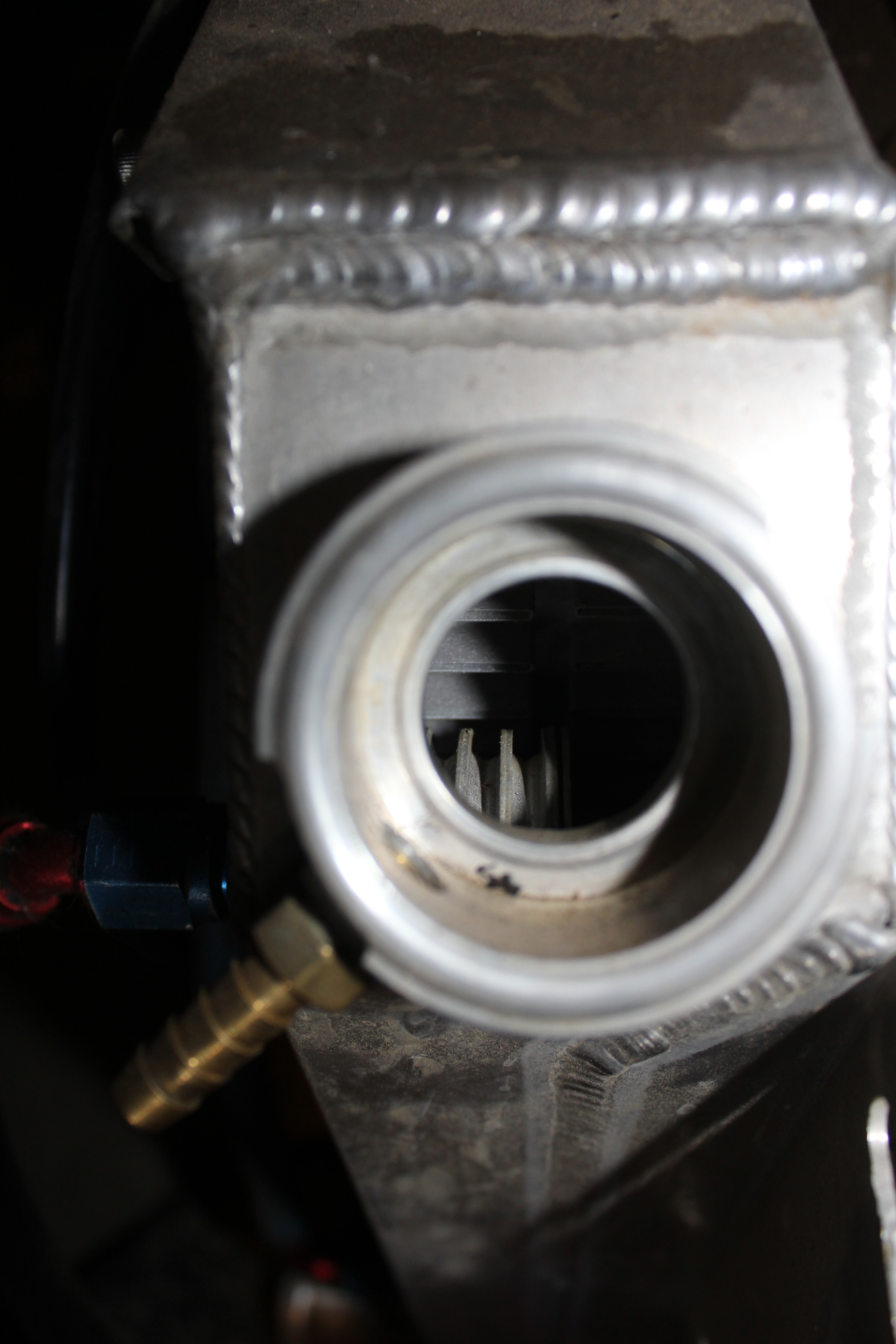

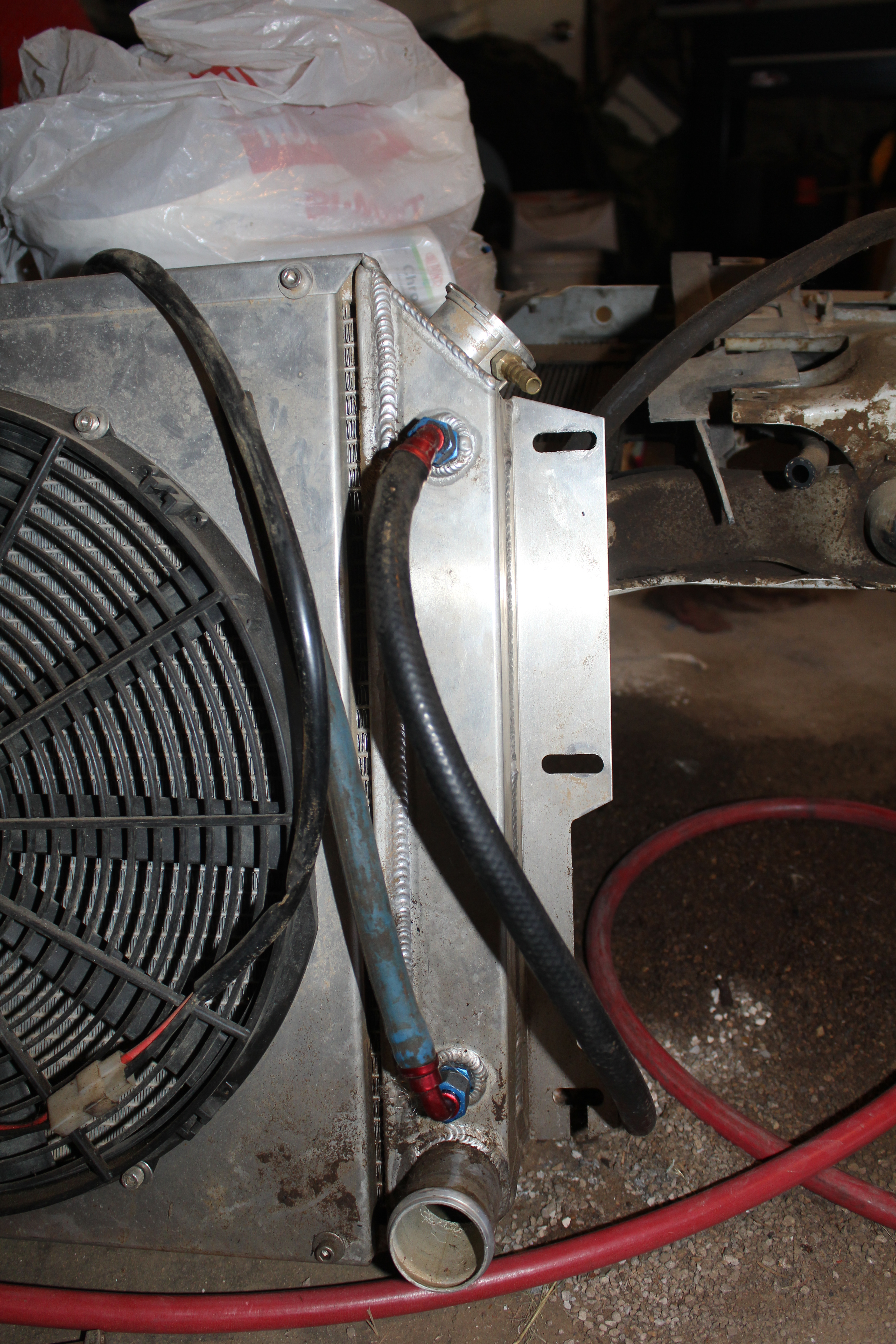

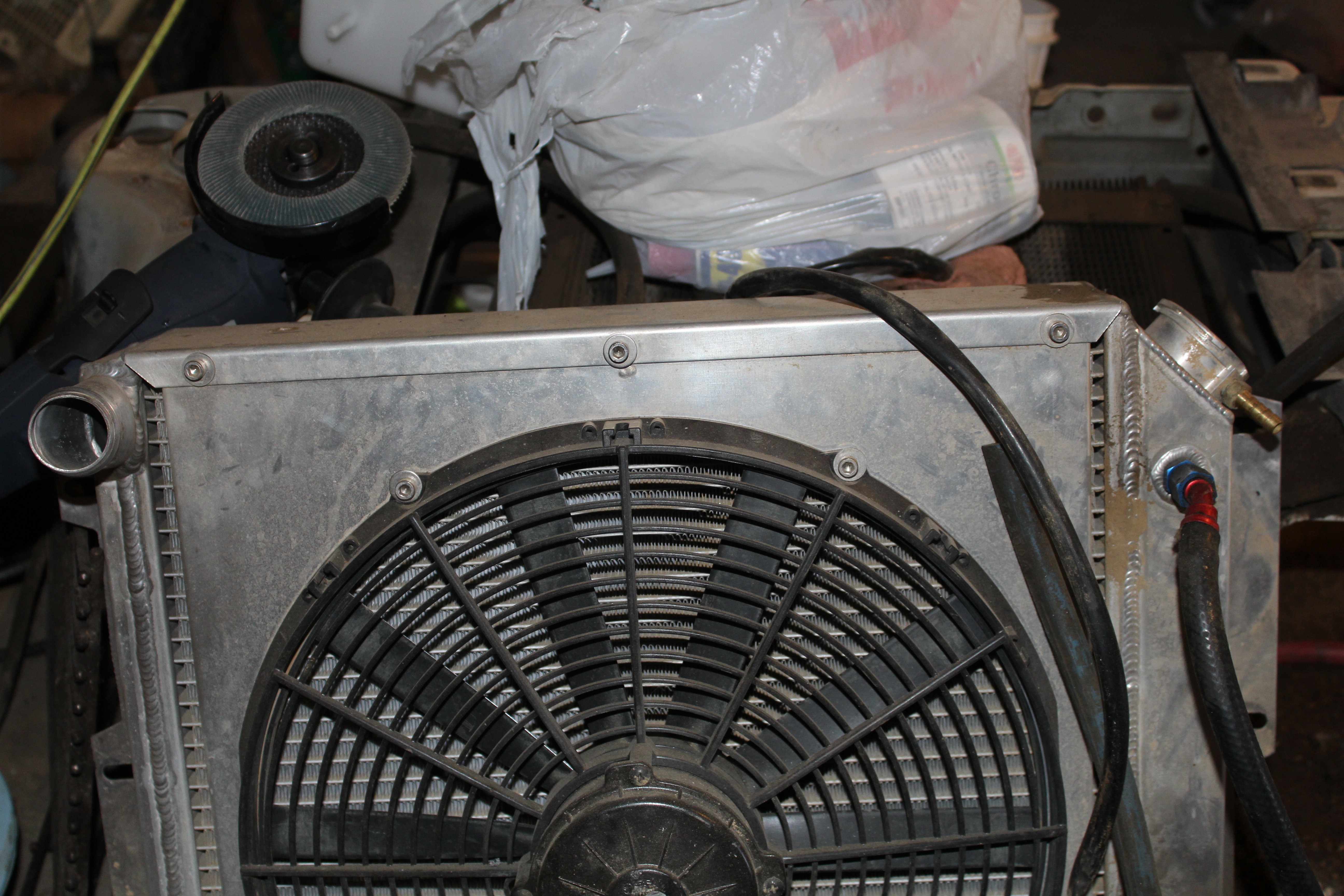

Yes well like I said I have been looking at this damn thing now for 6 months and the more I look at it the more I hate it. I took some more pictures and I want everyone to look at the drivers side tank. Notice how small it is? I don't know squat about radiator design but that just doesn't sit right with me any more than the filler neck. And yes the simple solution is to just add a filler in the top hose.

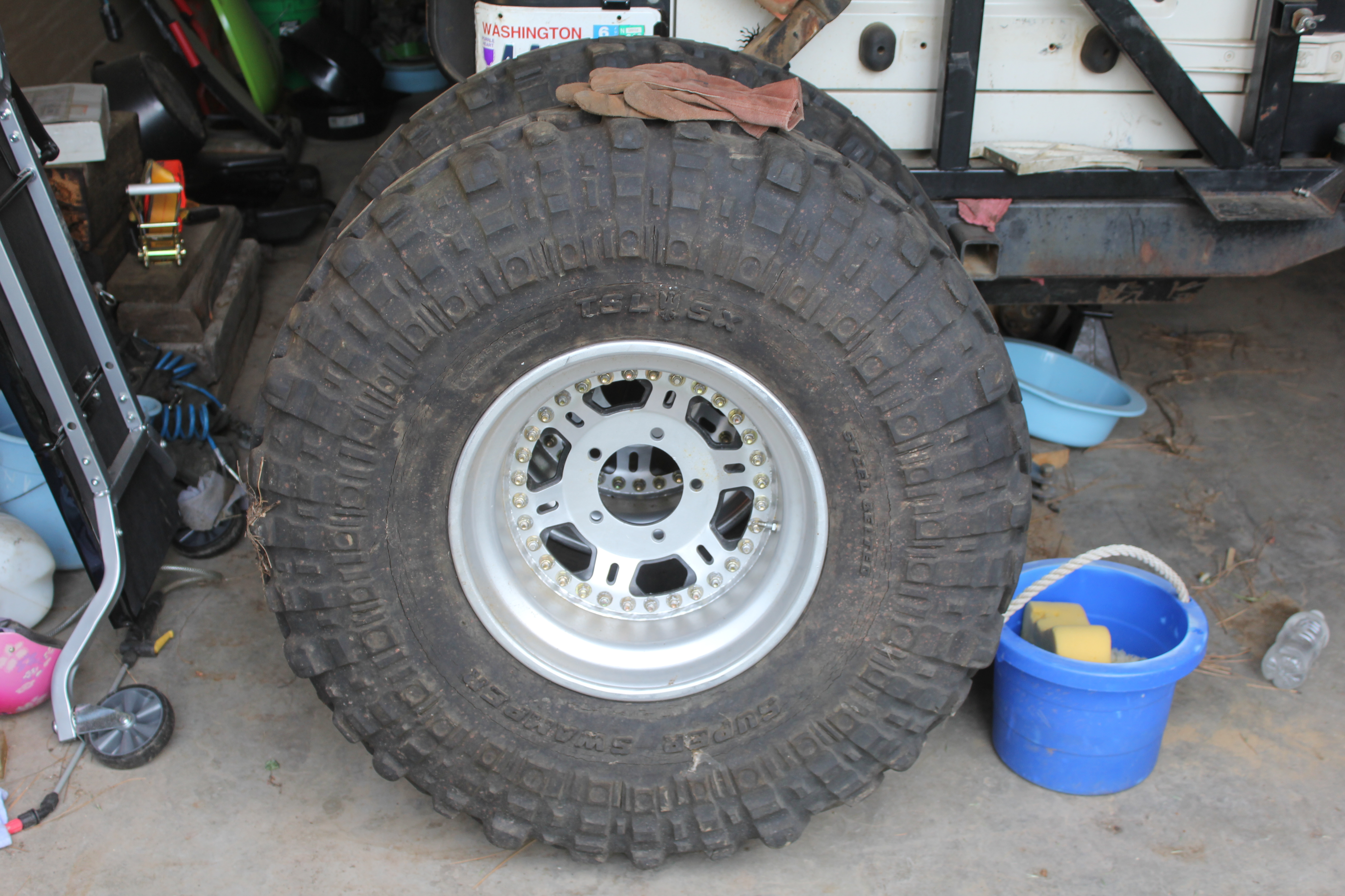

Now nothing to do with the radiator but here are shots of my new rims. I got these made for me by Stazworks.
They are some awesome rims and he makes rims for the military plus lots of other folks. Check him out the next time your looking for rims.

Tank size isn't really all that much of an issue, its the fins and tubes that provide the cooling, larger tanks just give you more coolant capacity.
I agree, the design there does leave something to be desired...... but, any of the previous suggests should take care of that for you. Either that, or just replace the radiator, and sell that one....

The rims are a two piece rim like Hummer rims so you end up with a dual beadlock wheel that will handle pretty much anything you throw at it. You can't tell looking at it but the silver part is one section and the black is another section so it is two complete half's. The wheels were $315 I think and then the rock ring was $30 or $40 more. Now this price includes powdercoating the color you want.

Those look great WM! Stazworks has been on my short list for sure. What I have not been able to tell is if they try to balance the assembly? I read that they clean up welds, fill/turn down where needed, but that doesn't necessarily imply for balance. More for true/plumb/etc. Any idea on this? For me that is important considering street-ability.

I can't tell you how good or bad they will balance out yet since I haven't tried to balance them. When I had my Hummer rims I never had any balance problems. 38" tires aren't that easy to balance anyways. I wouldn't be too worried about then not balancing out. You can always run BB's in them too if they are causing you problems. I use to run my Jeep down the road at 60-75MPH with no problems and had zero weights on them.

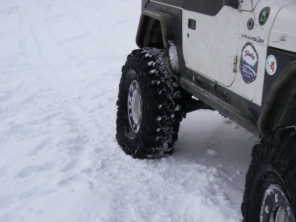

This was with my Hummer dual beadlocks and 2psi in the tires. I was floating on top of the snow while others were getting buried.
He's running a 37" tire on this Jeep. But didn't want to drop his air low enough to float on the snow. You need to be down in the single digit range.

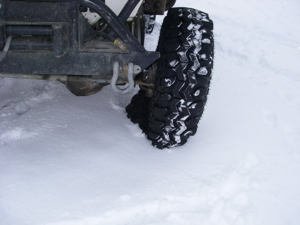

Kinda like this.
