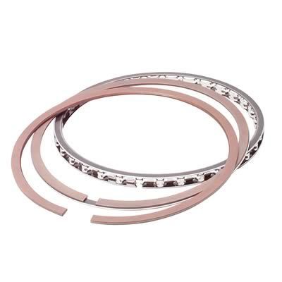

Next month I'll be ordering this from Summit.
Total Seal on Summit Racing
Then just need the ring grinding tool to gap all the rings. Of course I still have to get a wide band Air/Fuel Ratio gauge. If I can't find one that does data logging also I guess I'll have to get a data logger too. I already have the SCT tuner.
