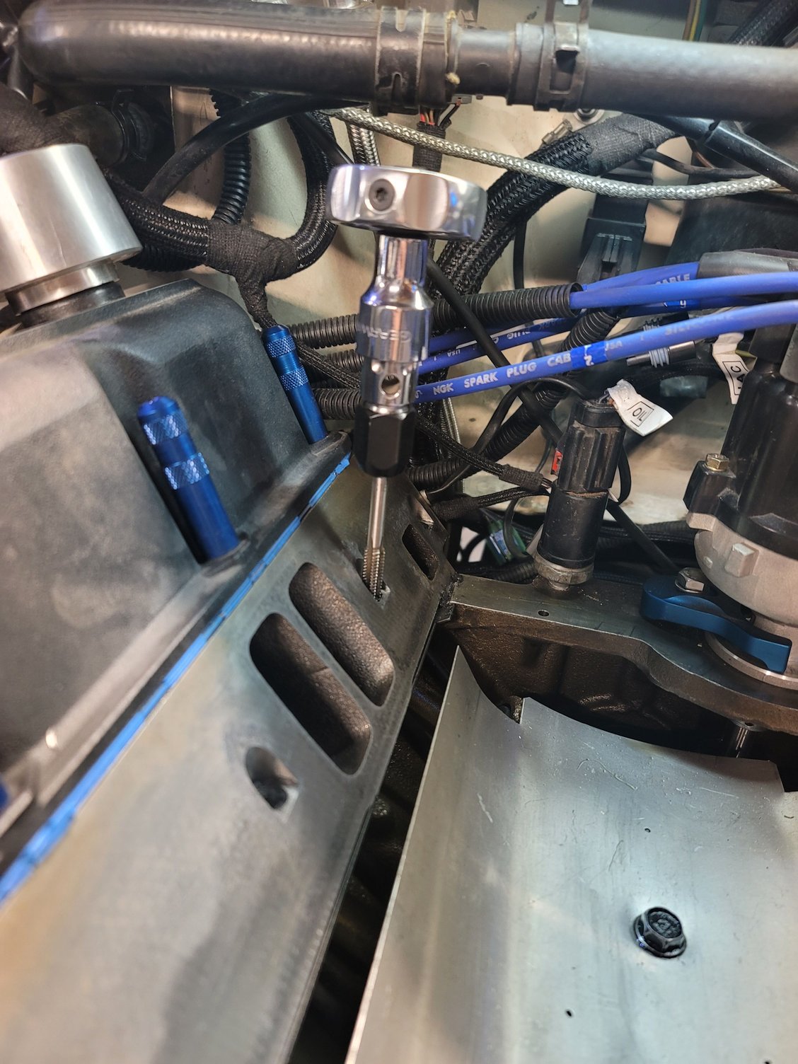

I'd started out getting everything cleaned up and ran a tap thru the heads to clean up the bolt holes.

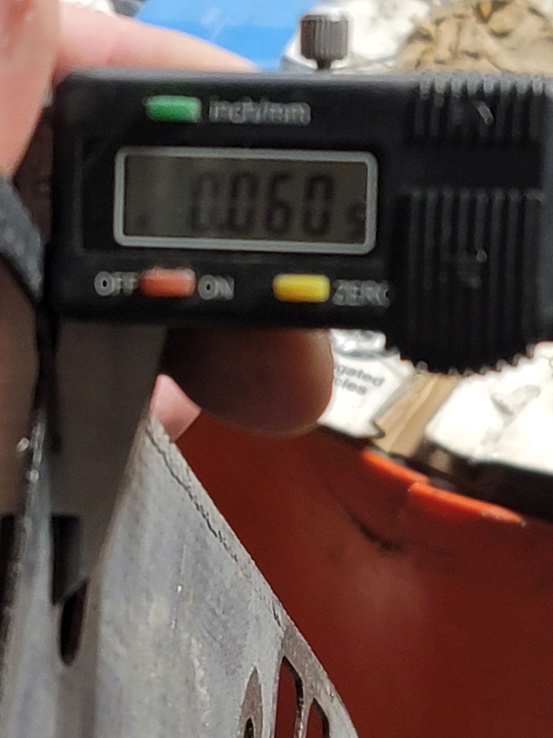

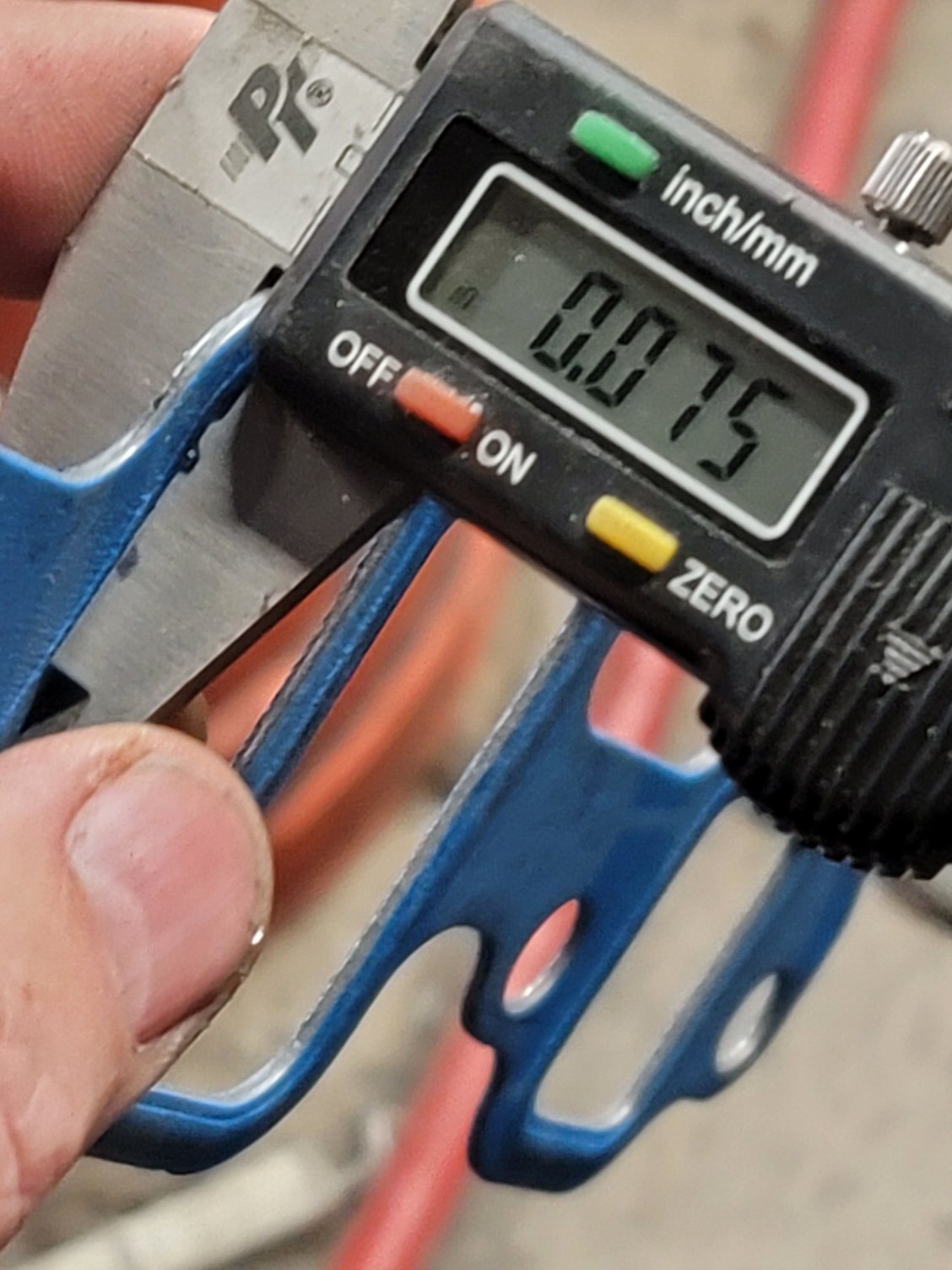

OK here is the next thing. The flat Fel Pro intake gasket is only 0.060 thick.
The new gaskets I from Fel Pro I picked up today are 0,075 thick with the raised side towards the intake.
F&B suggested I do a dry installation of the intake and use a feeler gauge around it to see if I have a warpage or not. They also suggest not to use the rubber gaskets on the china wall but instead to use Right Stuff. So I've got my work cut out for me over the next few days.
I'd also noticed my serpentine belt jumping a little bit and it still has a small chirp to it now and then so I've ordered a new belt, idler pulley and tensioner to see if that helps any.

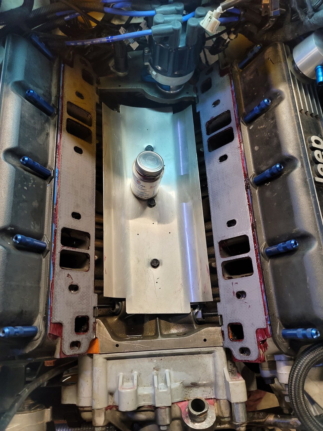

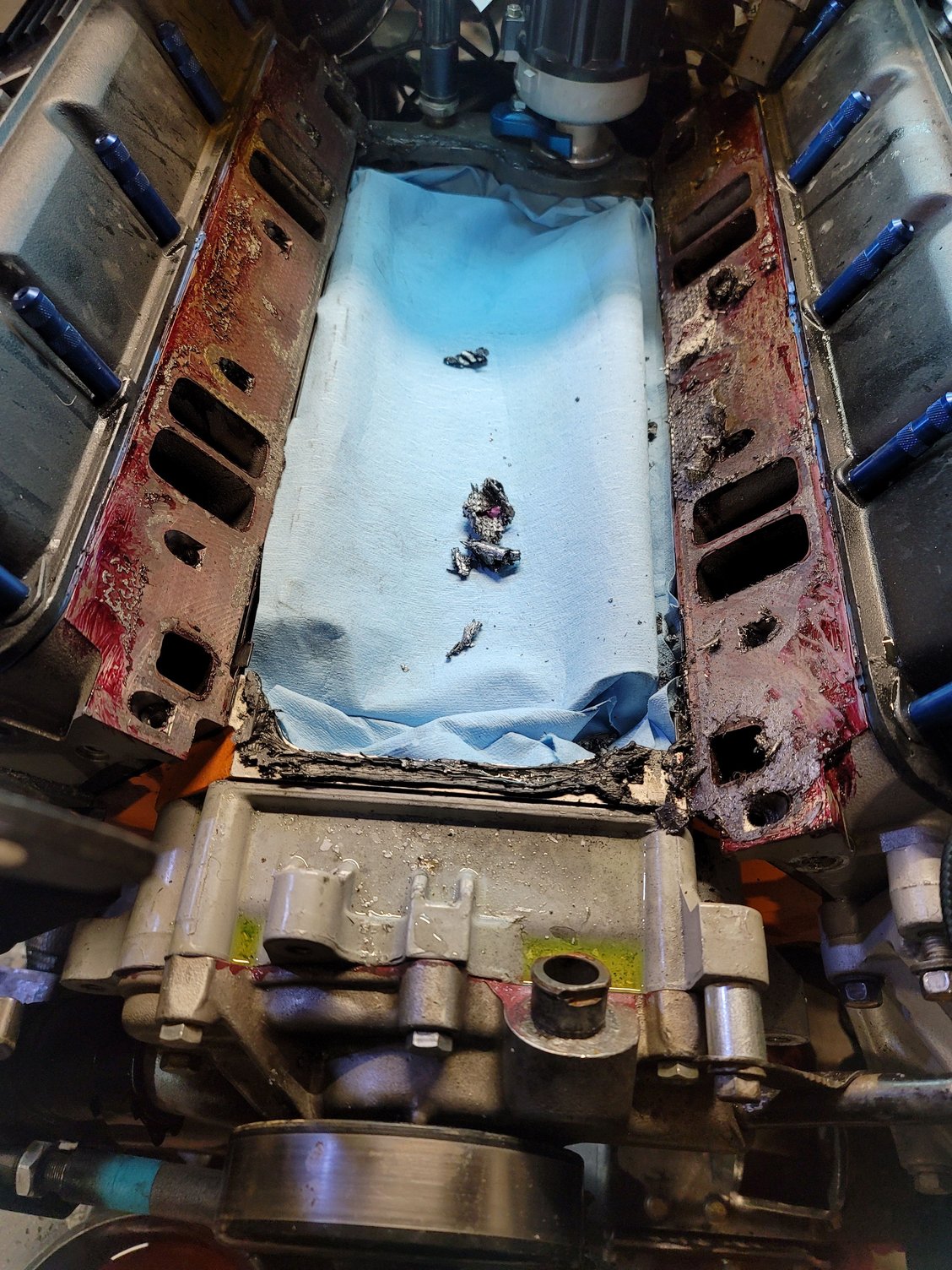

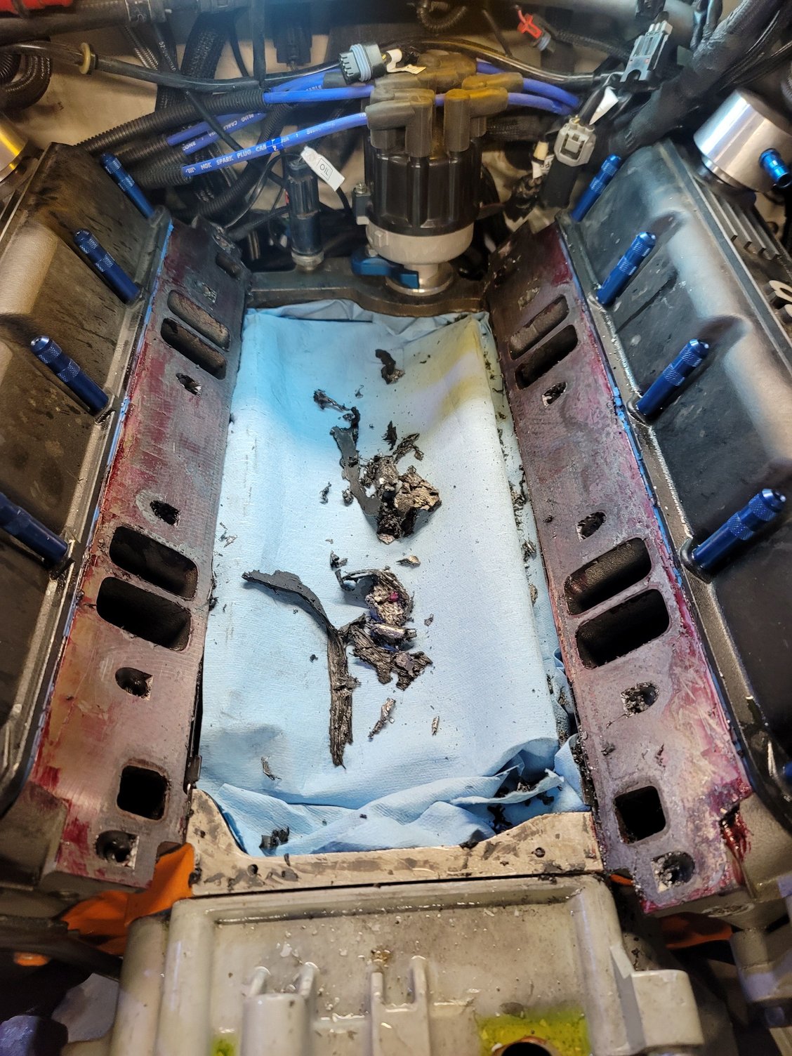

What a mess to clean up.
But I scrapped it clean.

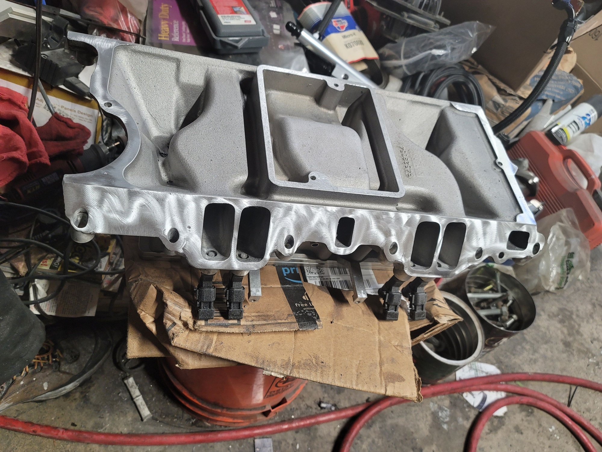

Then cleaned up the intake manifold also.

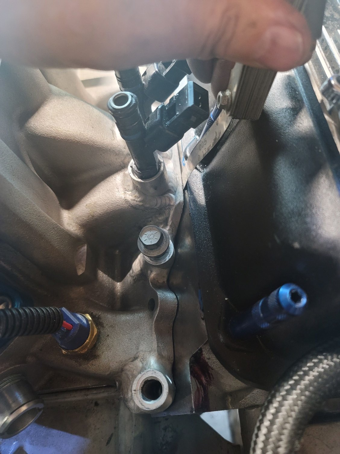

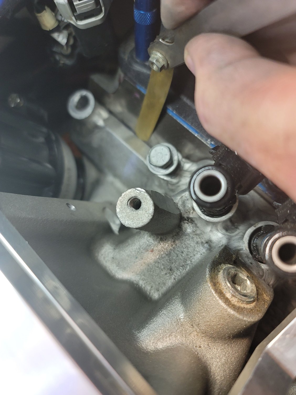

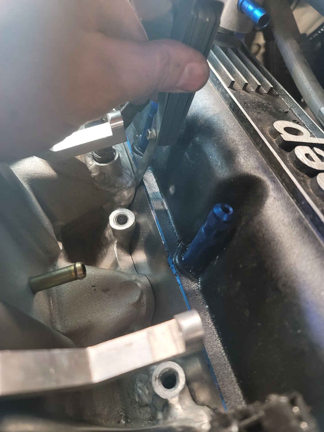

I took the throttle bodies off to make it easier to work with and set it on the engine to check for warpage.

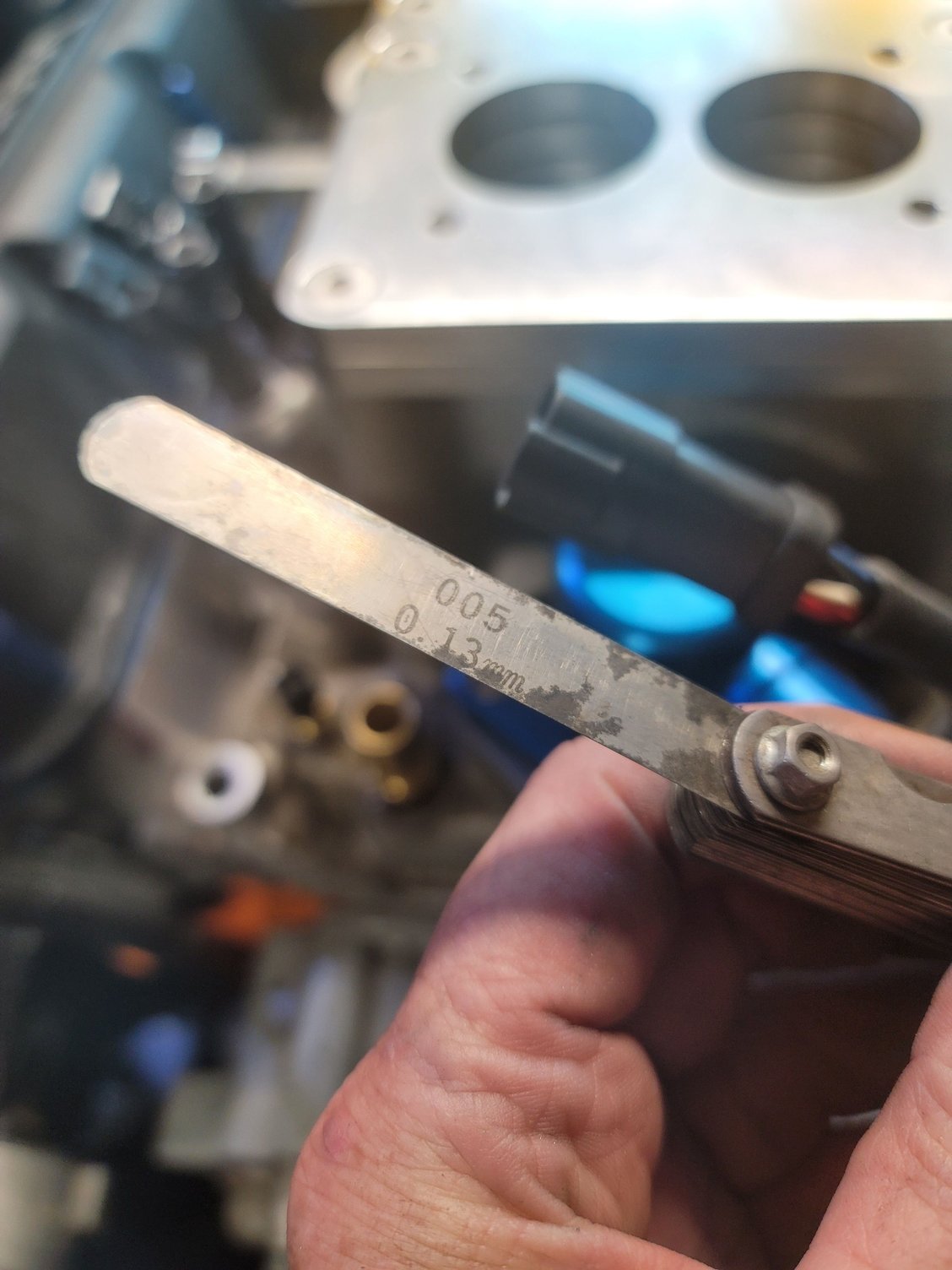

0.005 feeler gauge all around the intake. It would slide in under the intake but I felt resistance.
Then moved up to a 0.10 feeler gauge to see what happened.
It wouldn't slide under the intake.
