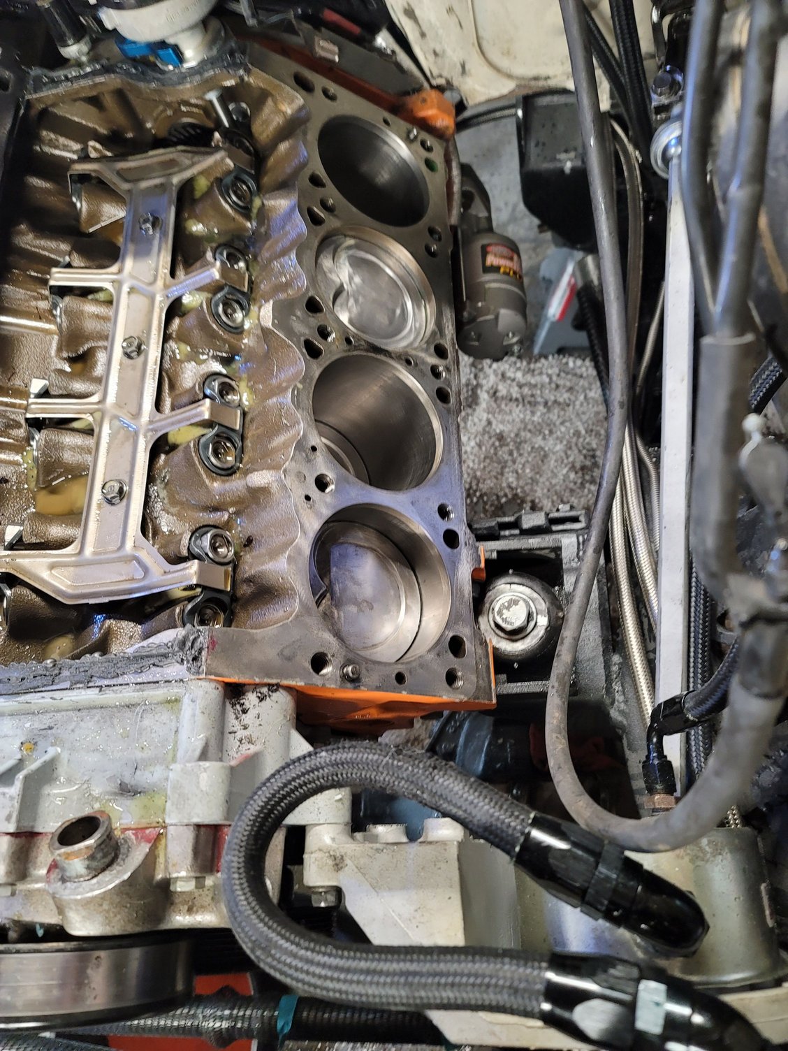

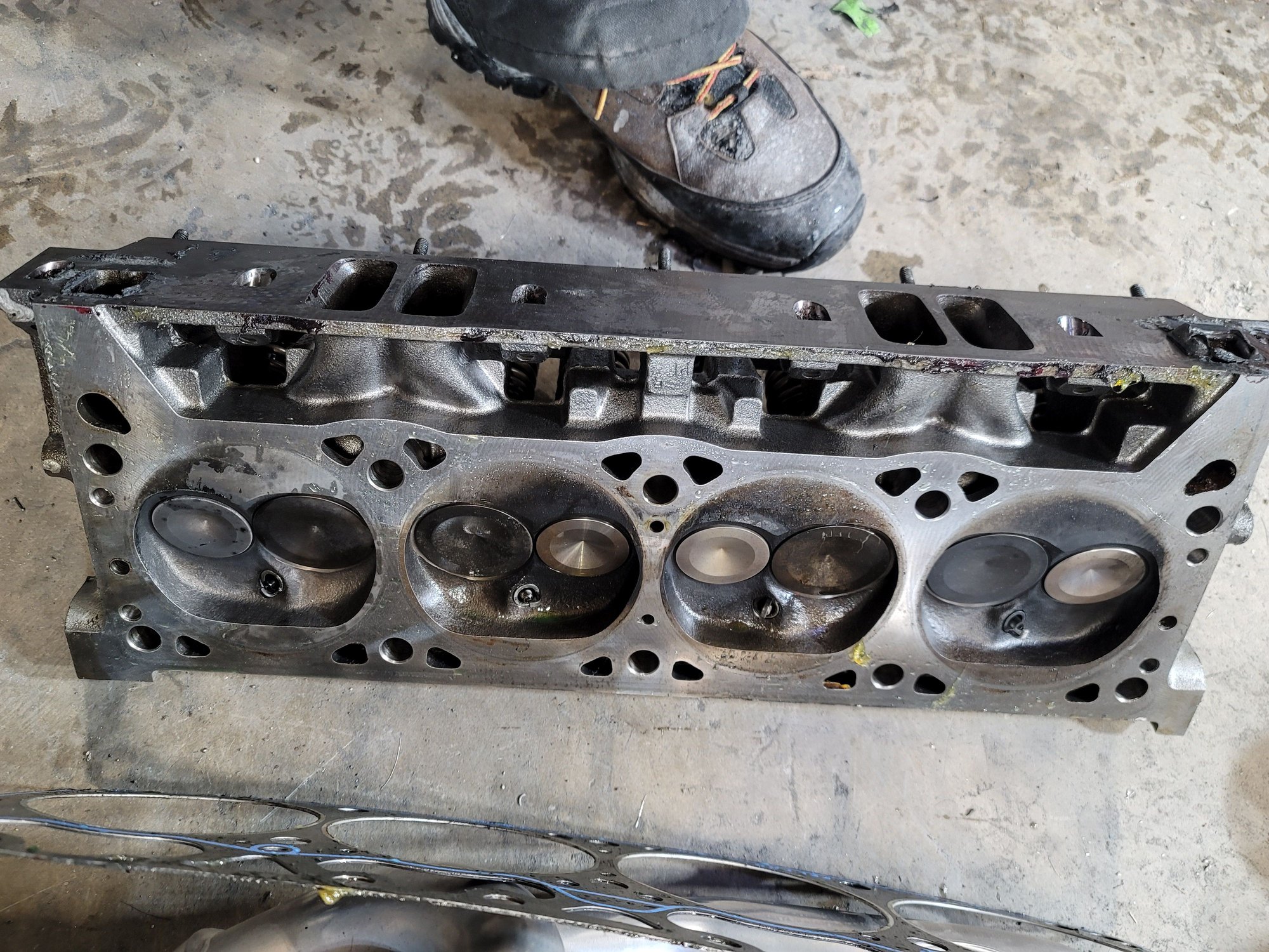

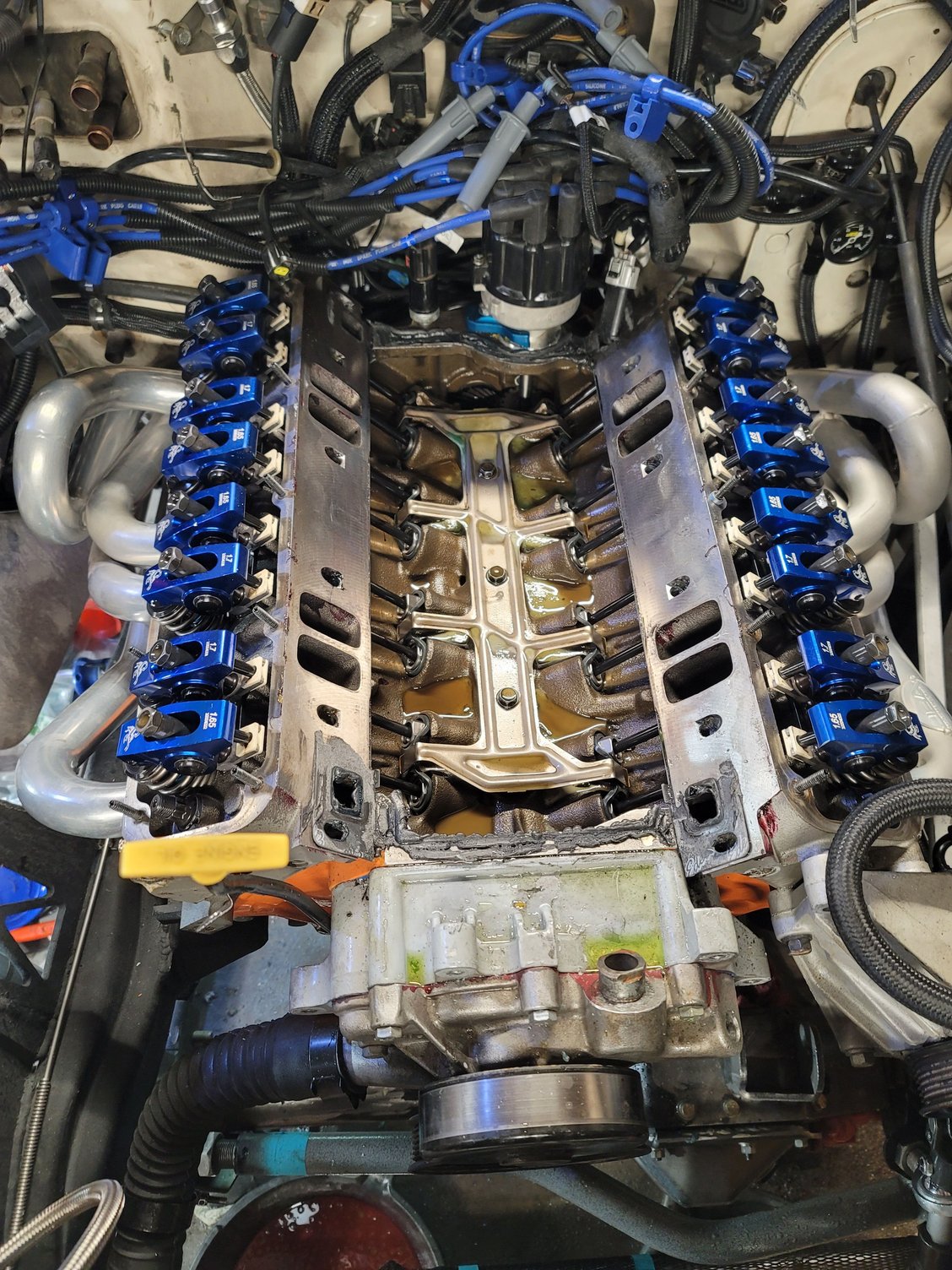

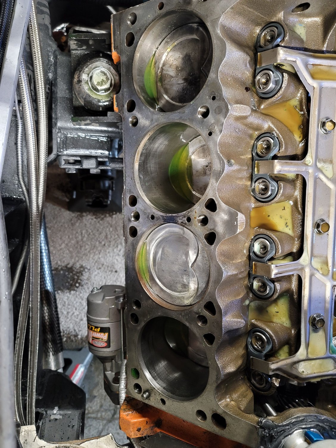

Ok, Good News is that so far I haven't found any damage to the heads or block. I've got the drivers side head off and it was an assembly fault or something I'd done wrong during assembly. The combustion chambers all look good on the drivers head but now my problem is that the passenger side head is STUCK on the block & I can't get it off. I've tried using a pry bar and had no luck so then I smacked it a few times with a dead blow hammer and it's still stuck on the block. I'll try some other things in the morning but looking for any suggestions on good ways to get a stuck head off. I'll post some pictures once they finish downloading.

Might try to carefully wedge a flat head screwdriver in between the head and the block around the head gasket. This of course, after double and triple checking that all of the head bolts have been removed.. You did use head bolts and not head studs, correct? If head studs, they should all be removed, too.
I used head studs and they have been removed. I've tried to use a pry bar with the head under the edge of the head prying against the block.
You can see where the head gasket had blown between #3 and #5 cylinders.
Head looks OK
All 5 upper studs are removed
All 4 lower studs are removed
But that head is stuck on there, Will work on it again tomorrow and try to get it removed.

Stick a pry bar of some sort (I use the round tube jack handles for my bottle jack) carefully into an intake and an exhaust port, then 'wiggle' the head. Likely its stuck on the alignment dowel pins.
