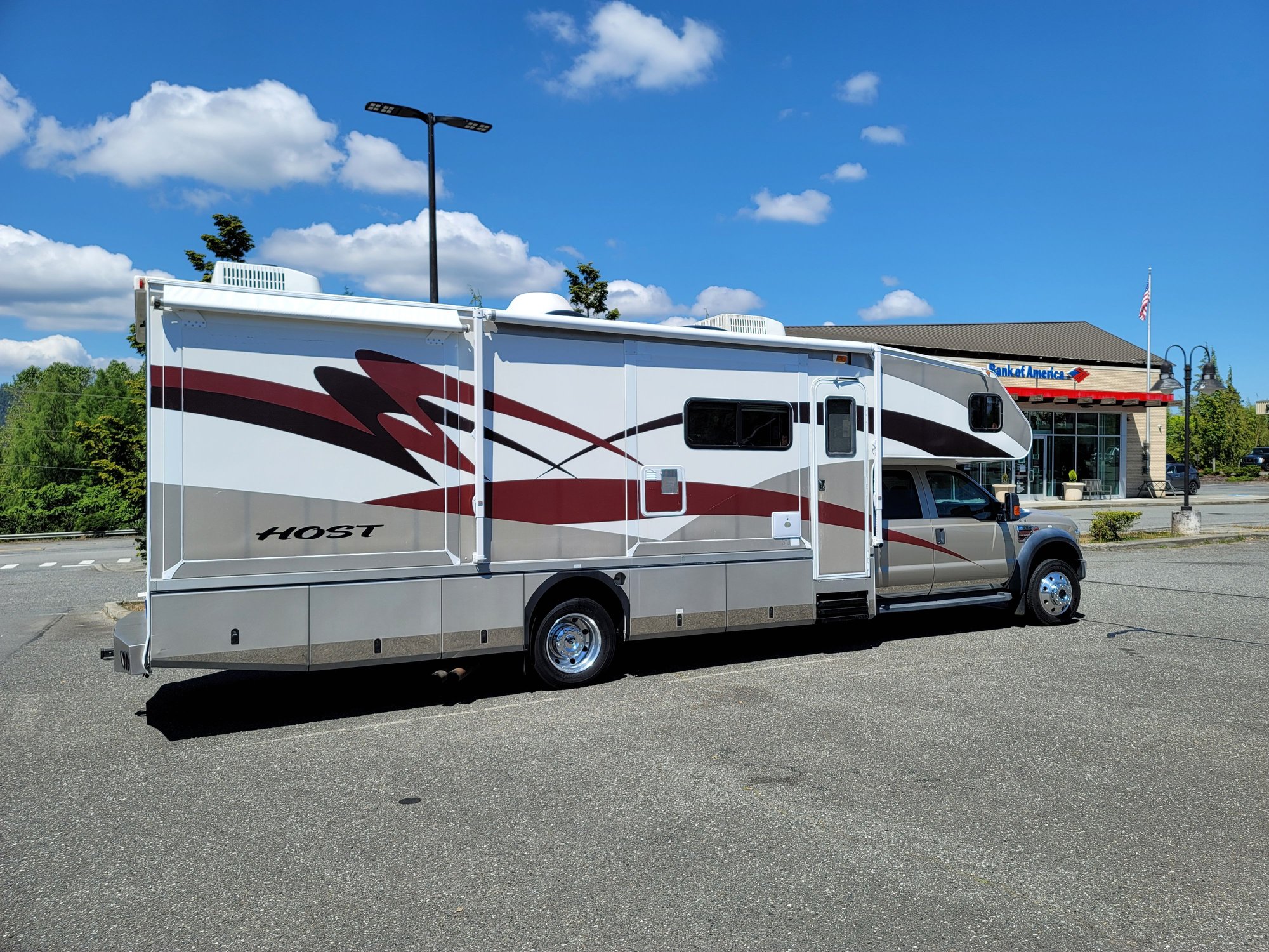

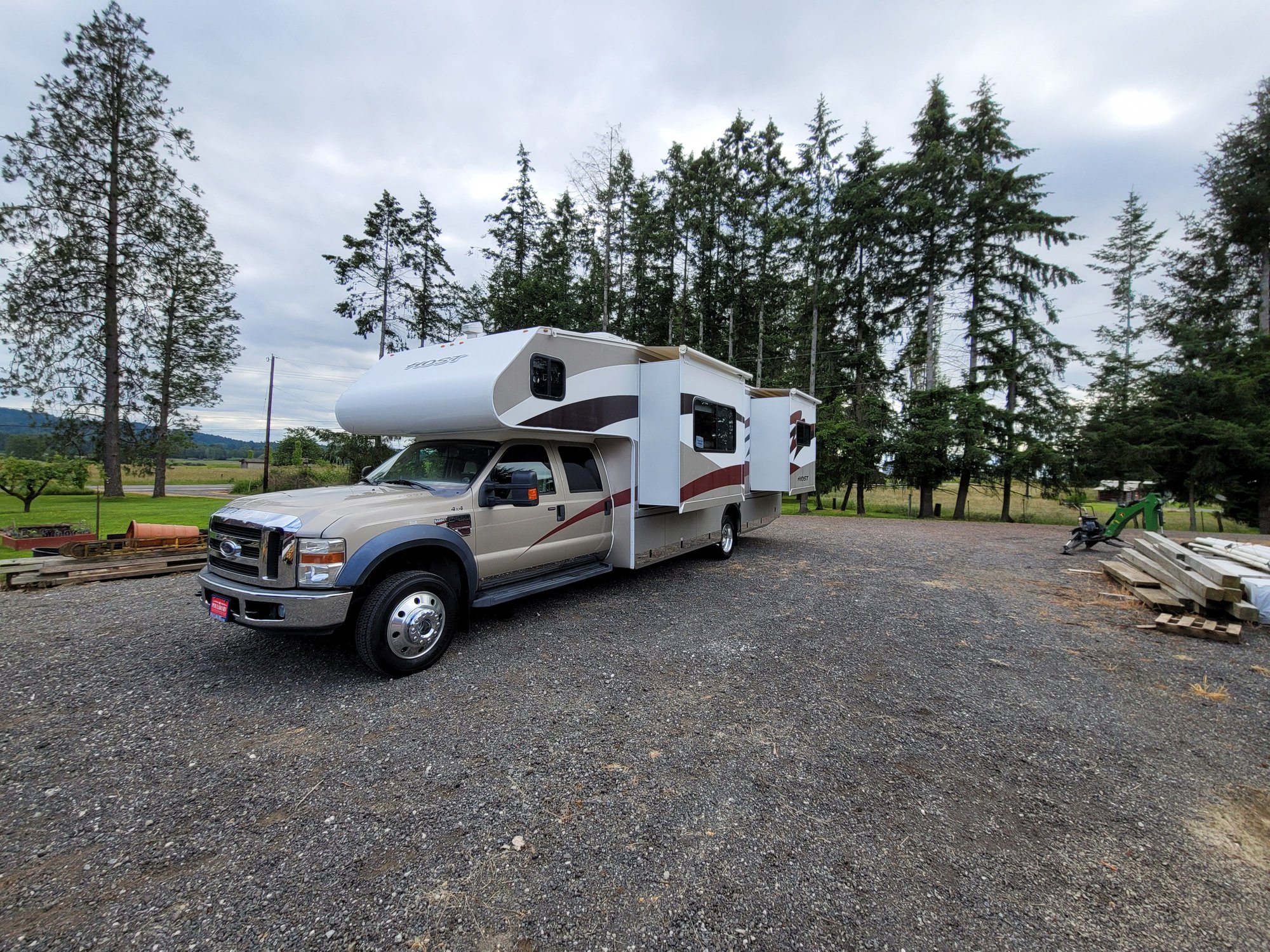

I also got another project this summer but it's to meet my goal of traveling and towing the Jeep with me. I traded my Ram 3500 dually in on it.
2008 Ford 550 4x4 Host Quad slide motorhome 35' long.
This thing is huge inside.
And Host is a primer camper manufacturer so I was glad to be able to find one.
This is at my sister farm outside of Snohomish, WA
Had to stop and show it off to her.

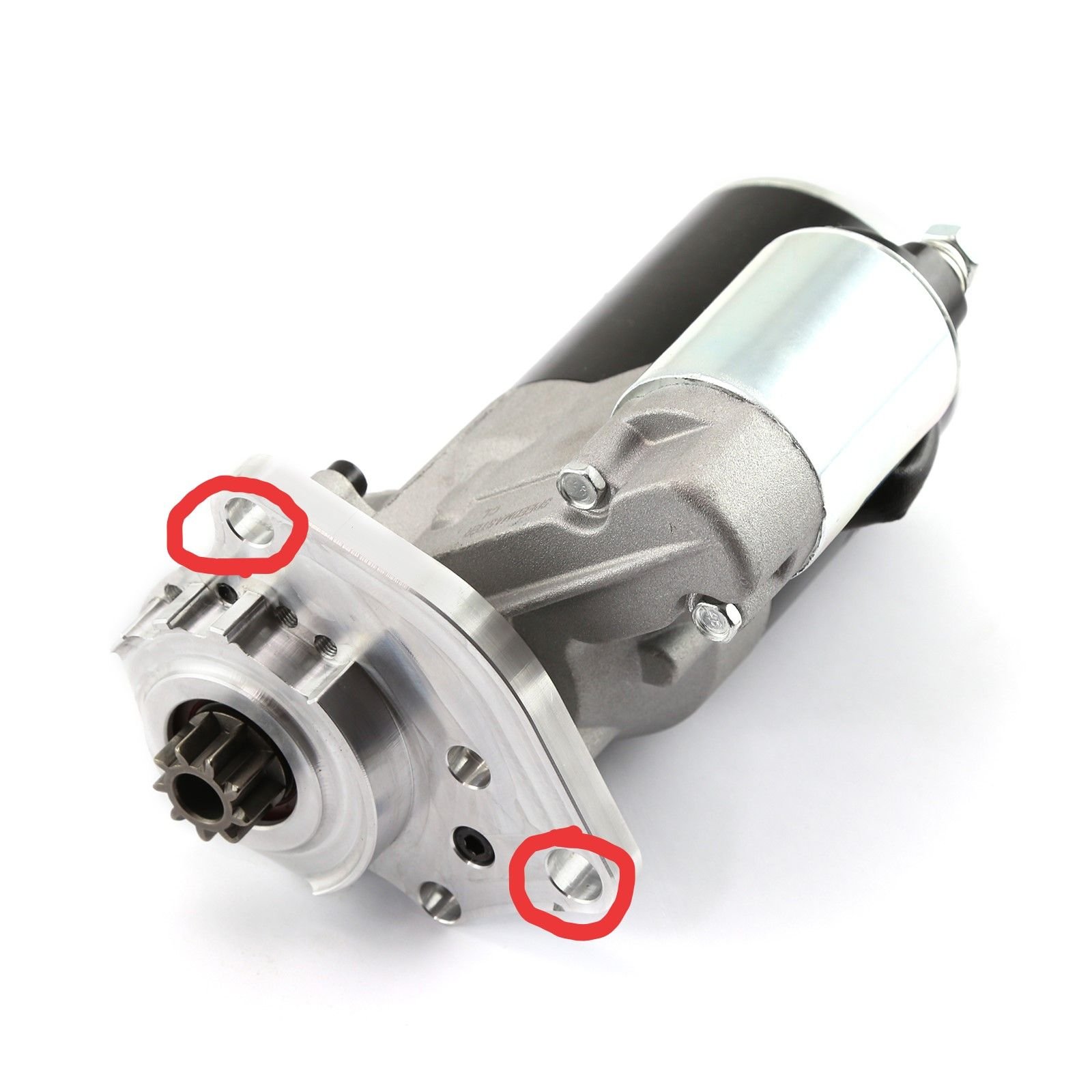

Found a different starter that looks to be smaller with a smaller footprint and looks like you can clock it also.
PCEŽ Starter PCE393.1036 | Buy Direct with Fast Shipping (speedmaster79.com)

Are the mounts right though? Thought it was just two, and all were inline with the starter drive gear.....
I thought it was these two holes for mounting. Honestly missed the other hole somehow. We'll see if it fits & works or not.
They offer another starter but it's out of stock right now.
PCEŽ Starter PCE393.1013 | Buy Direct with Fast Shipping (speedmaster79.com)
