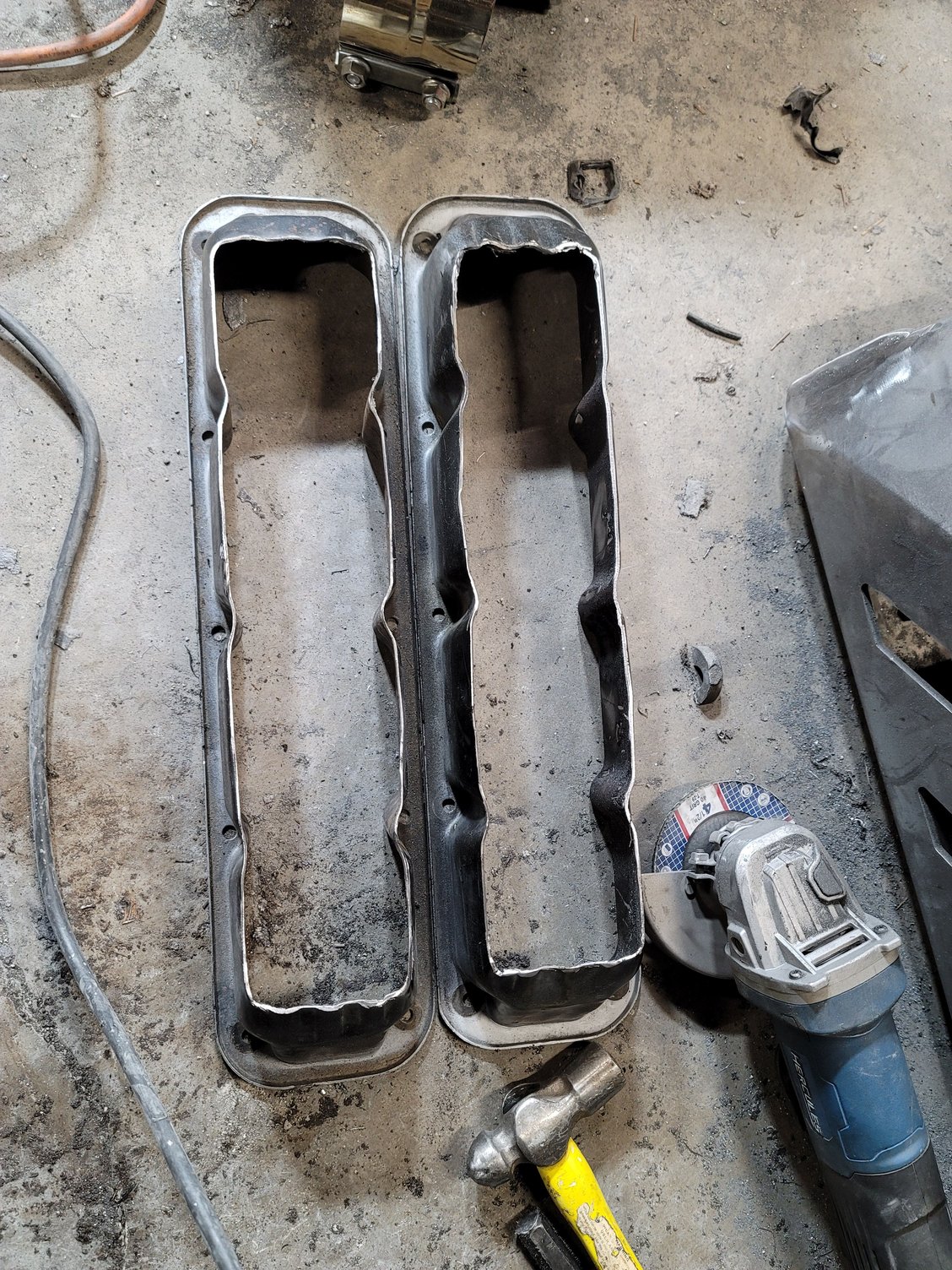

Yeah, is it just me, or is it more prevalent on the passenger side?
Topping the old valve covers should work pretty good. Same procedure as on the chevys.
Yes I seem to hear it more on the passenger side over the drivers side also. But I'll pull both covers & adjust all of them while I'm at it.

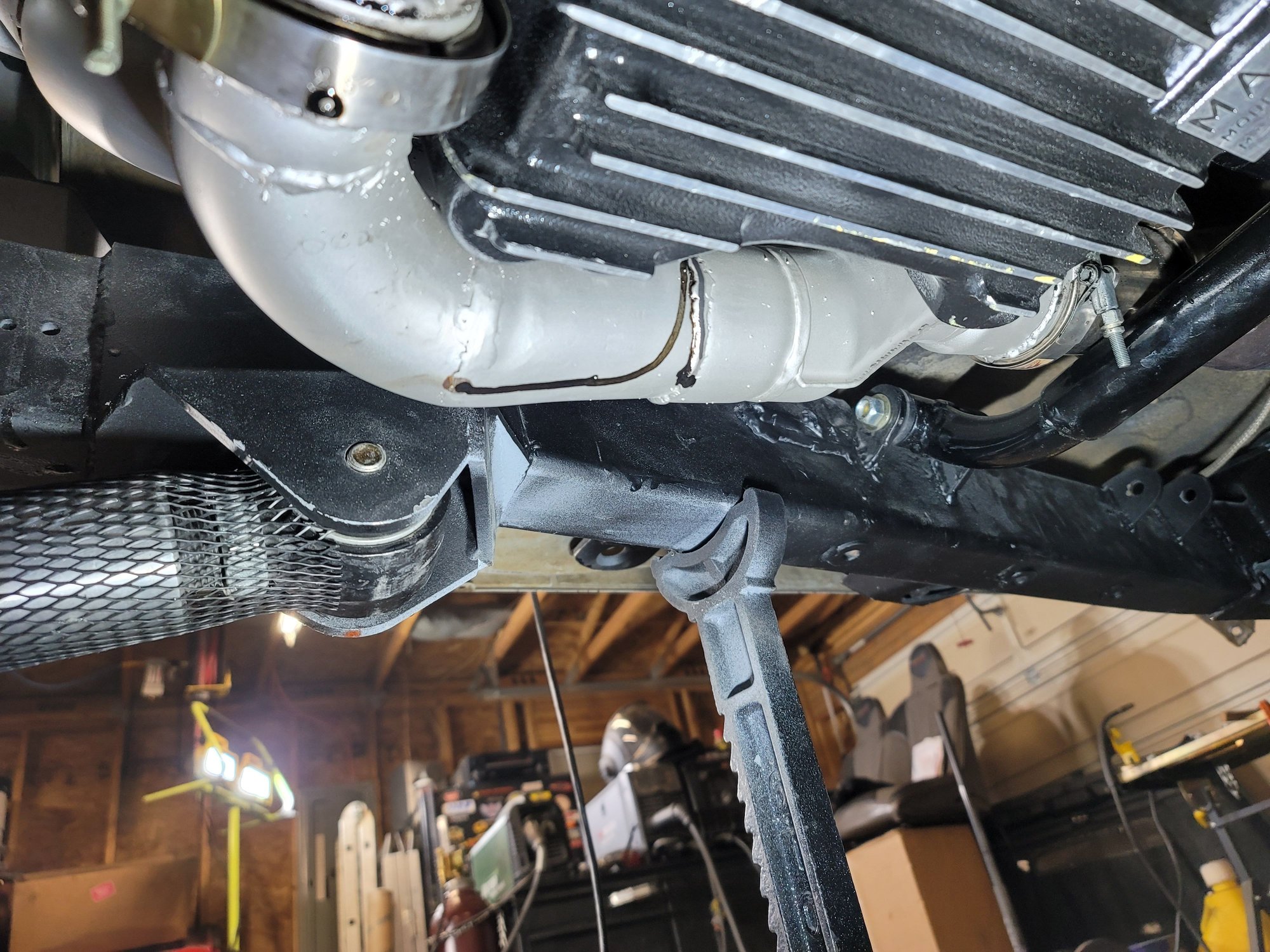

Man this rebuilt engine just seems to be kicking my BUTT.....
Now I've got oil being blown into the exhaust and I'm not sure as to why or how yet.
One suggestion I've gotten was to check for too much crankcase pressure? Any other thoughts or ideas?

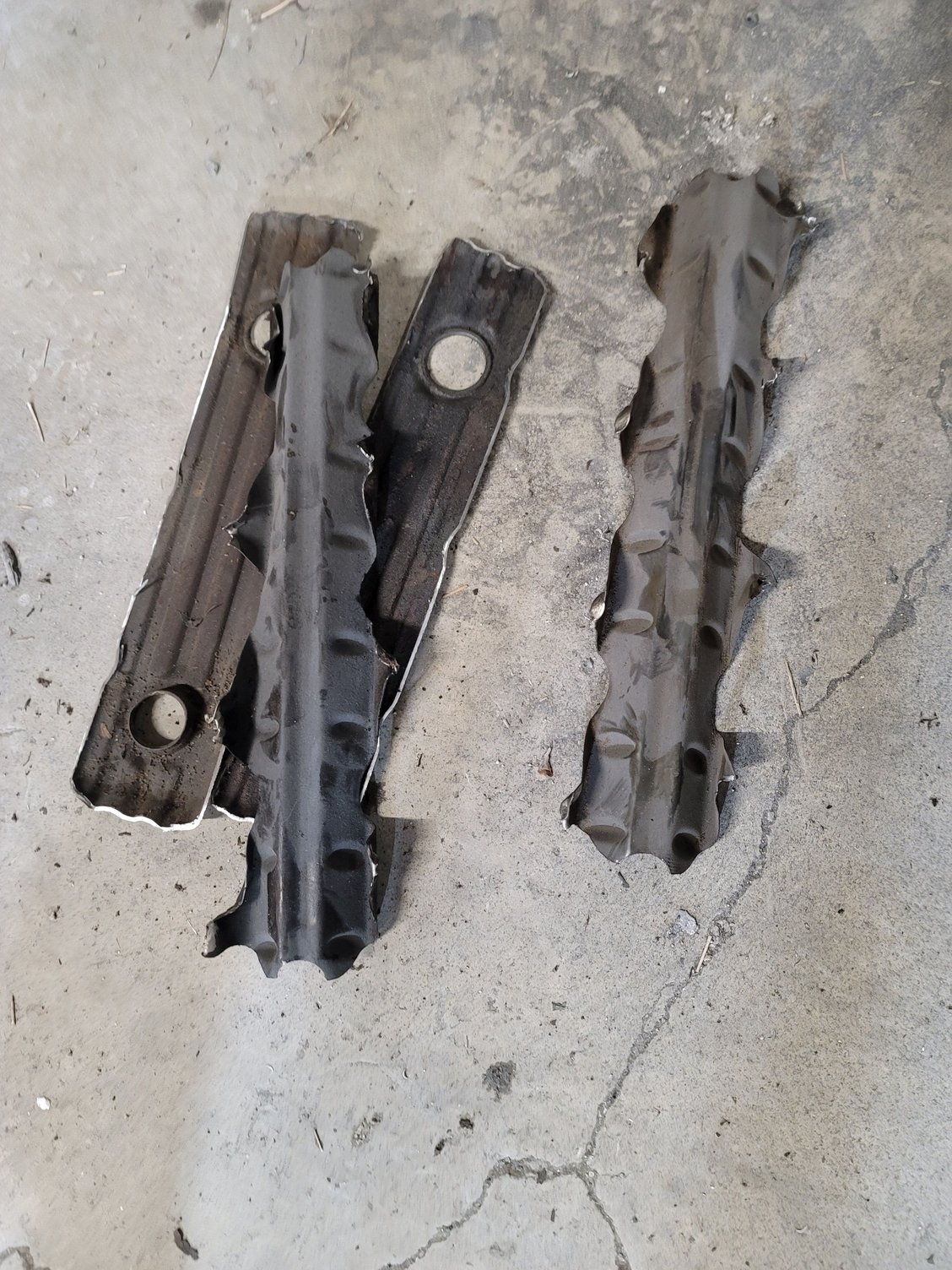

Got my old set of valve covers cut up and ready to install tomorrow and hopefully get the rockers adjusted properly.
Had to remove the baffles from inside the covers too.

That seems like a lotta oil leaking out there...... Got some pinholes in the exhaust?
Everything on that motor is new...... and I can't think of where that much oil could possibly be coming from. I suppose it wouldn't hurt to check crankcase pressure, and see what it says. Ideally, there should be a bit of vacuum on the crankcase at idle.
Yep I've got some pin holes in my exhaust that need to be fixed. I was totally BUMMED about that.
I honestly can't figure out where that oil is coming from. The crankcase pressure is normal so that isn't the problem. It's something else but I don't know why. Right now I've decided to just not worry about it but instead get the rest of the Jeep put back together so I can drive it and then figure out what is happening.
