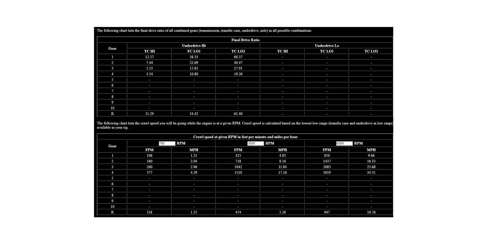

So, 5000 RPM at 2 MPH? Or will it even go that fast?
Here ya go. Gear Ratio Calculator (grimmjeeper.com)
