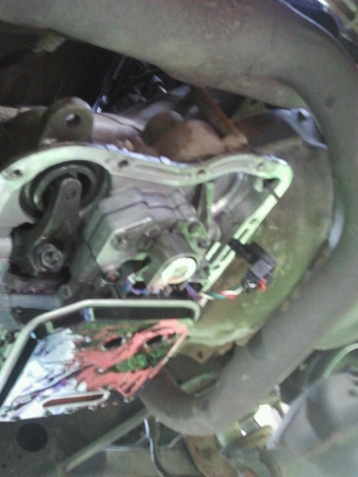

dropped the pan, and this is what i found.....
this is a 98 transmission..... is that block different in the 2001 models, so the transducer fits differently?
the transducer that i took out had a clip on the inside holding it in. new transducer doesnt go far enough in the block to use said clip.
Old Jul 16, 2012 | 07:19 PM
Posts: 87,563
Likes: 4,232
Yes, they are different from 98 to 01. I think ya just found your problem.
