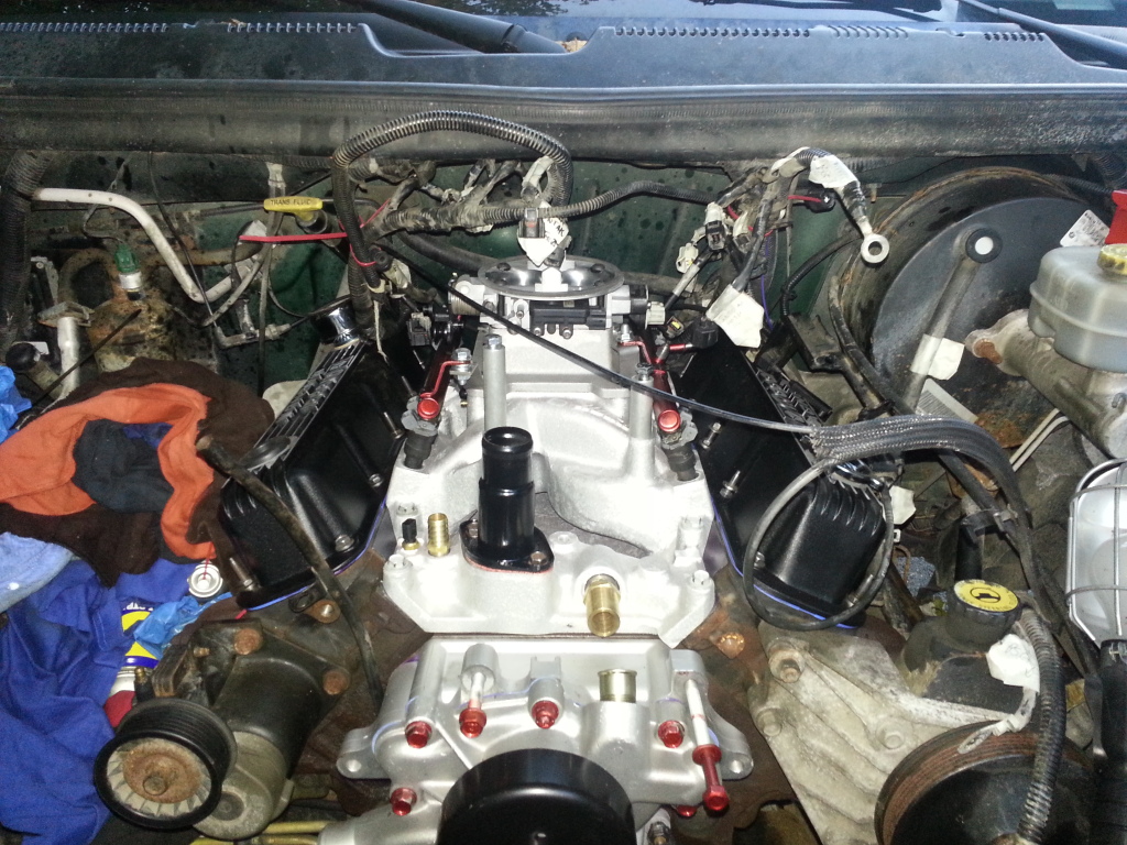

Got this done tonight...

Looks purtty..is that a rusty pump pulley over there?

im looking to do this soon. well the plenum at least. have you taken it for a ride and noticed any improvements?
Shhhhh! You see nutttiiinnnnggg! ;o)
I have to pull that, clearly, and clean it up. Still a LOT of cleaning up to do.
Brian,
It's not together yet... what you see in that picture is literally how it looks. So nope...
InfO.

Looking nice! Mind if I ask what you are using for that red paint?

It's an anodized red paint, but I'm not recommending it. Despite sand blasting, sanding, priming, ground coating, then painting, then clear coating... they chip like no tomorrow. It'll all go in for powder coating in time, but I need my truck back like... a month ago.
On a side note - suggestions on getting the harmonic balancer back on easily? I'm thinking of just using an impact gun on the bolt to force it back in. thoughts?
