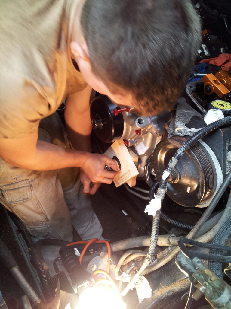

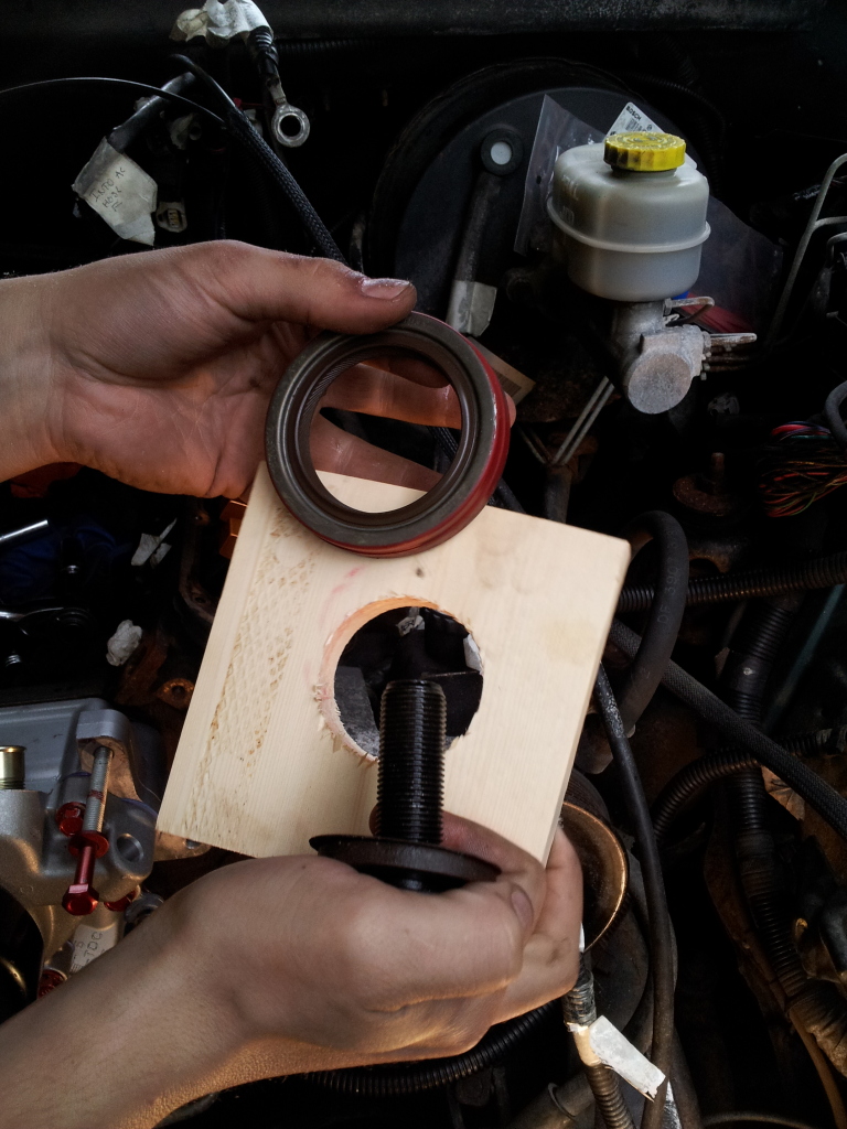

Girlfriend came up with an ingenious way to get the front main seal in:

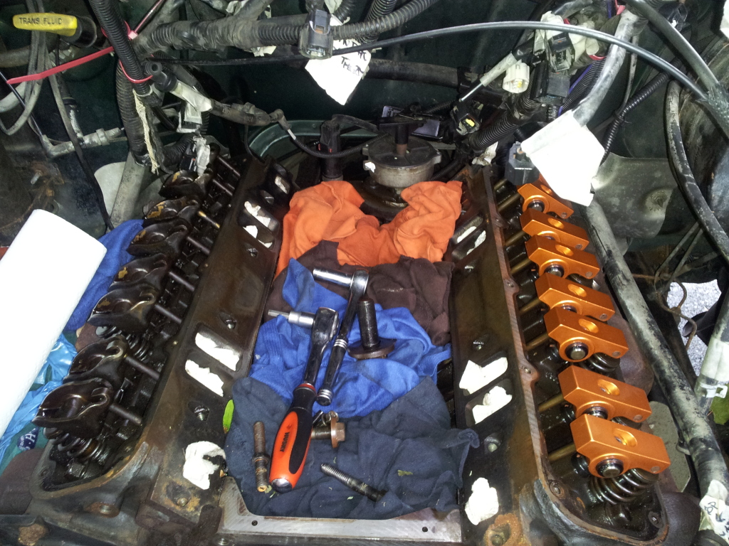

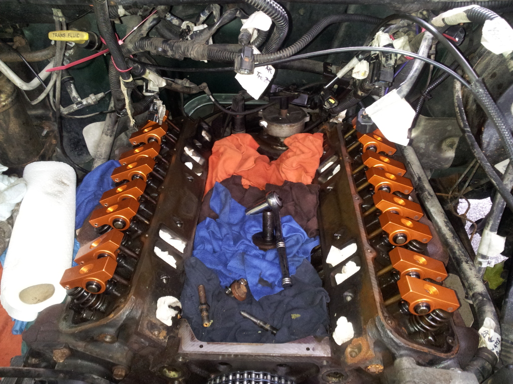

Changed over to the HS Roller Rockers. Tossed on the valve covers. ****ed up 2 of the bolts by over tightening and stripping them. I'll sort that out later, tap it and go from there.

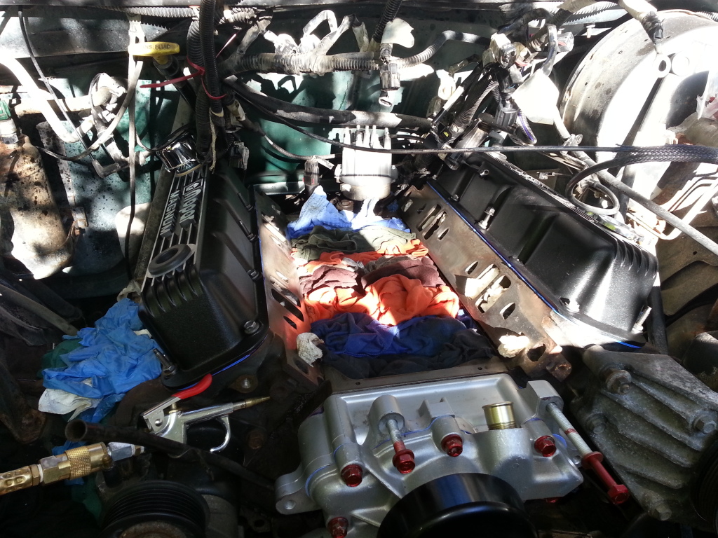

Worked on the fuel injectors, fuel rails and the cross over line. I gotta say... using barbs instead of just some sort of clamp is, in my opinion, the dumbest **** ever. And is now resulting in me needing to find another cross over line as the one I was supplied with in the FI Air Gap kit became pretty kinked when I tried getting it onto the second rail. At that point, decided to shut it down.
Just need to force the balancer back on and add some more things... and should be close to the time when I turn the key and nothing starts
