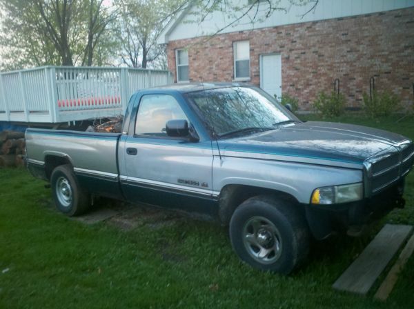

Hi, new to forum. I bought a 95 ram 1500 regular cab with a 5.2 engine, 2wheel drive. I knew this truck was going to be a project when i bought it. It's turning out to be more of a project then I have skills, time, and money for. Iv'e fixed a lot of things and thought I'd have the truck up and running by now. Run into problems with the cooling system. I have replaced the water pump, tensioner pully, belt, thermostat(twice), radiator, tempeture switch, tempeture sensor, heater hoses, upper and lower radiator hoses. I still got problems. Tempeture gage rides up on high, 260 but doesn't go into the red zone. The engine runs rough and kinda back fires (really weak back fire). Upper hose gets hot and hard. the radiater cap doesn't get hot. Just pulled the spark plugs and had 2 that where clean and wet, couldn't tell if it was from anti freeze or not. Always get smoke out of tail pipe on start up, sometimes goes away once warmed up. Weird smell from exhaust and in side of cab, not sure if from anti freeze or not. I'm looking into replacing the head gasket(the one with the 2 clean spark plugs). I've never done this before, is this something some one can do with limited mechanical skills can do? I'm a machinist by trade not a mechanic. I just downed the repair manual from this site. Very nice thanks. What is the
