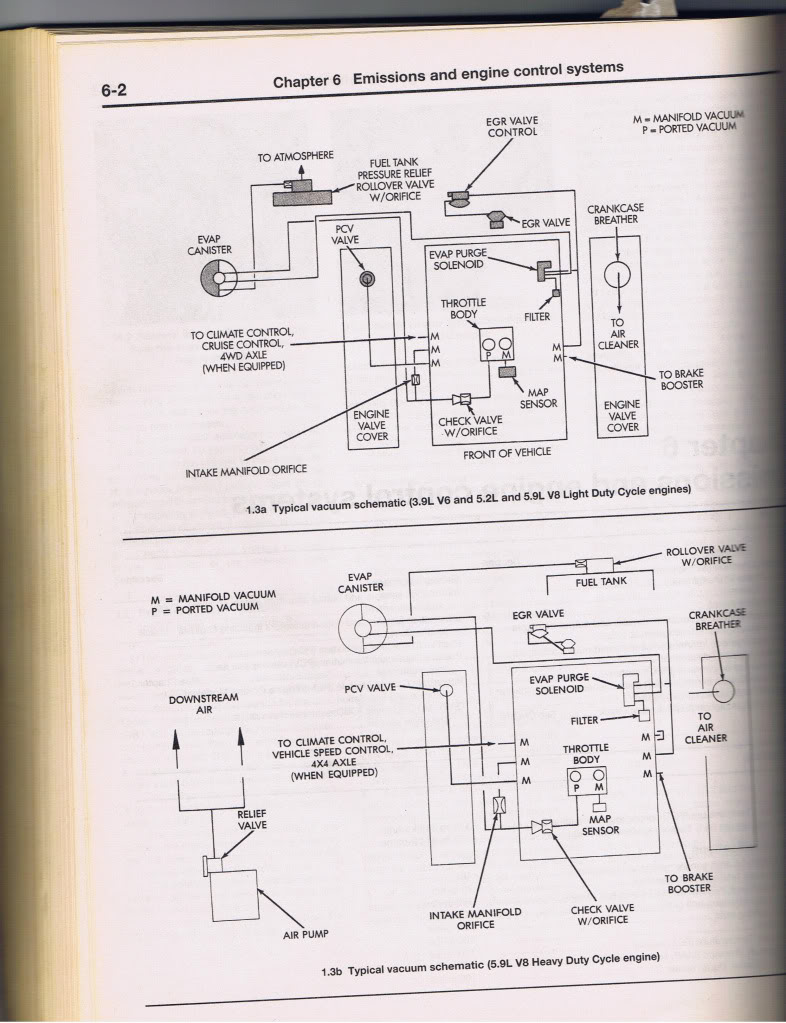

Ok I just changed all the plugs and wires. The order was correct before, and it is now as well. Still missing. I checked every plug for spark, and they all are sparking. Could it be something as small as a vaccum line? Im hoping its not injectors, i dont feel like messing with them lol. I dont have any broken vaccum lines, and I think I have them hooked up right, where a bunch of them meet on the left side of the intake, but i am not 100% for sure. I cant find any pics of how they should be exactly

No, its all the way through. Any idea where I could find a picture of how the vaccum lines run. Cant find it in my haynes manual either

And I hooked the vaccum lines up how they were on my 5.2, would they be any different on a 5.9?

Posts: 87,563
Likes: 4,232
Nope. exactly the same.

I dont. No codes are being thrown. I found a diagram of the vaccum and I have it hooked up right. How would I know which one is missing?

Here
You have a DVM?
