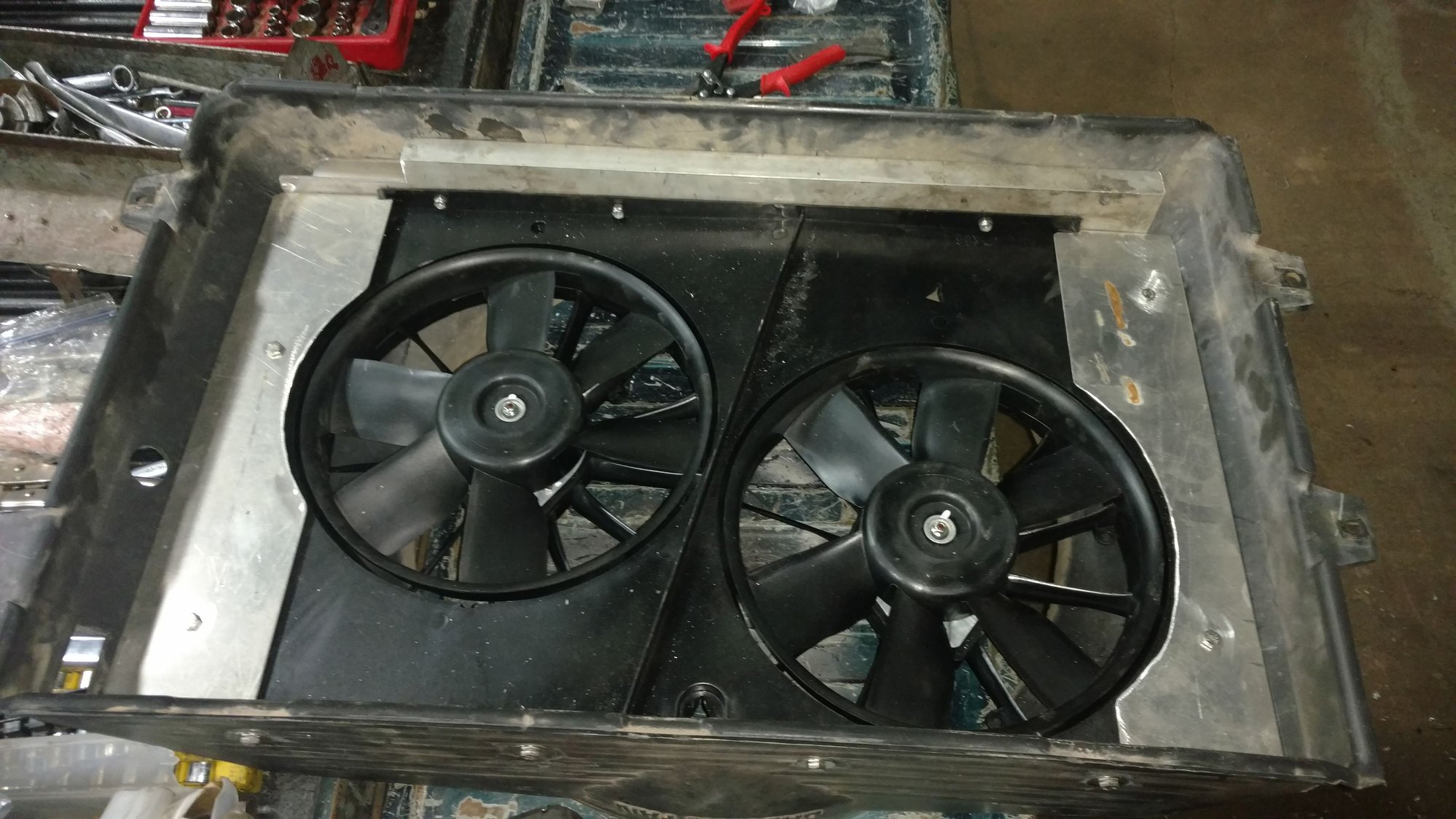

How did you mount the left and right side fan brackets to the fan should? Did you use the L brackets on the side also ?
Old Mar 11, 2018 | 11:22 PM
  #40
2bit's Avatar
2bit
Joined: Jul 2014
Posts: 1,362
Likes: 35
From: Wisconsin
Hard to tell it's not factory.
Fits nice with a 1x2 piece of aluminum between it and the shroud.
