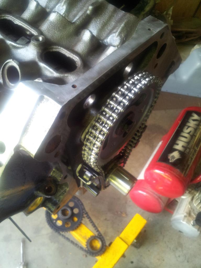

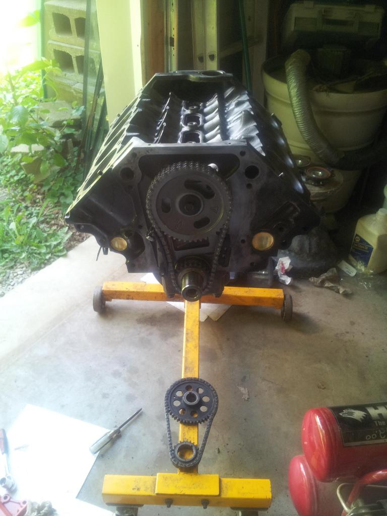

Ok, I just got all my parts in and I spent the morning out there, here is my progress so far

New Timing Chain and Gear (double roller chain and tensioner)
[IMG][/IMG]
Chain Again
[IMG][/IMG]
The shop checked all my clearances for me, I double checked this morning. Go more to do, and have a few questions I'll post here later today!

Old Jun 14, 2013 | 04:50 PM
  #39
aofarrell2's Avatar
aofarrell2
Joined: Jun 2012
Posts: 3,096
From: Iowa
Looks good!
