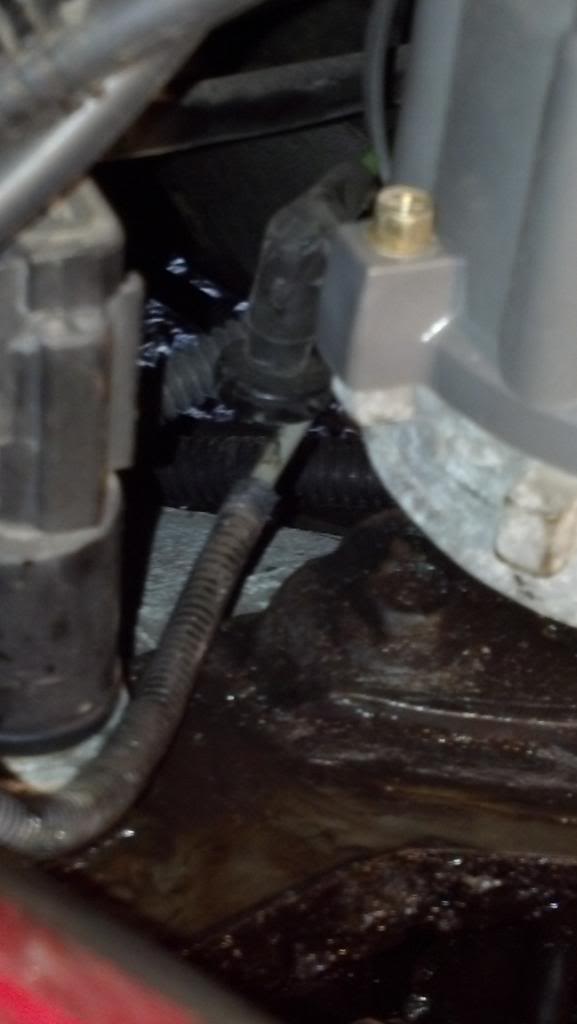

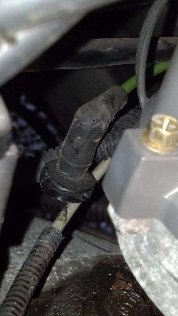

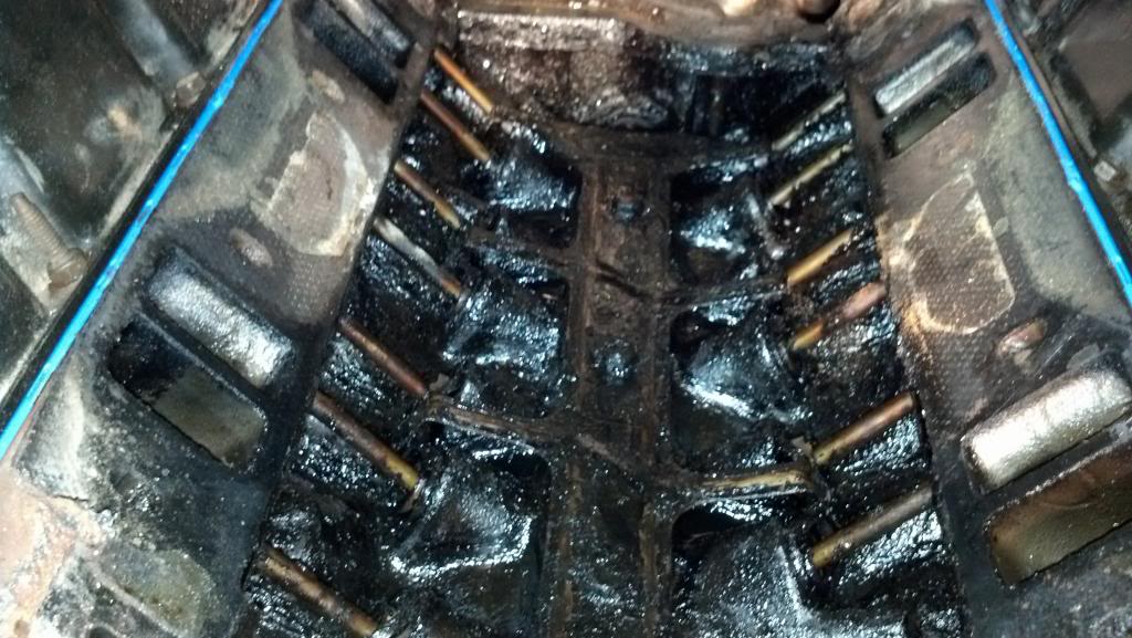

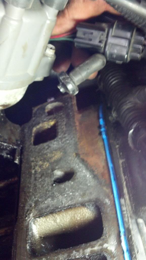

while I was cleaning under the intake I found a loose vac line. followed it the best I could and it goes from the transfer case (top, driver side) up to the engine bay. it stops right behind the dizzy. (see pics).
I just have no clue where it is supposed to go to from there. I honestly don't have time today to read thru vac line diagrams and stuff so im kinda hoping that someone can save me some time if they know where its supposed to connect to.
wait to you guys see all the crap I gathered from cleaning this engine out. pic of that to come. still got some cleaning and finishing up before I reinstall everything.

That green line is supposed to go to nothing.
thanks, im guessing its a vent then?

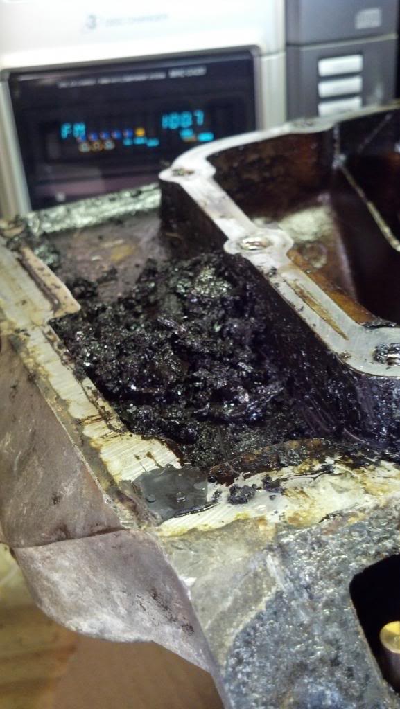

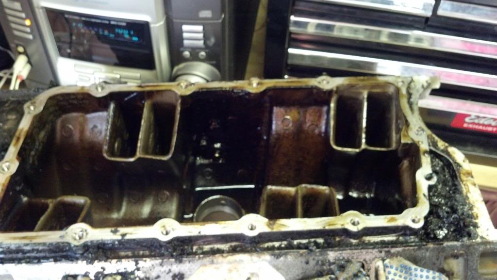

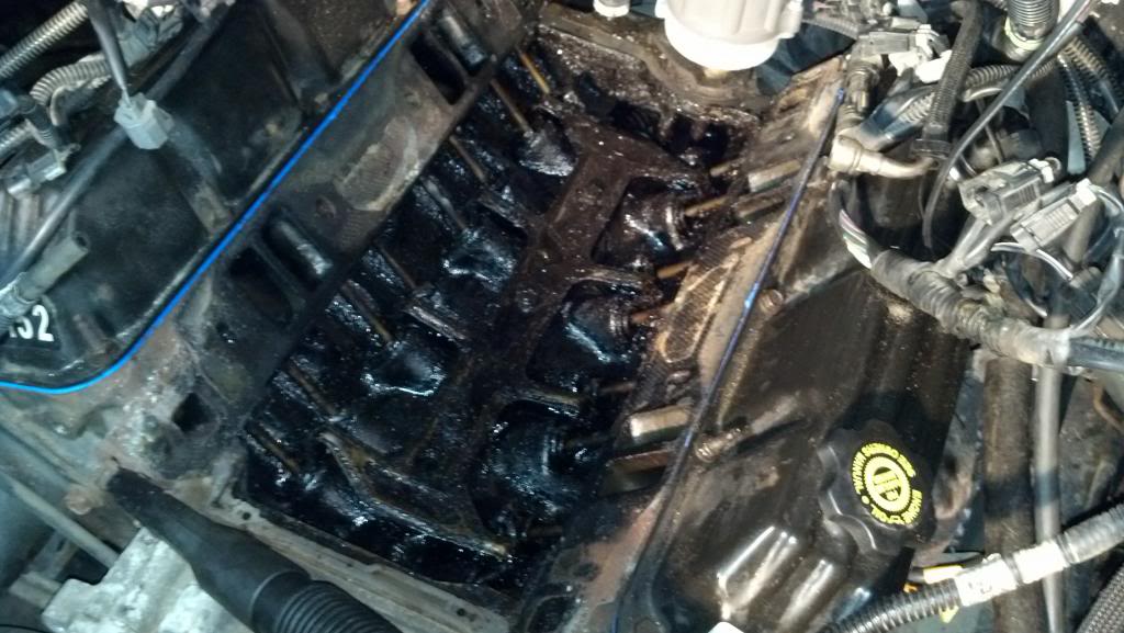

heres some pics that I just uploaded. more to come..

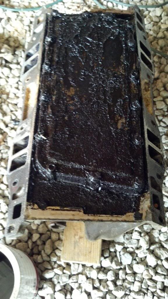

few more....

Old May 19, 2013 | 09:42 PM
  #36
stewie01's Avatar
stewie01
Joined: Mar 2011
Posts: 8,914

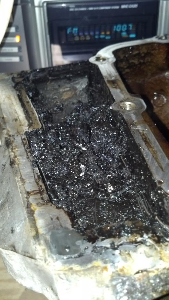

That is some truly nasty crap man...

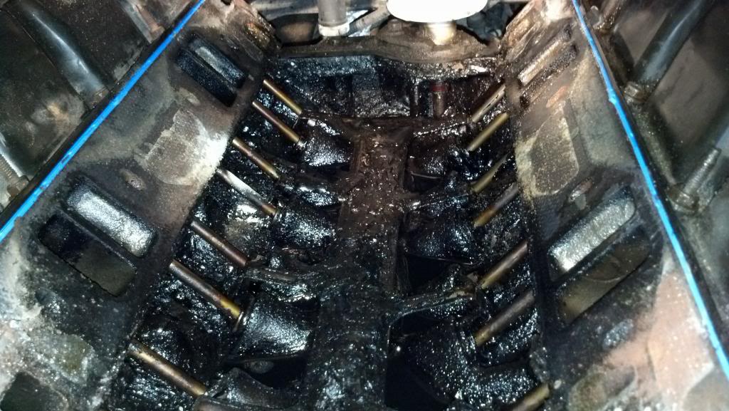

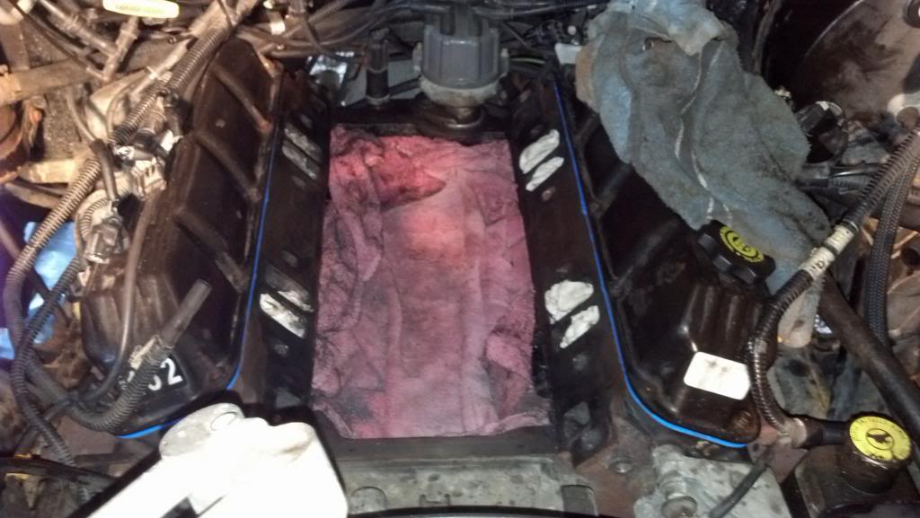

sure is bud. hopefully this and a few seafoam treatments and oil changes will clean her out better I got all I could out, but I know there is some hidden of course. I will be going back in before too long to check everything out after treatments. hope she appreciates it.
on with the last of the pics (for now)

as she sits now ^^^... got a little cleaning left and get the surfaces cleaned up really good and start tossing stuff back on..
Old May 19, 2013 | 11:14 PM
  #38
dodge dude94's Avatar
dodge dude94
Banned Goober Smoocher
Joined: Jun 2010
Posts: 8,916
This is the worst I've ever seen on this forum.
I think the thread title should be renamed to: THE TRUE TESTAMENT TO THE AWESOMENESS OF THE DODGE MAGNUM ENGINE.
I think that would be great. You might consider taking it to a shop and having them do a oil flush on it, depending on how deep your pockets are, it might be easier. That is nasty.

oil flush is not necessary from what it looks like it is not actually that bad some sea foam or atf in the oil will clean it right out
op it may be in your interest to do the cap and rotor while its easy to get to
Old May 20, 2013 | 12:46 AM
  #40
Wh1t3NuKle's Avatar
Wh1t3NuKle
Joined: Sep 2011
Posts: 3,891
Likes: 8
From: NorCal
I agree with Dodge Dude. I'd treat it like oil up sand, but that's just me.
Question about one of the pictures:
Is that the condition currently? As the lifter valley is under the rags?
Are you planning on or have you already taken out the lifters and such? I thought I read that you were going to remove the rockers, pull out the rods, etc.?
I hope you are. As mentioned previously, this granulated looking material would also get to the timing chain area since you've found it in every other nook and cranny. Just something further to consider.
