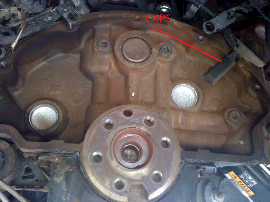

I finally located the crank sensor which stands upright, to the lower/rear/passenger side, of the distributer. I had to unplug the wires on the dist. To get my hands on the sensor. Sadly, get my hand on it was all i could manage. I couldnt get the sensor unplugged at that point. I had to button her back up with out trying the crank sensor trick. As i lick my wounds, i'm thinking of getting a tuner like superchips to fix my pcm. Oh, and cleanning the grounds didnt work for me.

Sounds like you found the oil psi sending unit not the ckps or maybe you did find it.
Anyway I thought this might give you a better idea where to feel for it.
Sorry, took so long for reply but image posting takes me a while here's the sensor I was trying to unplug.
https://www.dropbox.com/s/d43xzdouu4...%2043%20PM.jpg
Old Nov 10, 2013 | 10:07 PM
  #30
Posts: 87,568
Likes: 4,232
Oil pressure sensor. Need to move the red locking tab before it will release.
