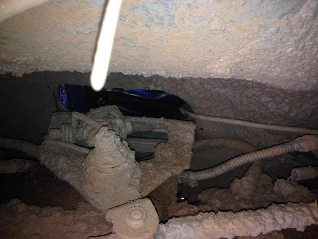

Is this all mud and stuff? Or is it something else ?
