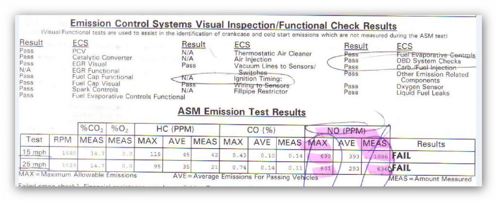

Ok, Finally i have passed emission today! what a relive !
Drove the truck about 4-5 miles to smog shop ,also was raining outside,so weather
was little cooler.
Now , with that said looks like problems did not end!
The guy at the smog said that the "NOx" is still in the high side and
is not really good and to have a look at to fix for the NOx to come down in numbers to "0"
Here are the results from all test:
First test: Failed (3-5-2014)
Sec. test: Failed (3-10-2014)
Today's test : Pass (3-26-2014)
So regarding to the high NOx , what will be a other things to do to get those numbers down?
I Know that for 2 years i am not going to goback to smog ,but i want to make sure the truck runs
better!
Also the guy at the shop that did install the CAT he said that to watch for the cat ,regarding the color
because if the truck eats more gas ,and does not burn it right ,can damage the CAT.
And i am thinking in my head , normally high NOx can come from eating little more gas?!
How about from that Plenumm ? can that have something to do with it? i mean maybe the oil gets into intake
little and then goes into the air system and make the truck to be lazy?! as i fill it little...
Anyway, thank you so much for any advice! and thank you for the help provided till now!
Regards.
