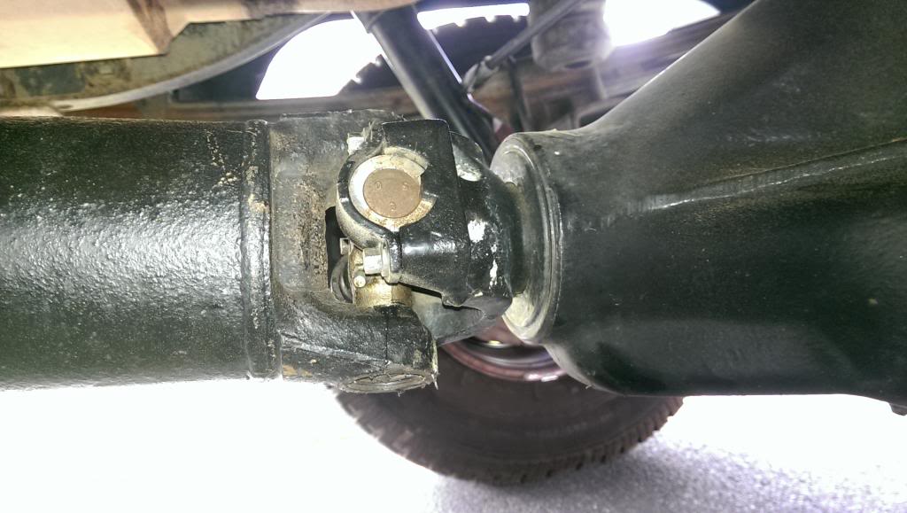

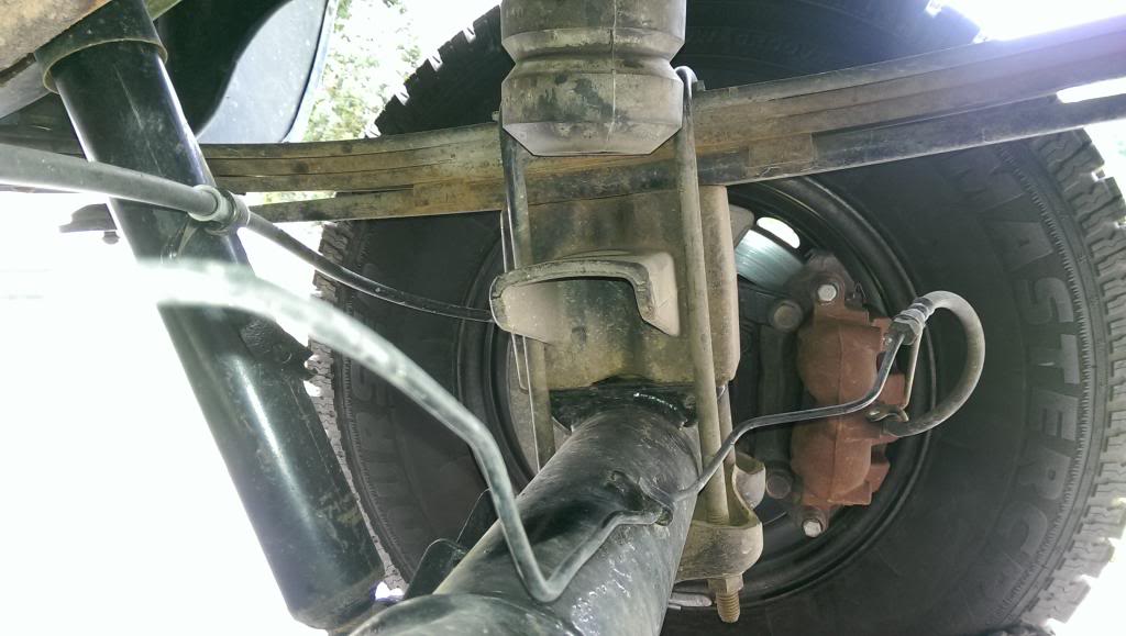

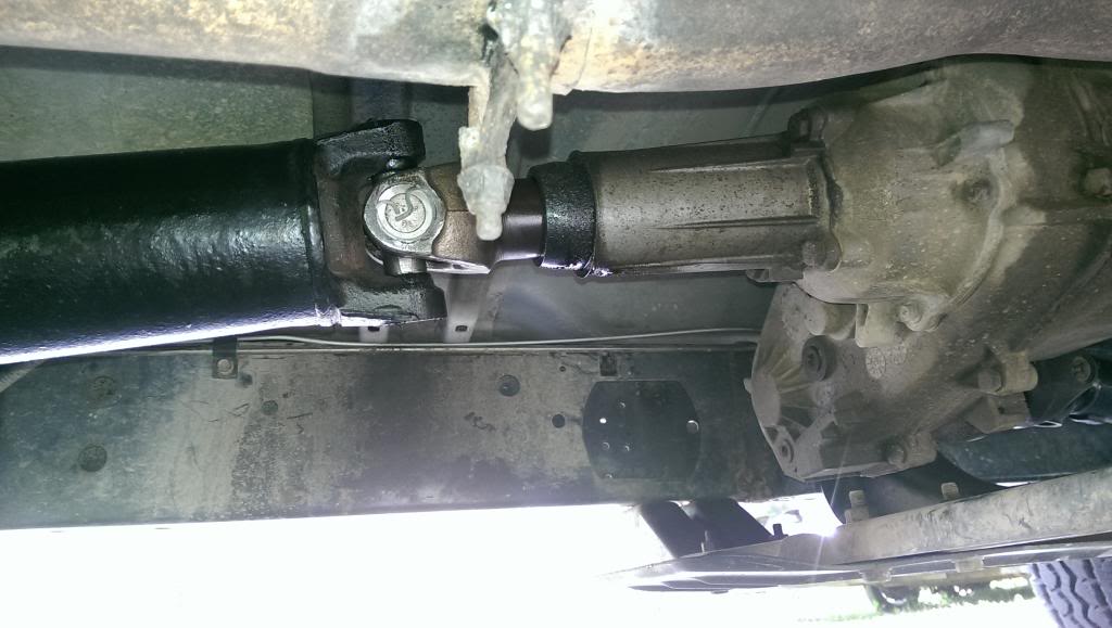

Are you talking about the rear drive shaft angle at the axle? I went out and took some pictures of stuff. I think my pinion angle Is fine. I didn't mess with the perches. I kept the 3in springs and went to the bigger hangars. Front hangars matched perfect but rear i had to drill New holes.
Let me know if anyone wants other angles or whatever. I guess I should go take some of the front at the t case.

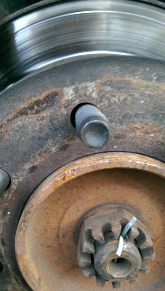

Also. Is this much gap In the rotors normal? Sometimes when I hit the brakes I hear a pop or somethin tightening up. I have new front rotors and pads on the way.

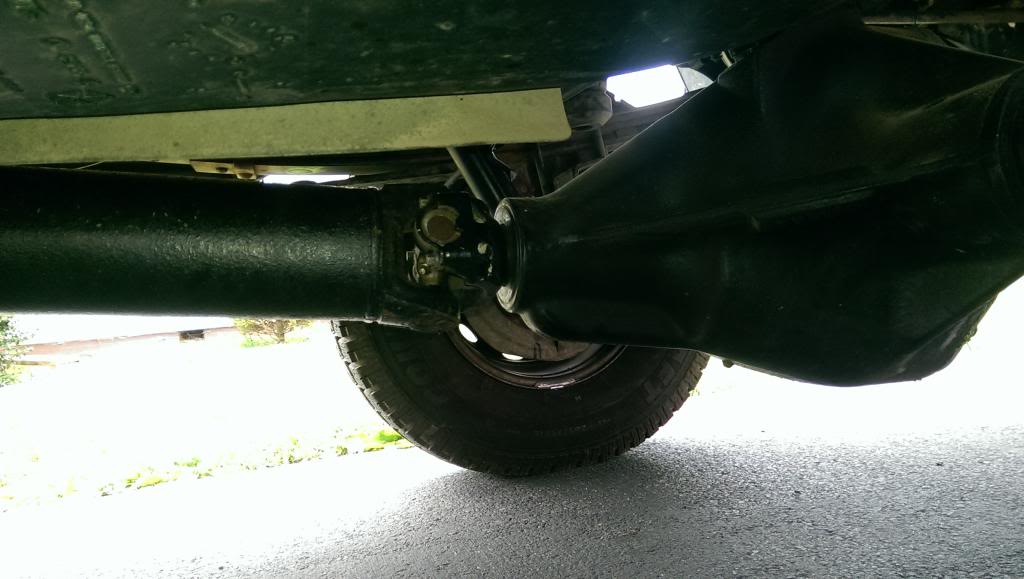

More pics

Old May 27, 2014 | 03:17 PM
  #47
Posts: 87,566
Likes: 4,232
Yeah, they don't need to be real tight on there. They get clamped between the hub, and wheel, when you tighten the lug nuts in any event.
I like the rear disk brake..... I am suitably jealous.
Ok just making sure. And you should be jealous truck stops really well now.

Old May 27, 2014 | 03:46 PM
  #49
Posts: 87,566
Likes: 4,232
Pinion angles look fine.
Does the noise change if you change direction of travel? (I know, at 70, making hard enough moves to load/unload one side or the other can be .... erm.... exciting... at least. )
Well it did get worse changing to the right lane. And no different to the left. Buts that's about I t. Wheel bearings checked out when I inspected them. But that doesn't really mean a lot.
