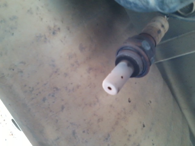

Originally Posted by dman12323
Ok ill have a shop do a pressure test, this is what my o2 sensor looks like. Also after I took out the sensor my rpms lowered back to 1.5k before shifting
Mine usually shifts around 1800 to 2000 rpm's, normal driving. That can vary a bit, depending on TV cable adjustment, and of course low fluid level, or a whacked out torque converter.
