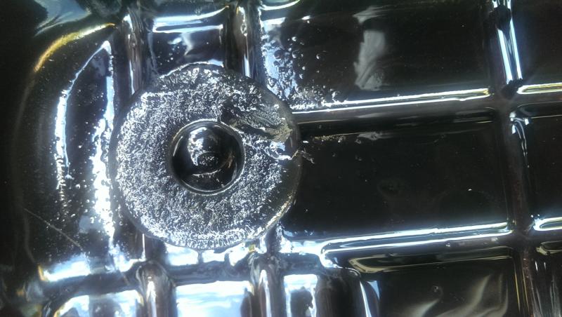

well, bad news. I finally had the time to drop the pan and check things out. there wasnt an anchor in the pan, just lots of metal shavings
heres a pic:
how much is the reverse band anchor supposed to move? i was moving it and it think it moves about a quarter inch, while i saw a vid where they said its only supposed to move an eighth.. ill adjust it and see if i get lucky. but im seeing a lot of shavings in there, which means it might be the clutch? what do you guys think?

Old Oct 4, 2014 | 03:11 PM
Posts: 87,453
Likes: 4,218
I think your pic isn't working.

Old Oct 4, 2014 | 09:19 PM
Posts: 87,453
Likes: 4,218
Still low on fluid. The amount it takes is quite variable on these...... what you are seeing on the stick is the stuff that hasn't flowed down the tube yet....... yeah, it's a pain in the ***. Leave it sit for a while, start it up, run it thru the gears, (don't actually have to move the truck) and check it again. Add as necessary. I think most folks put in at least five, maybe six quarts to get it to where it should be.
I have seen worse stuff on the magnet, and the trans still lasted a while.... but, it probably wouldn't hurt to start saving up for a replacement....
