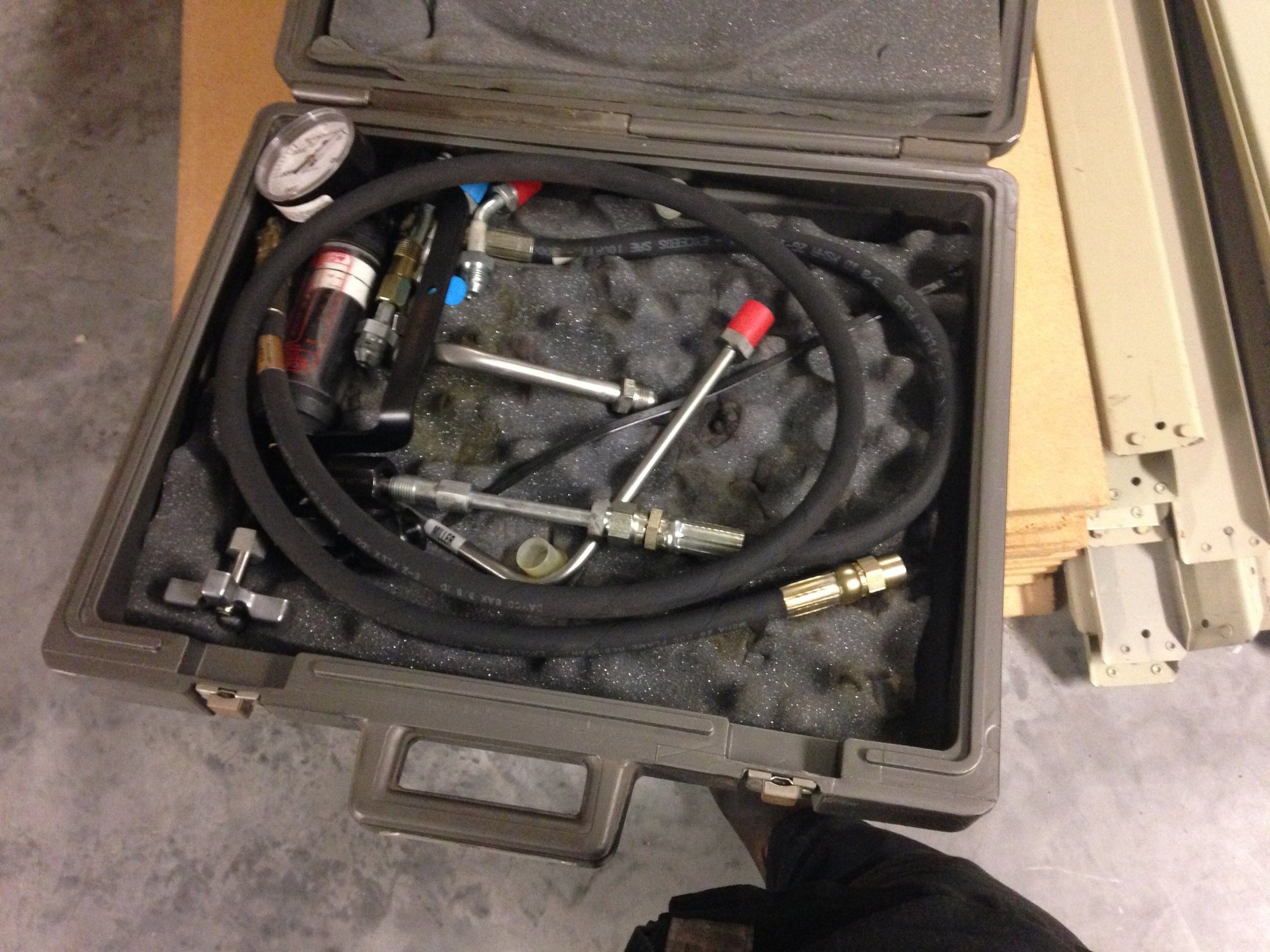

AND THE RESULTS HAVE COME IN! I flow at 2.0 gpm at idle, about 40psi. When I attempt to steer, the gpm drops to absolute 0, and psi goes through the roof! Off the gauge it was so high. When you rev (and don't steer) I could only get the gpm to about 2.5 and no higher.

What did pressure do off idle?

What do you mean? It sat about 40psi.

Try and turn, while holding the engine at about 1000 RPM, what does pressure do?

Goes to about 60 psi.

So I wonder what's up with off-the-scale pressure at idle. What's different???
That's just strange.
