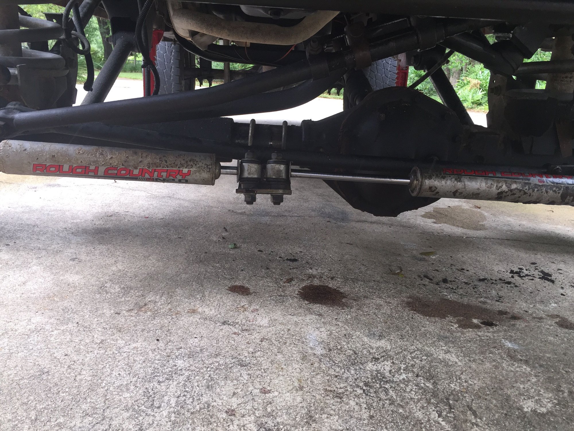

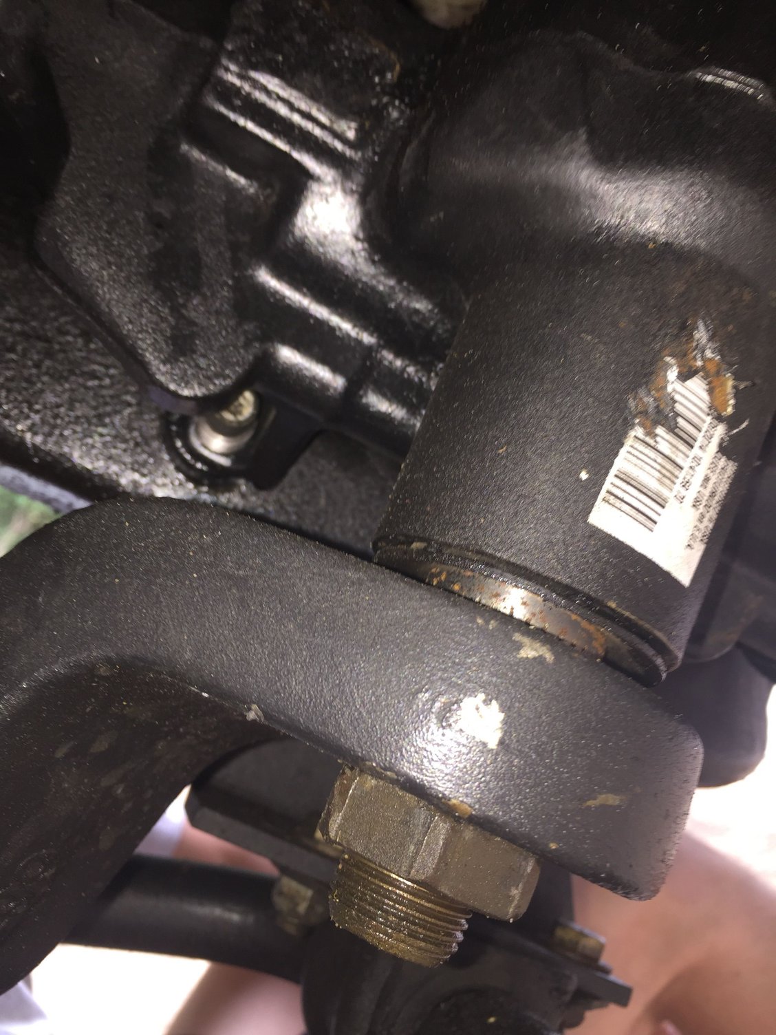

Could we get a pic of your front suspension/steering gear?

Old Apr 5, 2015 | 02:33 PM
  #85
kgilhooley31's Avatar
kgilhooley31
Joined: Aug 2013
Posts: 154
From: Deland, Fl
If those aren't good enough I can take some different ones, I got the wheels off right now playing with it and it's smooth as butter with nothing on it. There's some bends in the tie rod ends but I'm pretty sure those are there cause of how they're cast. Those pics show steering stabilizer back on but I had it completly taken off a minute ago. No effect ether way so I bolted it back up.

Might be able to now.... I don't really know. Photobucket will certainly let you though.
I don't see anything out of sorts with your steering geometry there. Everything looks pretty much new. (and not even dirty? How, pray tell, did THAT happen?? )
I think playin' with the valve shims is gonna be the hot ticket.
