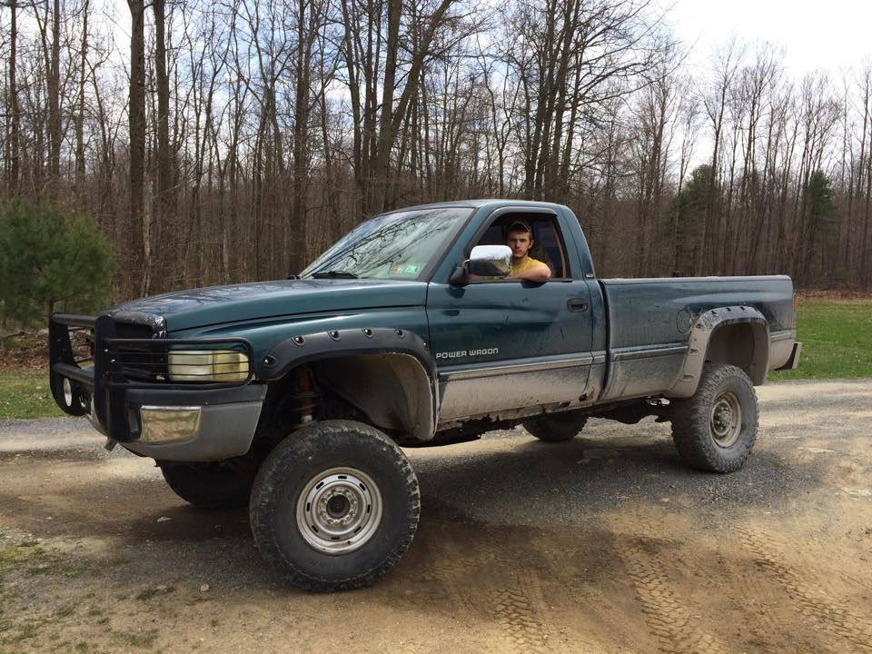

  #47
PAwrestling#1's Avatar
PAwrestling#1
Joined: Sep 2013
Posts: 197
From: PA
This is her.. Before her make over.

I'd work on that rust as well. No since having a really nice engine and the truck falls apart around it...lol...Thats a beasty looking rig though.

RIght in front of it is a spot free southern bed and have the outer rockers. Need to get 2 doors,cab corners, inner rockers, and 2 fenders. By July hopefully it should be painted frame up. Then motor and tranny to follow which might be a winter project.
