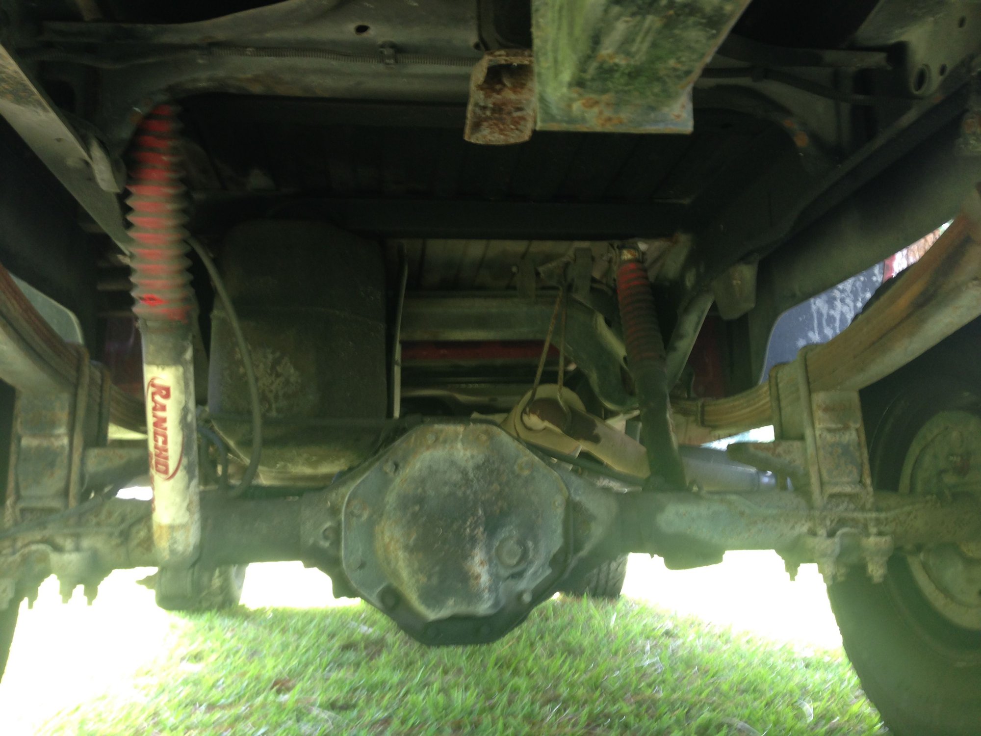

rear axle and what i was told is a 6 inch lift. its a stiff ride and needs shocks though

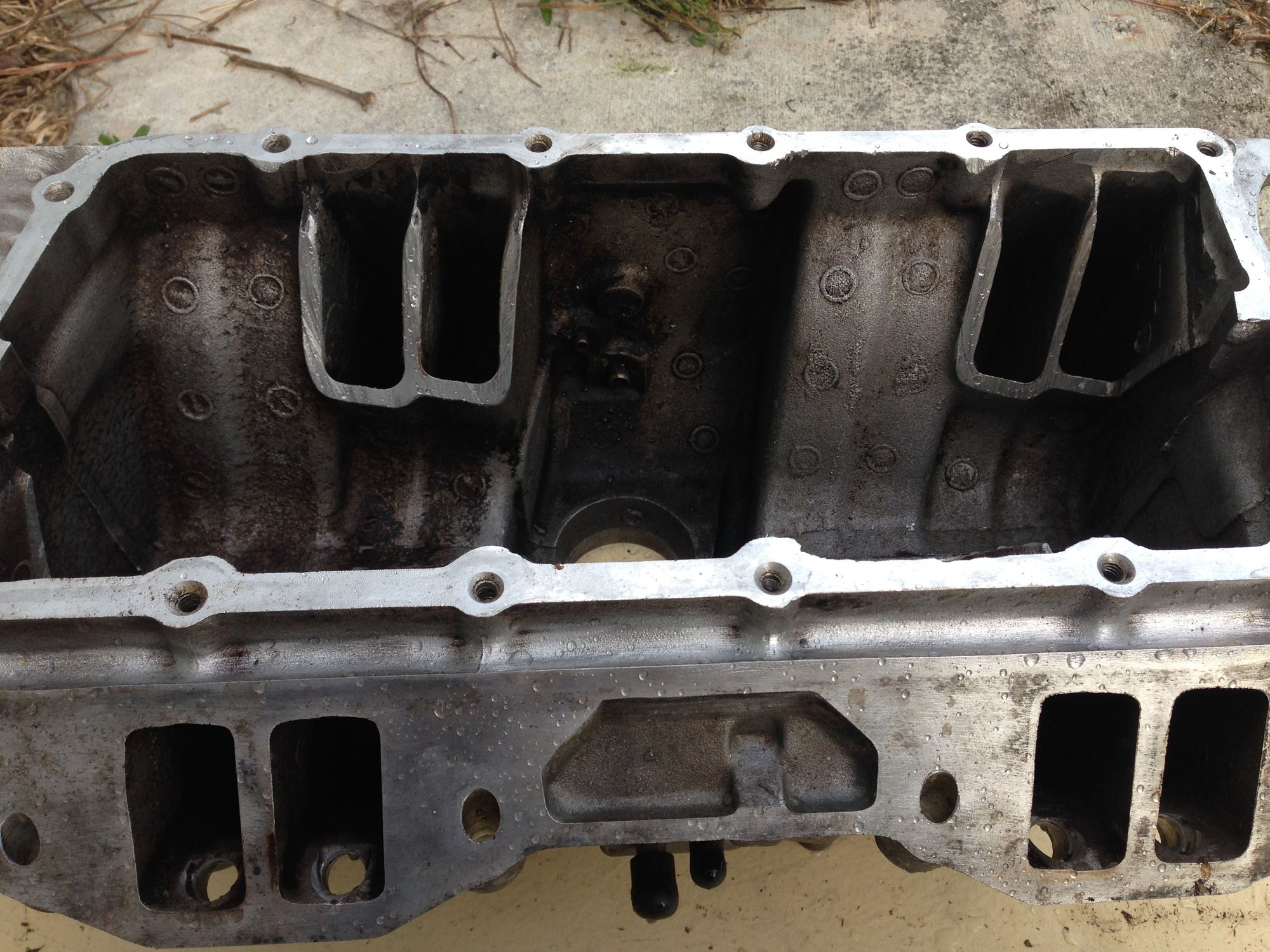

soon to go in after parts are order. going from 96 intake with center plane to an 01 intake.

i guess something i should have looked into. anyone know the tap thread for the second temp gauge for the water sensor? or can i just run without the gauge sensor and screw the pcm sensor in the hole?

I believe it's 1/4-18 NPT. I did the same thing on a 99' intake.

Those are 2" blocks in the back. The lower block with the 'arm' hanging out of it is stock. Those are the bump-stops.
What's the front look like? (suspension.)

I'll have to take a picture tomorrow. I think it's got added leafs.

And larger springs in the front.

Does look that way.... I think stock was only three or four....

That would explain the rough ride... I want to swap for lifted leafs but don't know what to buy as I haven't done anything with suspension before. And don't know if I would have to mod anything
