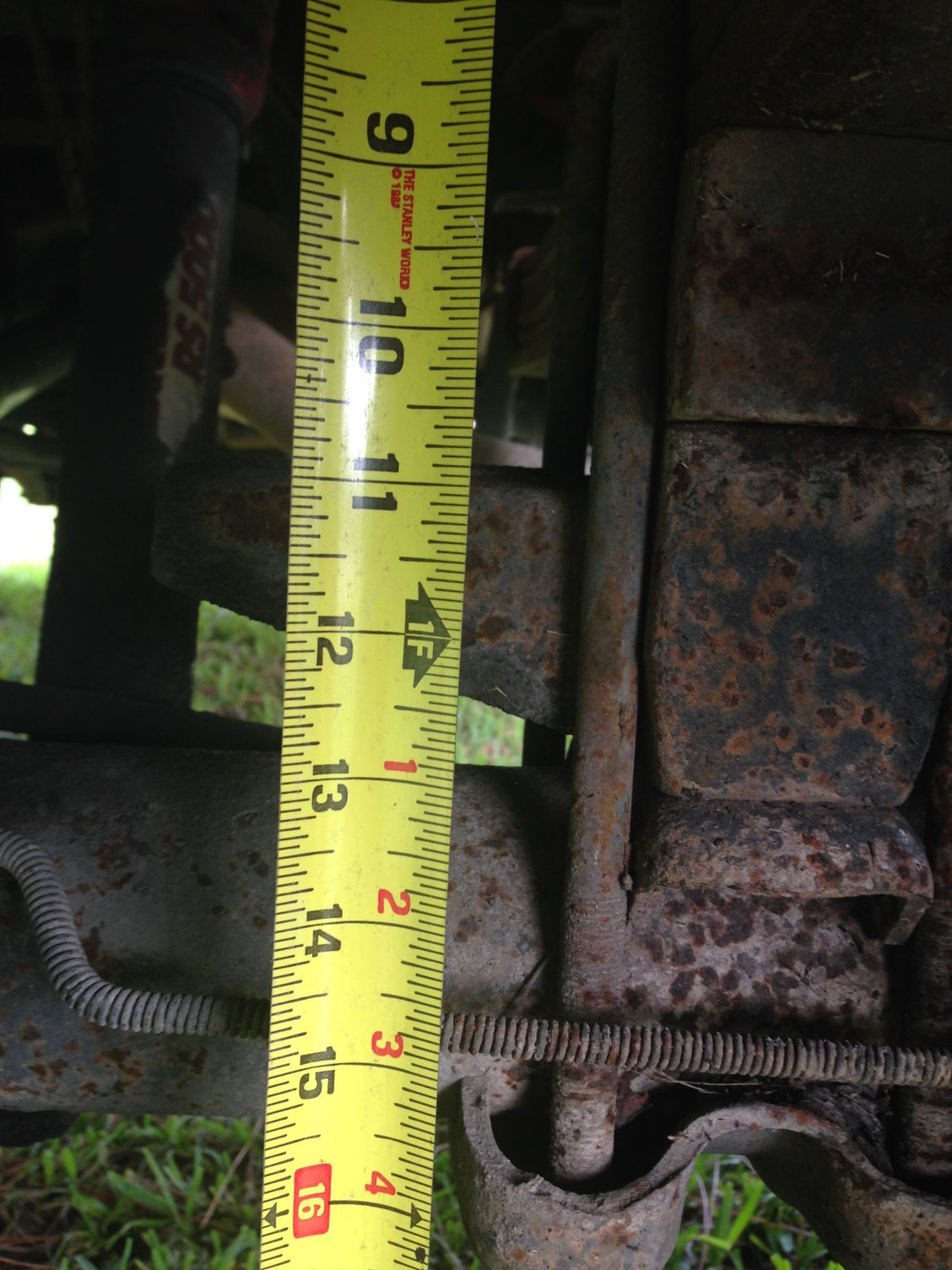

Think the trick would be to measure it out, ground to lip of wheel well, (front and rear) and compare it to a stock truck. See what it comes out as.
The bottom spring in your leaf pack is an overload spring, it really shouldn't do much until you have a pretty good load in the bed. (at which point, it might actually ride better......)

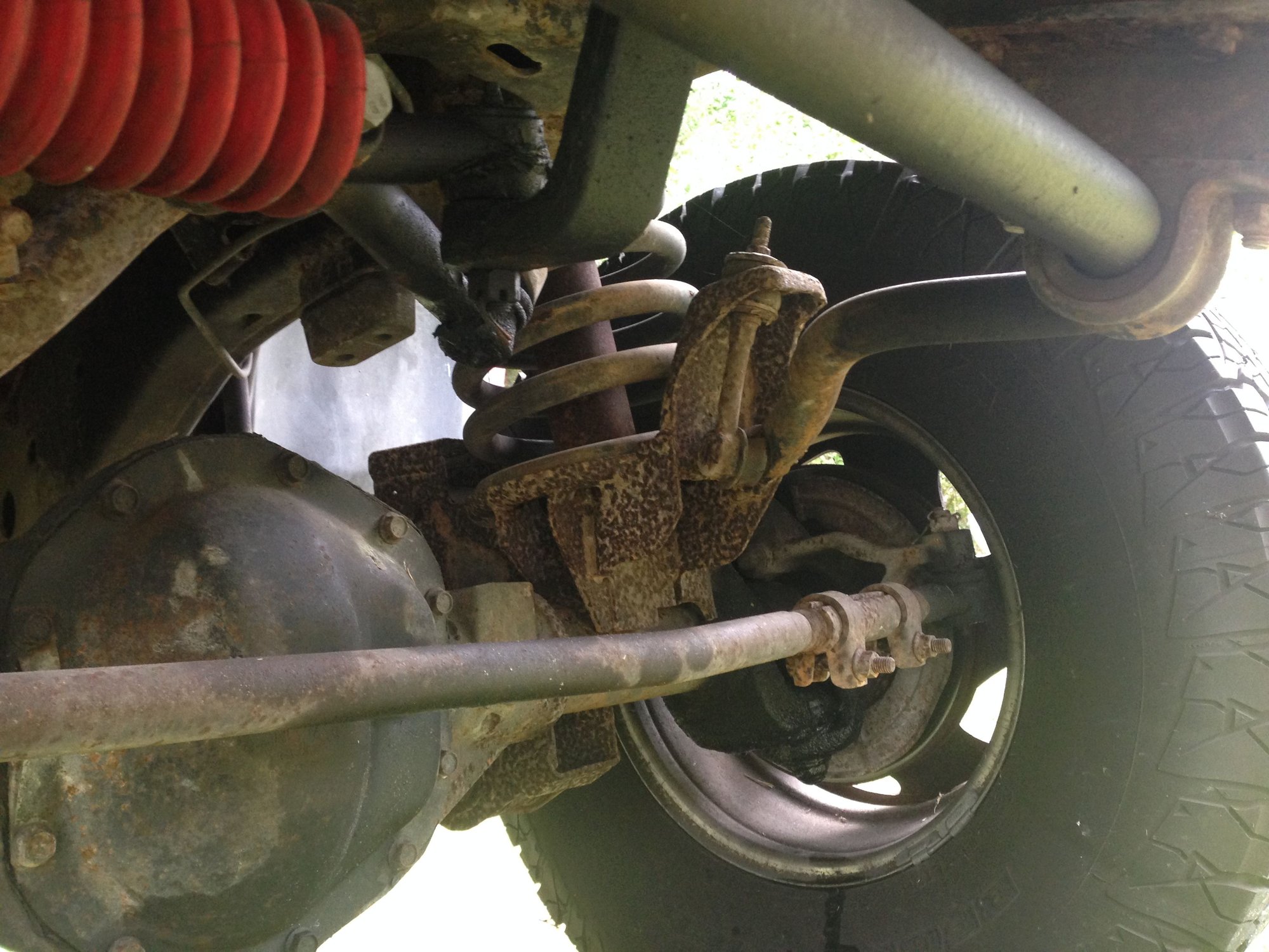

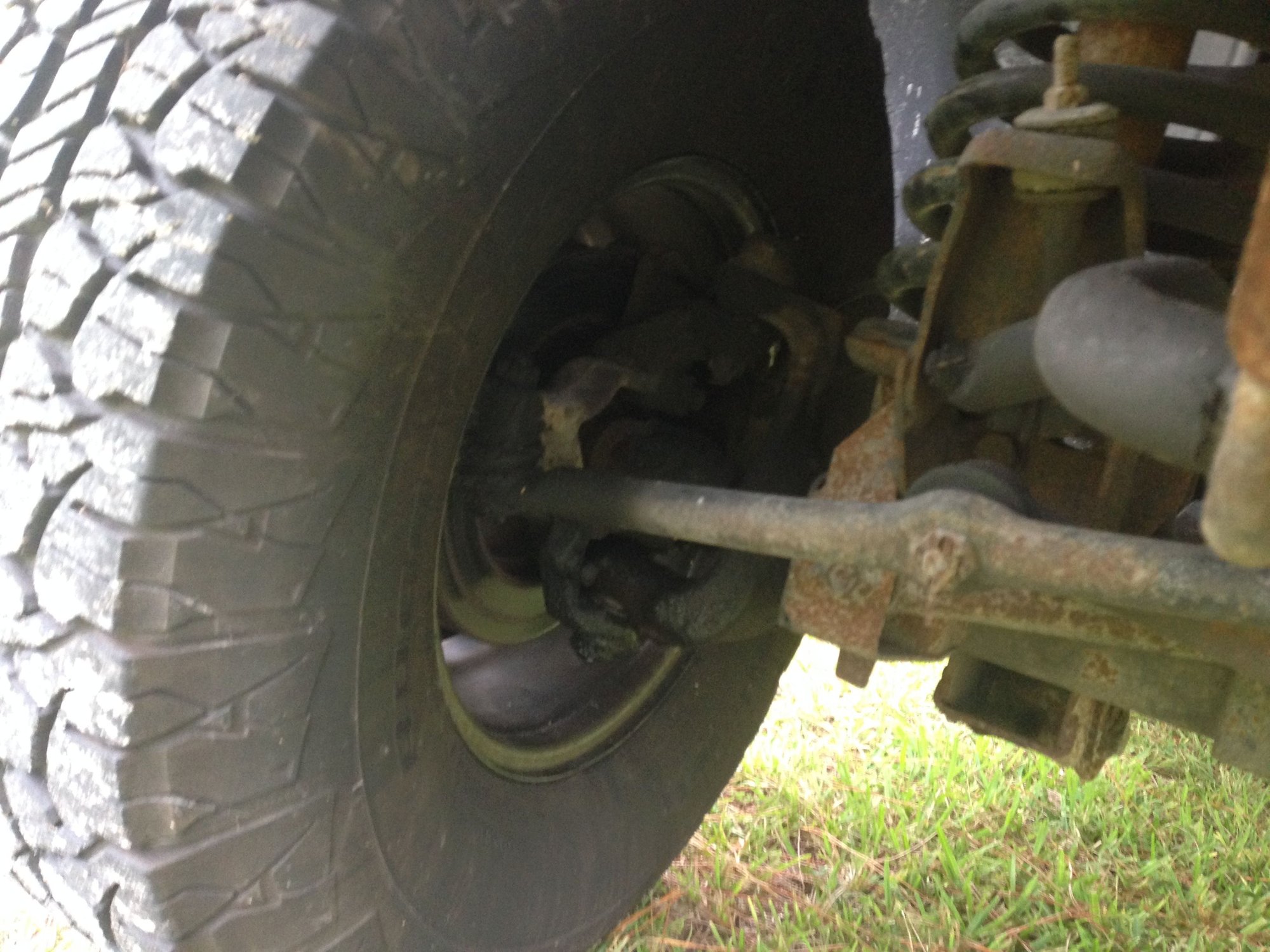

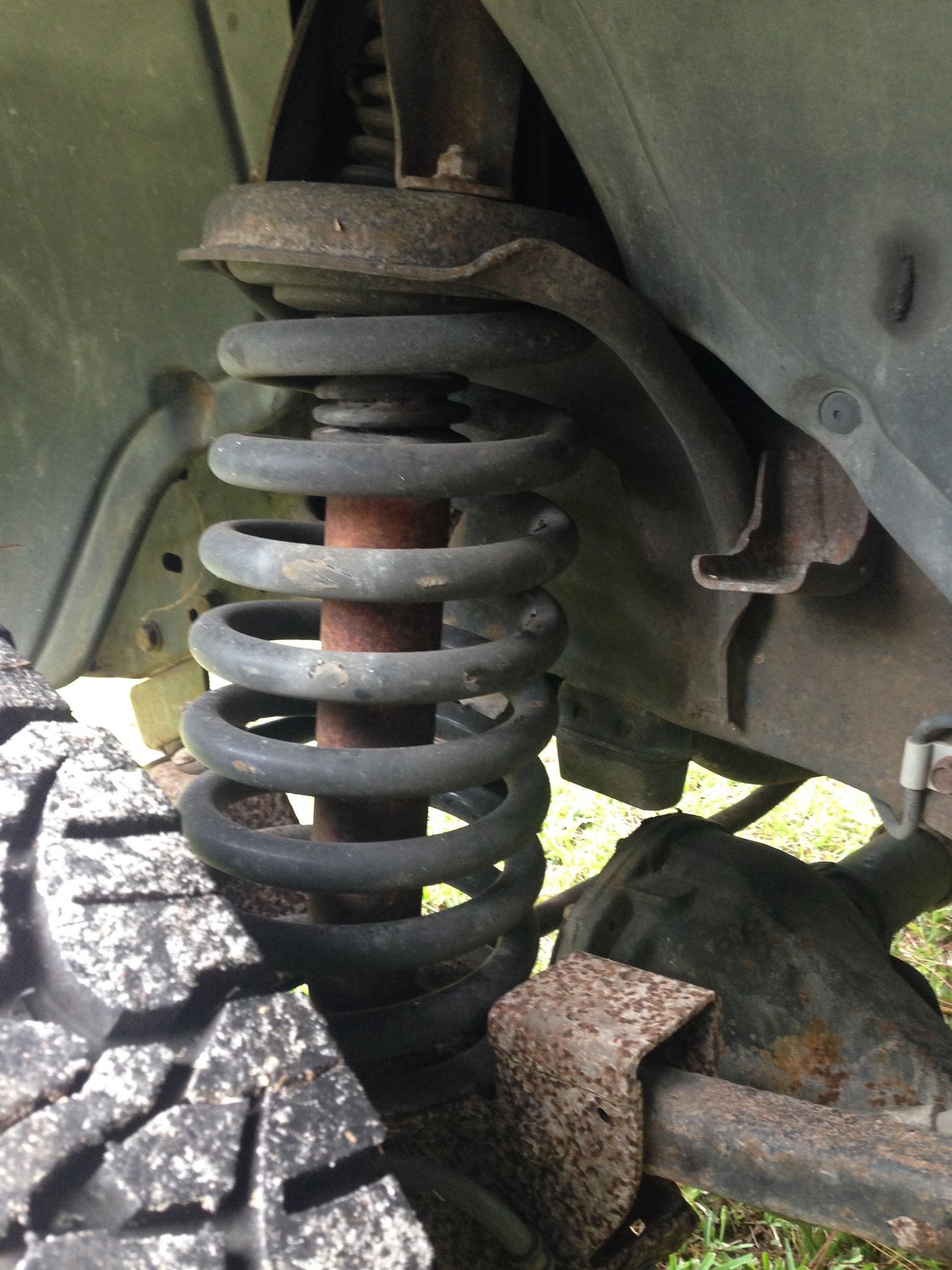

anyone know whats up with this?
Old Jul 5, 2015 | 11:03 AM
Posts: 87,403
Likes: 4,214
Might be aftermarket springs... no spacers, or anything, apparently.... Shocks look original. as do the control arms and such. So probably not more than 3" lift.....

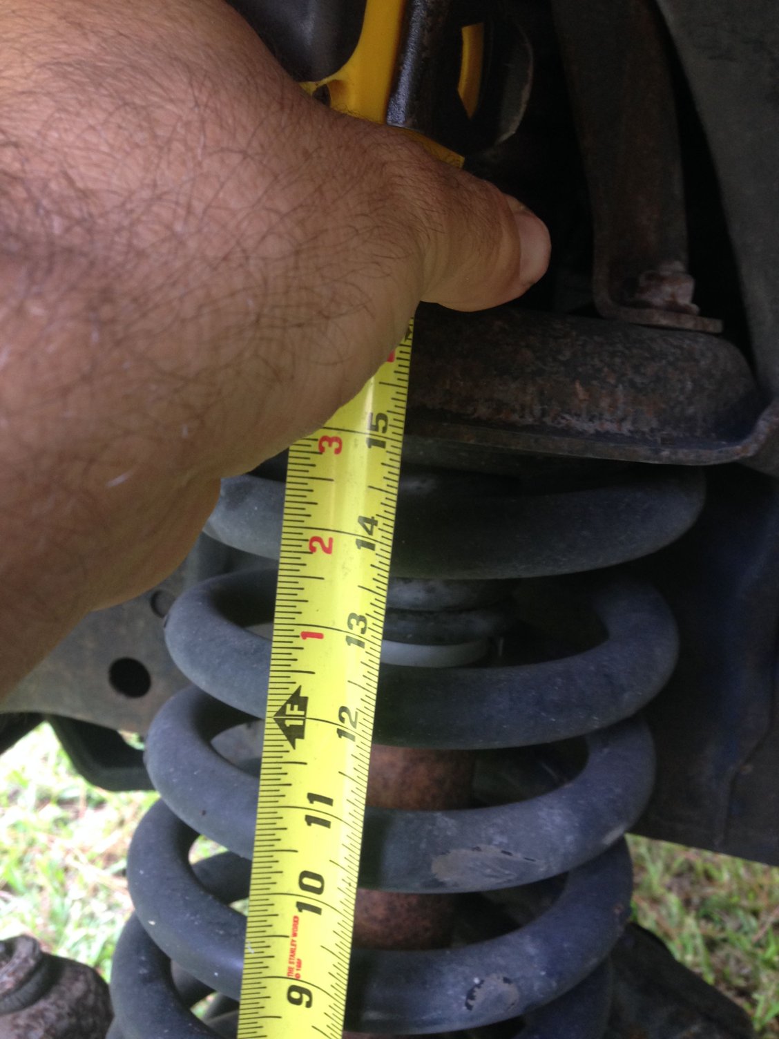

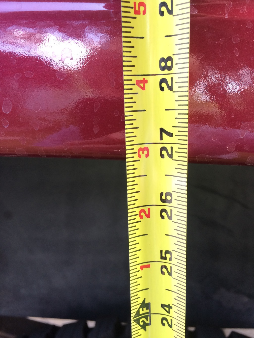

Anyone have stock measurements that I can compare to? I have 285/75/r16 on the truck. Aka 33's as well

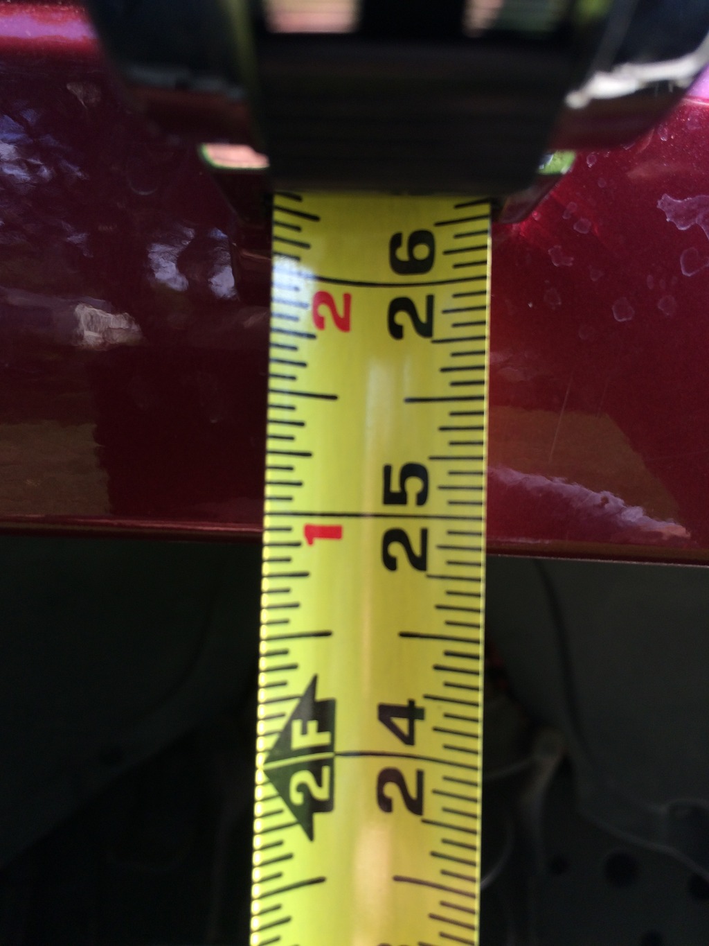

Here's mine measured center of wheel to fender. I have V8 2500 coils on the front and a short length add a leaf in the rear. I would estimate I have 2" lift. And here's what my leaf pack looks like.
Front
Rear

I will have to measure cl to fender but another website says stock springs are 11.5 lip to lip and mine is 15 so 3.5 front I'm assuming
