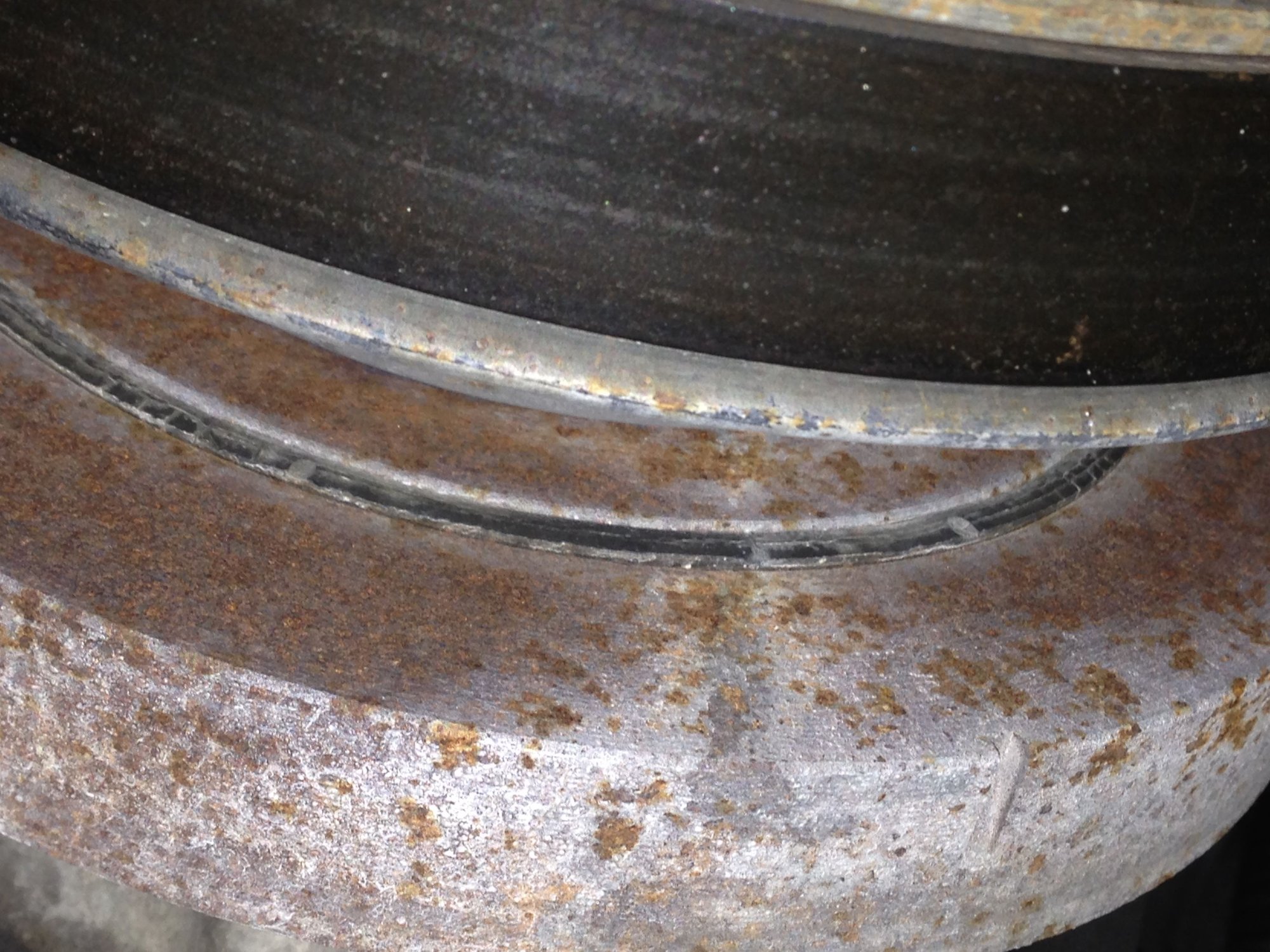

Don't think a steering wheel puller will work.... but, you can try it......
If the rubber ring is squirting out around the outer ring of the balancer, replace it, otherwise, it's probably fine.

if anyone can help im trying to figure out axle ratios. im curious if they have been changed. i was told no though. also built in michigan how does my balancer look? has a few spots around that almost feel like they protrude a little more than the rest of it but otherwise nothing felt funny on it? anyone know whether the lightweight pulley is worth its money?
these numbers mean anything? front axle looks like it says 3.54 on this tg?
harmonic ballancer rear
harmonic balancer front
