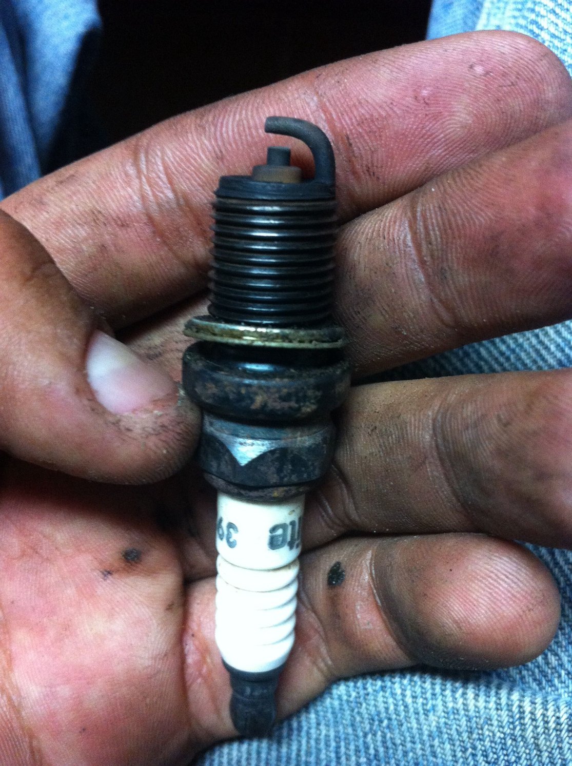

Definitely need to replace cap and rotor.
Plugs look a little dark.... has your plenum been addressed?

No I changed cap ,rotor , sparks ,wires and now it's starts up and whole truck shakes while in idle then stalls and that code 37 is the only code showing up
